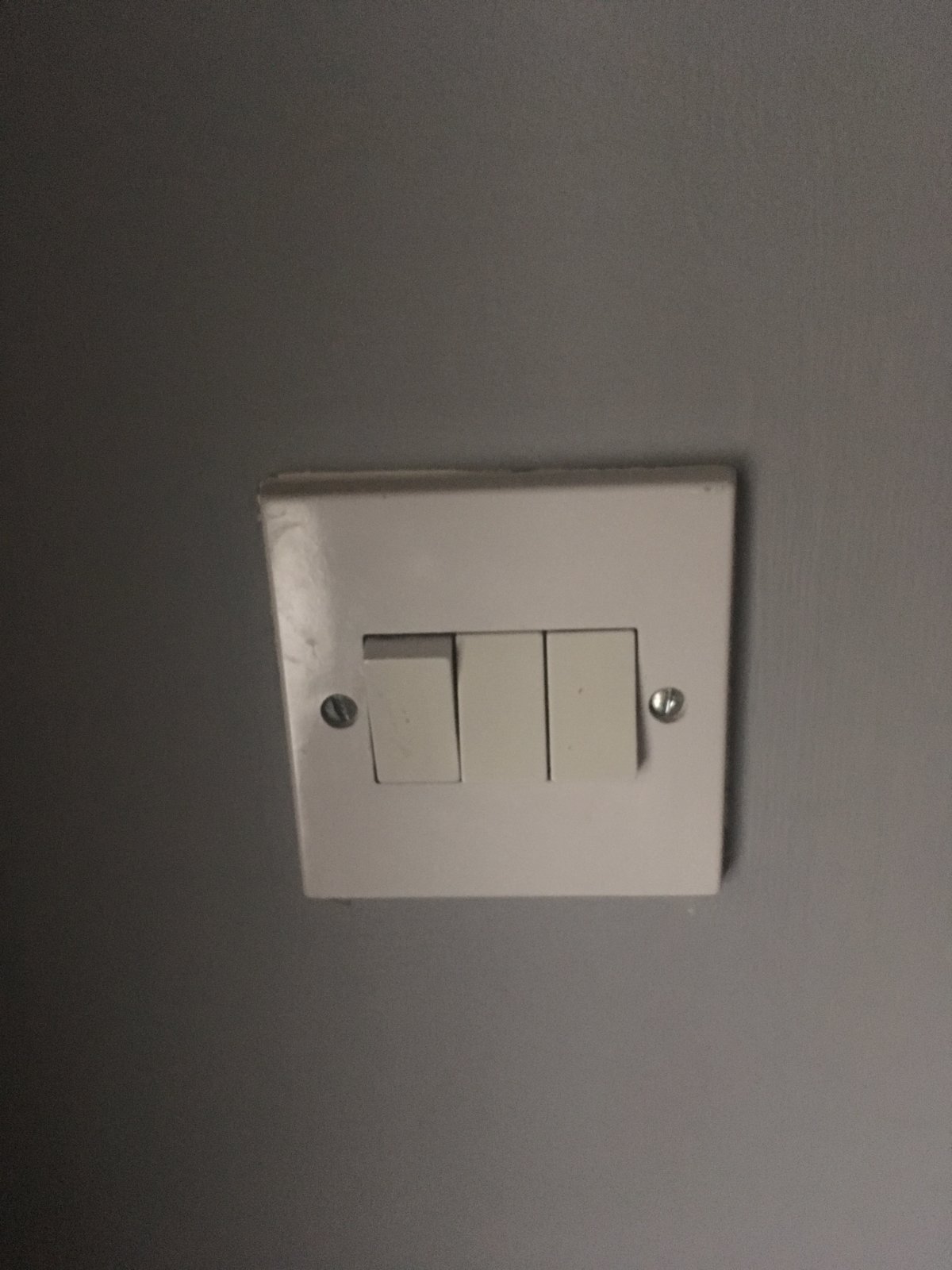

We have redecorated and want to replace some light switches
The switch is a 3 gang switch
- left controls the outside light
-middle controls downstairs toilet
-left controls the hall light
The hall light is also controlled by a switch which is 2metres away.
The switch 2m away only works when the right hand switch on the 3 gang is switched on
We want to replace the 3 gang switch with a 2 gang switch (which would operate the outside light and toilet) and so the switch 2m away would be the only switch for the hall light (this is wired 2 way just now)

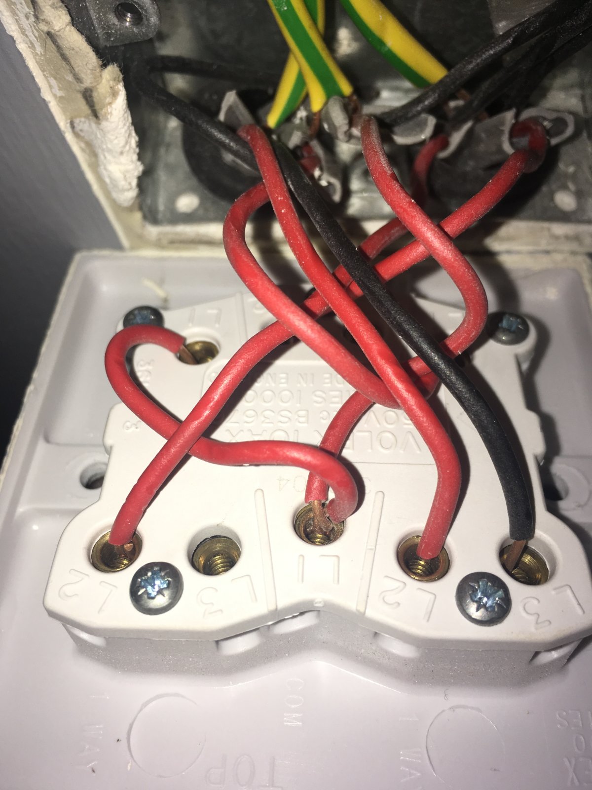

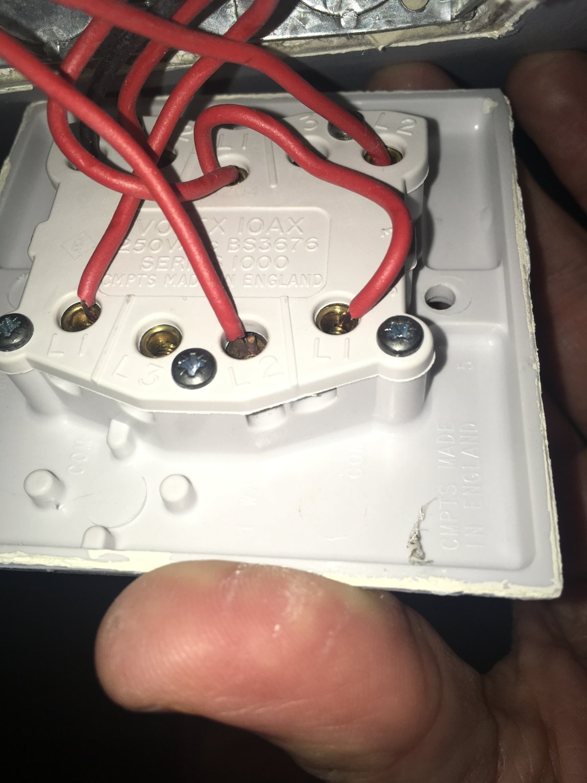

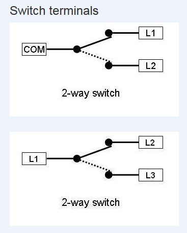

But the old switch is wired as you can see below with L1 L2 L3 labels but the new switch is labelled Com/1way/2way
Can anyone advise what I should do?
Cheers
top view of old switch
Bottom view of old switch
new switch
What wired should I not connect, from the 3 gang switch to 2 gang. (And can I just insulate with tape and leave disconnected?)
What does the wiring look like in the hall switch you are keeping?

It’s a new switch with common 1way 2way connections.
Currently wired to the 2way.
The one(s) which are in the gang which currently never does anything.
If you do not have a gang which never does anything then obviously removing and leaving unconnected the wires from it will not leave you with a system which works in the same way it does now.
Insulating with tape is a no-no, firstly tape doesn't insulate properly, and secondly it falls off. The safe way to deal with ends of wires not connected to terminals is to put a piece of choc-block on the end.
As for leaving disconnected, then as above - if you do that then you will not end up with switches that work properly. You cannot simply disconnect the wires from one of a pair of 2-way switches and expect the remaining one to work as a 1-way one.
Basically you're going to have to choose between Plan A and Plan B.
