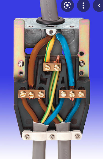

My last question is how do I wire these up, as mentioned I have two double ovens and a induction hob, now I know they do a 45a dual appliance outlet plate, but how do I apply three appliance to this. I presume I wire two in series and have the supply going to the first plate with one appliance from there and use the second appliance space to connect to the second dual appliance outlet plate of which I run the other two appliances from, is that correct.
Just put two in one side - OR
install two outlets.
No, not series - Parallel.
Not sure I follow that.
It shouldn't really be Twin&Earth on the outlet side.
So I could use one 45a dual appliance outlet send one of the cables to a dual box and plug the ovens to each of those sockets (basically a double socket I presume) and then send the other cable to the induction hob or a single socket for the hob. I also presume 6mm cable for the hob but is 4mm sufficient for the two ovens.
Yes.
No, You cannot use plugs on ovens and hobs of the ratings you have given.
You would have to use another dual outlet plate but there isn't much point.
Just connect all three to the one outlet.
2.5mm² flex for each oven and 4mm² for the hob.
Yes.
Thanks that makes sense. Not all the appliances cables will reach the dual socket
so I guess I replace the appliance cable with my own for example 4mm for the hob to the desired length required to reach the dual appliance outlet.
Dual cooker outlet. It's not a socket.
Yes, or a second outlet near the hob wired from the first.
