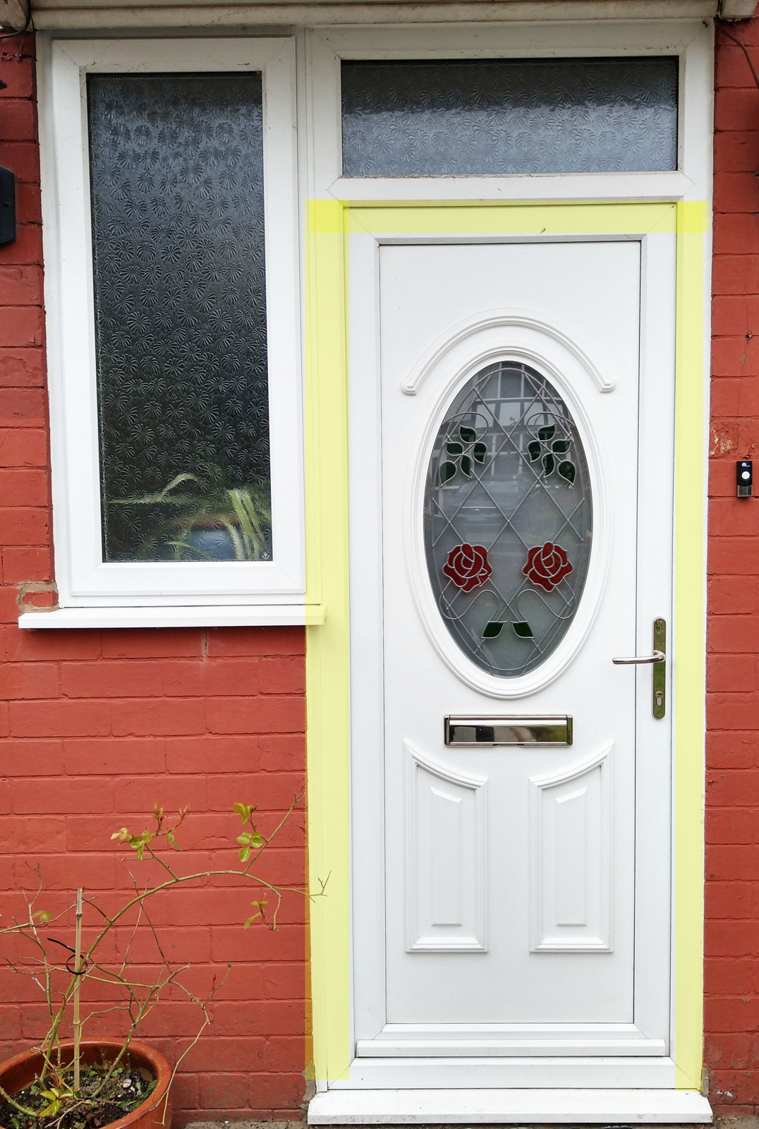

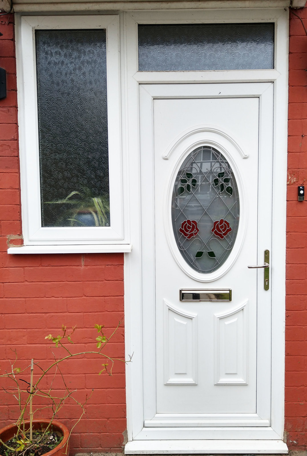

Hi,
I want to replace our PVC front door with a wooden one but keep the PVC windows next to it.
I'd cut the door PVC frame out then fix new wooden door frame (highlighted yellow in pic), obviously keeping all the window frames.
Can’t think of any reason why this shouldn’t be possible but please feel free to tell me why it's a dumb idea!
Cheers
I think it would look gash and different materials behave differently in changing temperatures etc.
Not sure why you wouldn’t opt for a nice composite door or new UPVC Door panel which will be far easier. Looks like you would need to reduce the door height to have a wooden frame below the upper window.

Good point about the different materials behaving differently that is a very real concern
True I will loose 4cm from the height but will gain 4cm from removing the pvc trip hazard at the bottom.

Please be very careful with this idea. Upvc and wood are two totally different profiles. One is 70 ml in thickness the other normally 50ml. So you will be opening up a can of worms trying to butcher the existing set up. If you don’t like plastic change the whole thing you will feel better when you finish, bearing in mind you have to walk through this for the foreseeable future and it is the gateway to your property.

Composite frames and doors are designed to look like wood ,feel like wood but have the security of plastic. There’s a good chance your neighbours have that set up. I don’t know of any company who would advise you to complete you’re original idea.

Ok I think you've talked me into ditching this idea.
