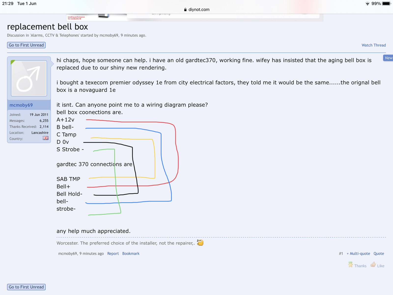

hi chaps, hope someone can help. i have an old gardtec370, working fine. wifey has insisted that the aging bell box is replaced due to our shiny new rendering.
i bought a texecom premier odyssey 1e from city electrical factors, they told me it would be the same......the orignal bell box is a novaguard 1e
it isnt. Can anyone point me to a wiring diagram please?
bell box coonections are.
A+12v
B bell-
C Tamp
D 0v
S Strobe -
gardtec 370 connections are
SAB TMP
Bell+
Bell Hold-
bell-
strobe-
any help much appreciated.
Just got round to having a go. Wired exactly as shown but I've got a bell tamper fault.
Found one of the bell box tamper wires clamped on insulation. Thought it was that, but no. Still got a tamper fault.
Any suggestions please?
Tia
Some Muppet (moi)got a couple of wires wrong in the bell box.
I've started needing reading glasses. Climbed up the scaffolding without them. Thought I could see what I was doing. Obviously not!
All good and working fine. Thanks for the replies. Much appreciated.
