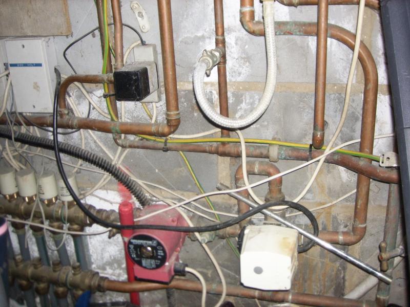

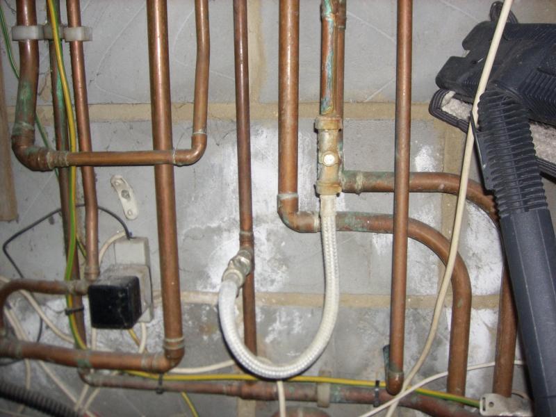

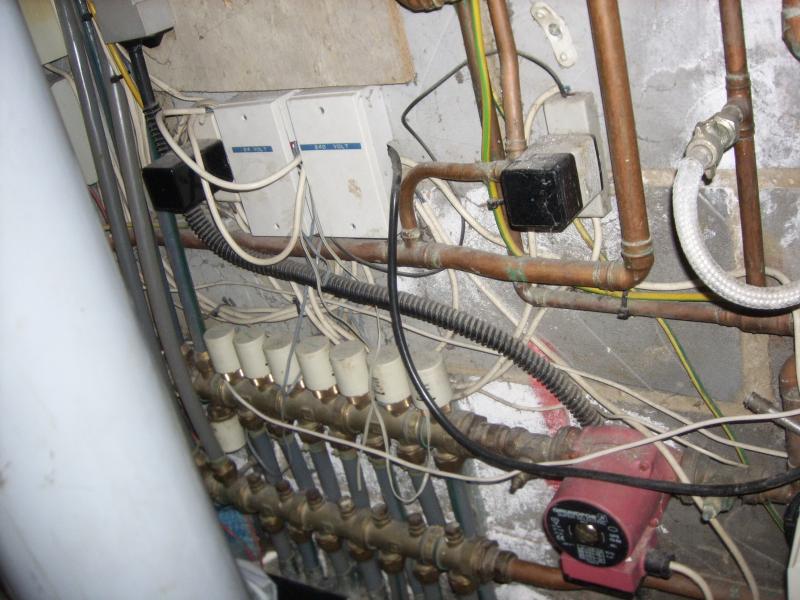

Doesn't seem to be a blending pump. I've asked the customer to take some photos, I'll post them up as soon as I get them.

I think I'd run a mile looking at the state of that pipework and wiring. If something goes wrong you'ld struggle like hell to work out what's going on.
