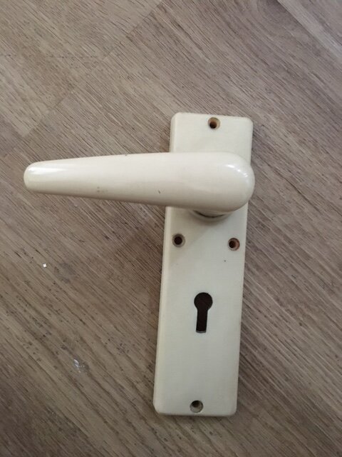

Hello,
the forend part of the lock measures only 100mm and seems to sit deeper - the standard lever locks I can find measure 150mm so a bit taller but they also seem less deep.

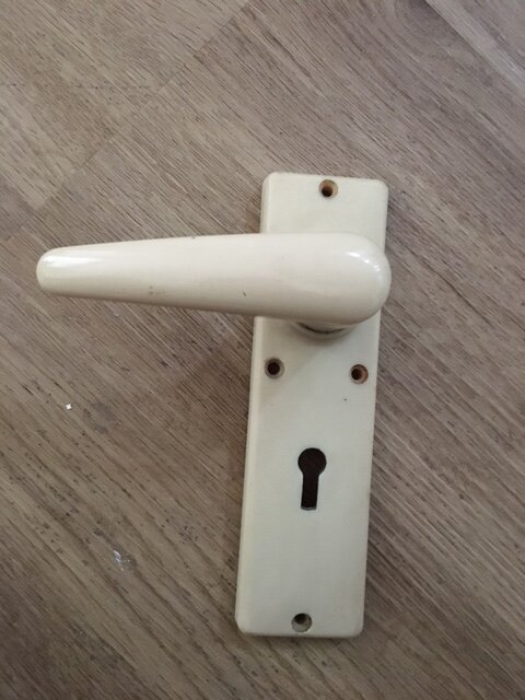

I’ve added a picture of the door handle which I’m also trying to replace in case this looks familiar to anyone!
thanks

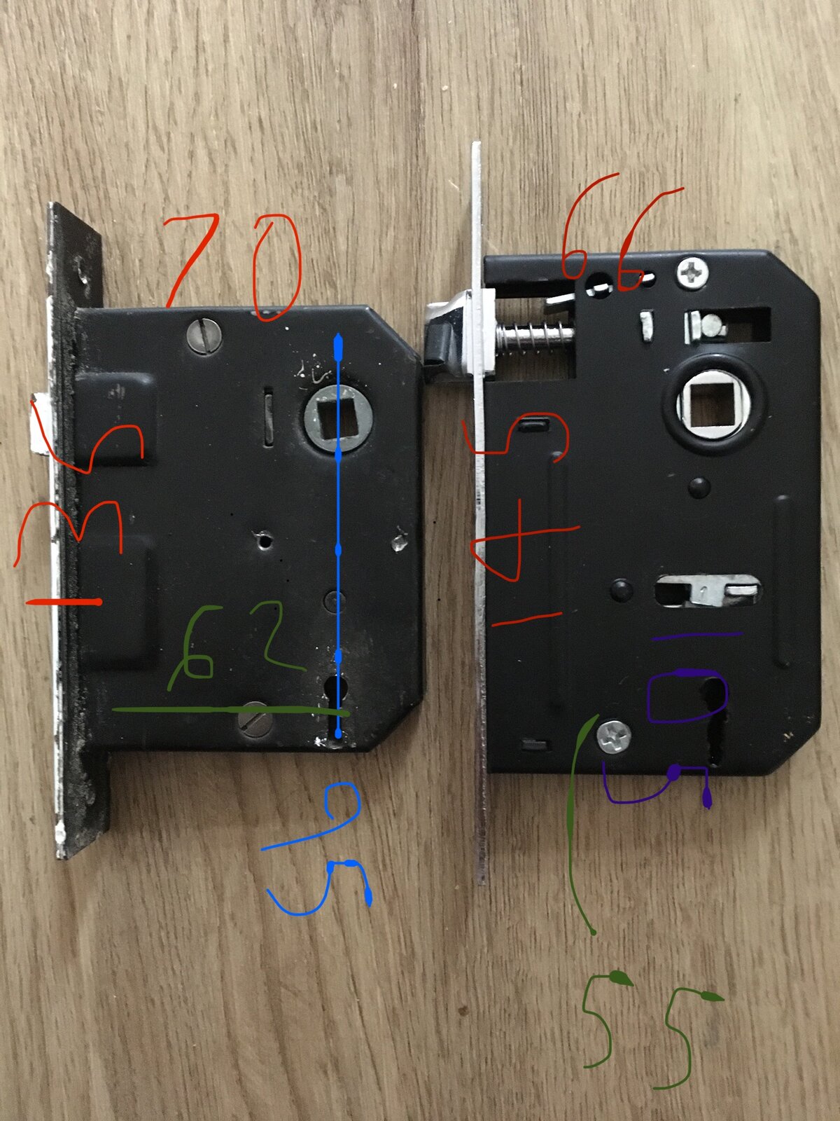

Take out the lock and photograph it please, and show dimensions of the case.
Be sure to tell us the maker's name.

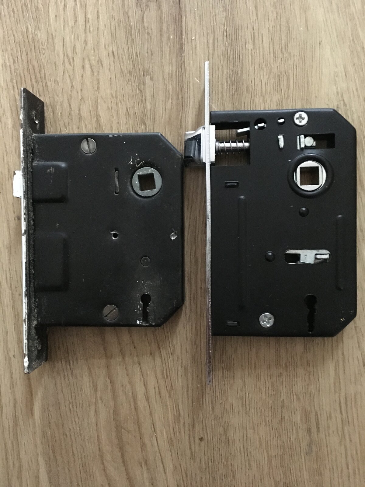

Took the lock out but unfortunately don’t see a brand name on it. Just says 2 lever on the front. I’ve attached a picture showing it next to a standard 3 lever.
I thought the 2 and 3 had the same dimensions but please correct me if that’s not true.

please show dimensions of case
in mm or 1/32" (or both)
Yours is very old so it was probably designed in fractions of an inch.
In my example below you can see some of the metric measurements are surprisingly close to one inch, half inch, one and a quarter inch, three-eighths, and four and a quarter inch. This is not unusual for an old design of British lock.

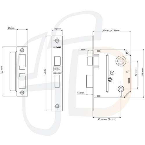

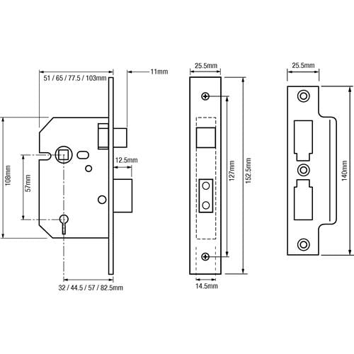

here's an example of the dimensions
Dimensions A, B and C are the most important
and in your case total height of the case as it looks non-standard.

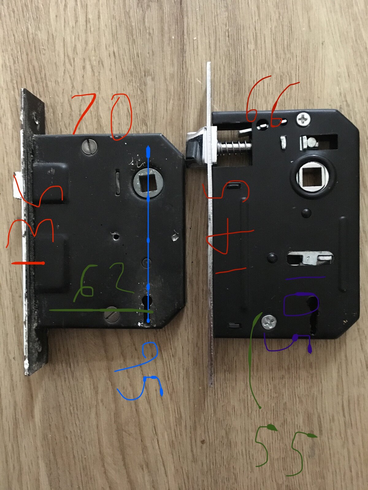

Thanks a lot John, it does seem non standard. Dimensions are:
A - 3 inches
B - 2.5 inches
C - 3.5 inches
also attached a picture with dimensions in mm (it’s the one on the left). Is the easier option just to fill the hole up and redo this? Just worried I might end up creating a much bigger hole to account for the hole...this was in place when I moved into the house and I didn’t get keys for it so unfortunately can’t see the brand name there.

I'd suggest shaving away the top of the mortice so it is big enough for a modern lock case to slide in.
Union are very widely available, and easy to match. There is one with a 58mm backset to centre of keyhole, the extra would hidden by your handle plate, and the case is 101mm tall (the black-cased lock is their cheap range). Part no. ES3SL3B
This grey cased (part no 2277) is better quality but more expensive
Yours is what they called a "three inch" sashlock" because the case is three inches deep; the backset from front edge to centre of keyhole varies by brand but may be around 2 1/2"
yours has a 2 1/2" backset which should be common. but I can't see a modern one with 62mm backset.

The height is 95mm but I’ll do as you suggested and try to squeeze the union one in the space. It’s an internal door (there is a separate backdoor) so I don’t need to get a very secure lock.
will pass on the knowledge in case I find someone else asking the same question. Cheers
Yeah definitely. I’ll only need to make some space on the forrnd side but otherwise this should be a close enough fit. Thanks!
