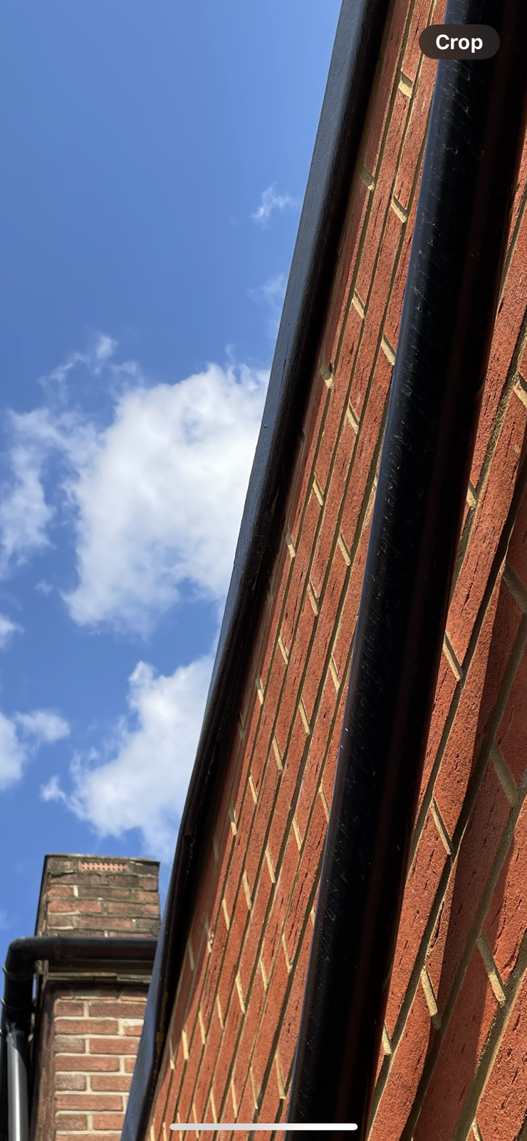

We had a fibreglass roof done in our extension couple of years ago, we since had couple of leaks near the skylights. Those were patched but keep coming back.
We had a recommendation for another fibreglass roofing company to resolve it once for all from a friend, they came in and suggested it was of a poor quality resin and trims. They've sanded the roof, replaced all the trims and put a fibreglass again. It looks pretty good but not a week after I see a trim peeling away from the wall (picture). The company is coming to fix, mentioned its to do with heat and they need to put some "buttons"? Do I need to get yet another company to validate this company?
Highly anxious at this point, if anyone could advise I'd appreciate it..

Could you post better pics than that - stand back & show some context?
Or pic from the same height of the roof - or on the roof?
Also show other side trims, and the repairs to the fibreglass?

Looks like heat distortion.
