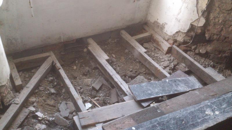

I pulled up a floorboard in the hall to find soil inbetween the joists...obviously not helping airflow. A pulled up floorboard in the lounge showed soild approx 6" below the joist level. There was one airbrick on the front wall, so no decent airflow at all.

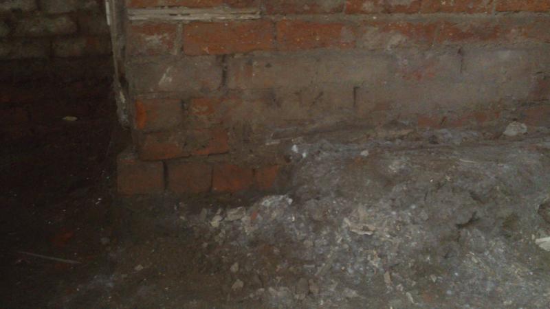

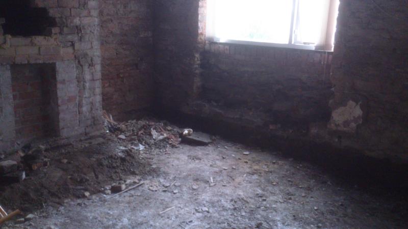

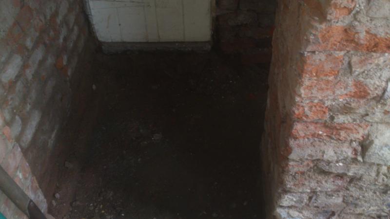

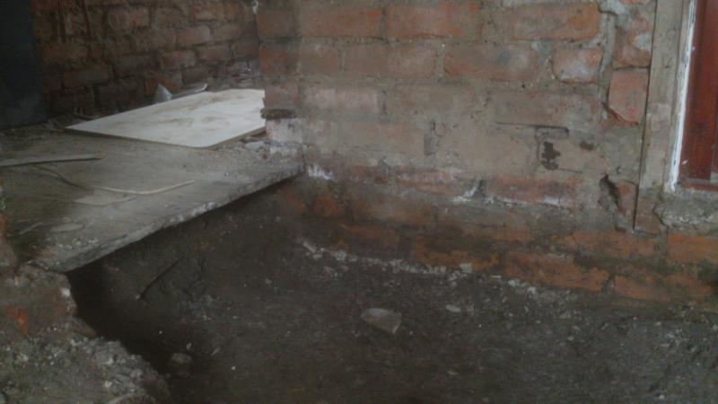

However, this is where I've hit problems I don't know what the best solution is. On digging out the concrete floor I found that the party walls had a depth of around 3 brick courses with the last of these being brick footers However, the (non-load bearing) internal wall dividing the downstairs hall/stairs only has one brick depth plus one brick footing so no decent foundation. I've dug out most of the room, approx 200-250mm but ended up leaving a couple of foot near this wall to not cause problems. I presume the rooms with suspended floor will have a similar problem so won't be able to dig down more either.
So I'm looking for a bit of advice on what to do, I really want to make sure these floors don't have damp and the reason I didn't want to put concrete back down was I thought it would probably push moisture back out up the walls as there isn't a DPC to tie into. I also know that regs state replacing them needs approx 400-450mm for hardcore, blinding, insulation, slab, screed - if I were to replace the concrete with concrete again what do I do due to the low depth possible from the internal walls?
I've had the concrete floor up for a couple of months now and it seems the soil is still quite damp, in fact there is mould growing on it. As far as a I can tell there are no waters pipes or drainage go through these rooms so don't think there is water ingress that way, and for reference the back yard is approx level with the (previous) floor level, and front is slightly lower than floor level. The house is on a slight hill with the neighbour on one side slightly higher.
On another note on pulling up the suspended floor, it definitely needs replacing now, as it was all balanced on bricks with shims and boards to pack out, which all fell awat. Plus the small joists they'd bodged together for the bay window were rotten anyway. Hopefully the pictures of the suspended floor shows up here, I can get a picture of the pulled up concrete floor if needed.
Sorry for the long post, any help appreciated, bit stuck on progress with this one.

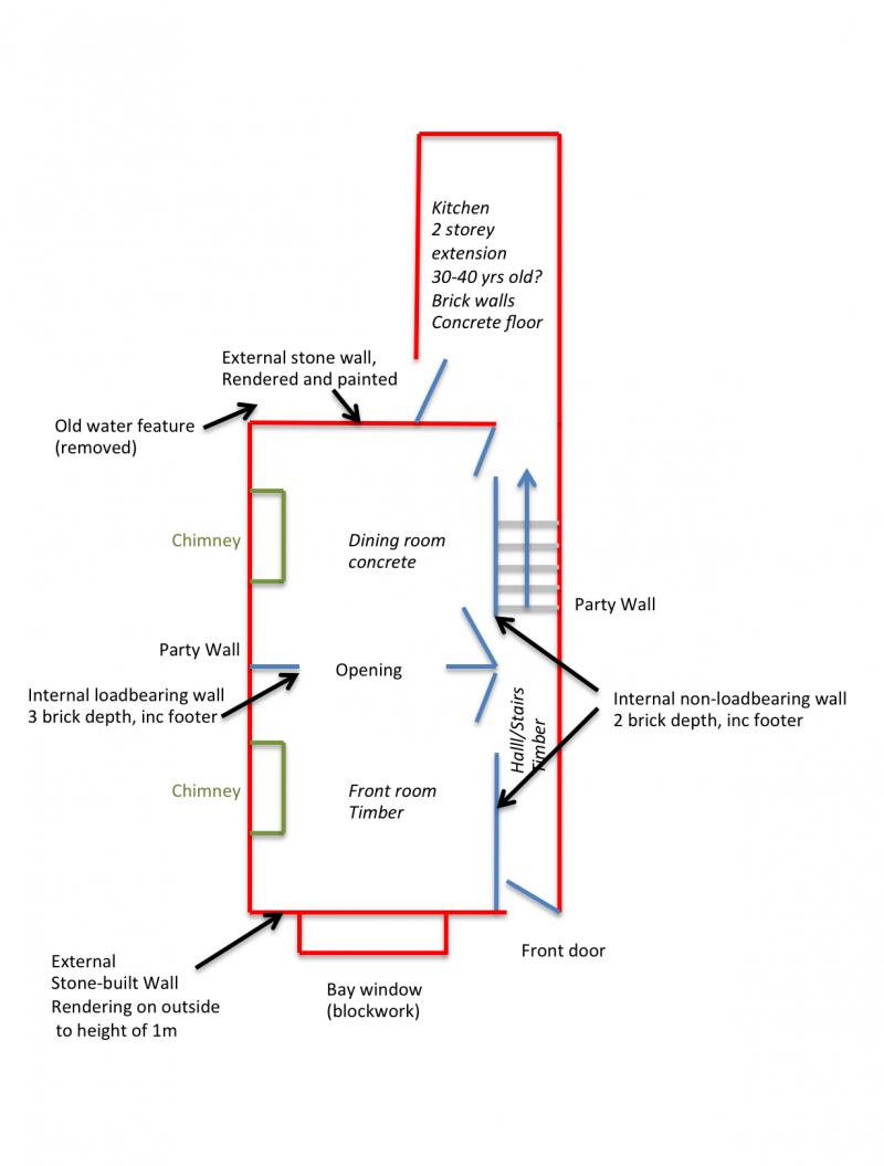

2. Please post a scanned and annotated footprint drawing of the house plan including any chimney breasts.

8. What is that large beam in pic 1?

There was a construction of stone, concrete, and infill/soil built up in the back yard which was at the corner of the rear room (see drawing and a photo where you can see the outline after removal). It had a water pipe to it but it was cut off so no water feeding (an awful gnome with water coming out it's mouth), however would still have been sucking up water when rained.
See picture attached that I've just made, let me know if I can add anything else to it. The chimney breasts are an interesting point, as if I concreted the whole ground floor it would me I don't have the problem of having to build in a hearth. Both chimneys are closed up but I intend to open them both up, at least decoratively in the short term.

It's just the lifted floorboards stacked up in three piles.

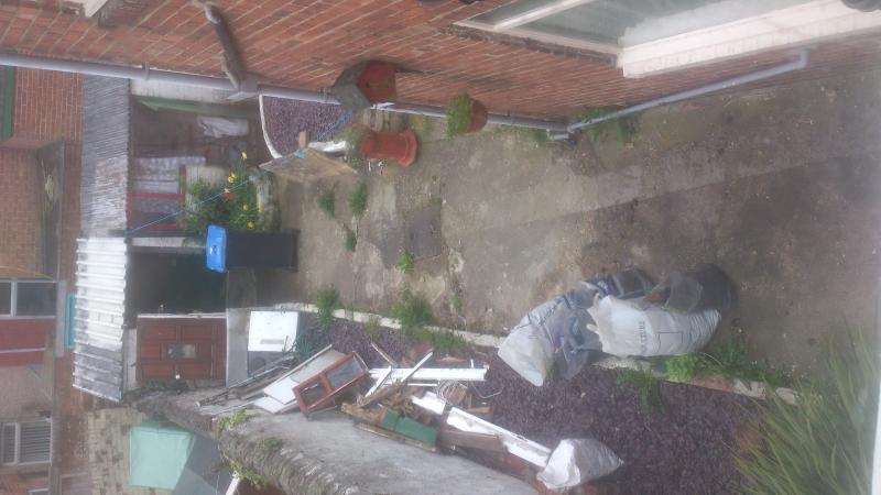

The garden wall in the pic will be a damp bridge to both you and your neighbour - not a lot can be done outside but be alert to damp in that area inside the kitchen.

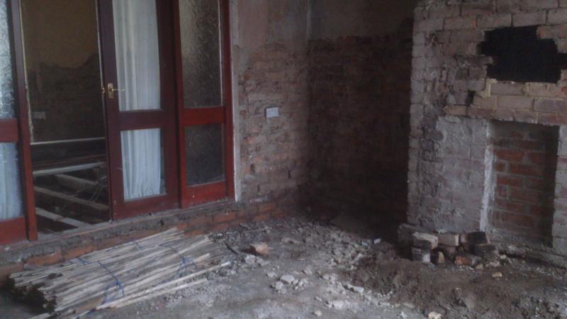

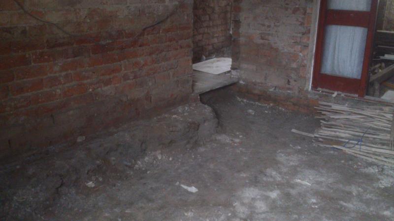

2. I thought that you might have had a knock-through - check how its been lintelled and check the lintel bearings. With the shallow foundations the KT becomes a factor to be cautious about.
Dont ever remove your c/breasts or give party wall permission for any neighbour wishing to remove their's. C/B's give structural support and your properties need structural support.
6. If you go for suspended floors front to rear then align the joists front to rear to give through ventilation, and punch as many air bricks in the front and rear walls as is safely possible. More to discuss later.

I did think the same about the garden wall, but didn't think I could do much about that.
2. What does KT mean please? As far as I can tell there isn't anything done about the foundations under the lintel. What else should I check? I haven't chipped any plaster off but judging by the new plastered area of the lintel it's a good 300mm or so either side, I can check this properly by chipping a bit out.
6. Kitchen floor level is the same as previous floor level (can just see this from picture backroom-kitchen.jpg)

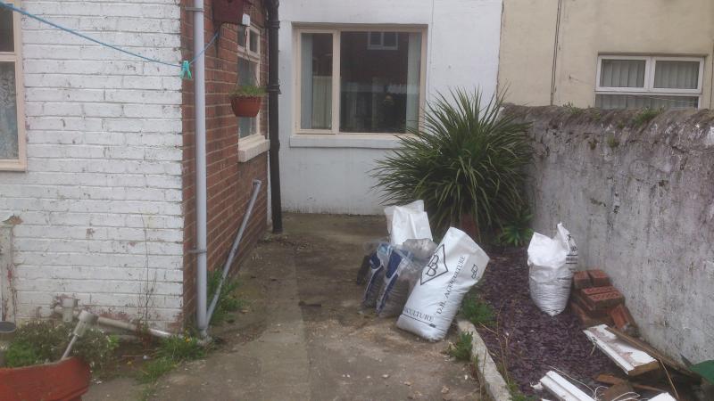

I've attached more pics, of front/back, high/low, from street and the back room in different directions. Apologies about quality, it was a pretty overcast day, and sorry you can't see much at the front, I'm awaiting a skip!
At the front elevation,

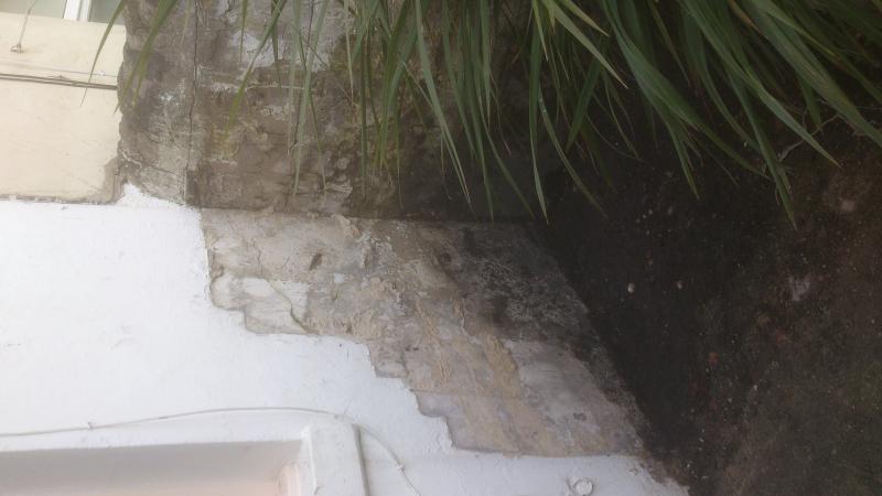

i doubt that the 1m render serves the pupose of keeping the damp out of the front room - anyway, it should not be touching the ground: cut it back by about 25mm - 30mm. Do the same with the rear render.
Is the bay window cill rotted?
Only one 9" x 3" air brick shows. Install 9" x 6" airbricks if using suspended floors.
Green splash is showing at the base of the wall - is the guttering sound and clean?
The Interior knock through(KT) partition is sitting on solid non-honey combed brick. Does it have a DPC?
If a suspended floor is installed, then that brickwork must be removed to allow through ventilation, and supporting floor joists.
It would be worth your while to check that the KT lintel is steel, perhaps an RSJ, and that it has at least 150mm bearing at either end.
Perhaps go upstairs and look for any lump in the flooring, or cracks in any supported wall plaster.
Rear Room: you could remove the hearth soil from before the c/breast.
Have i mentioned sweeping and smoke testing your flues?
Determine exactly what you want for your fire openings, and prepare the openings and hearths while all is exposed. Openings must be lintelled.
Why has the panel of brick below the window been removed?

Yard Area: feel behind the Cast iron soil pipe for rust and decay.
Clear the vegetation from the base of the kitchen walls.
