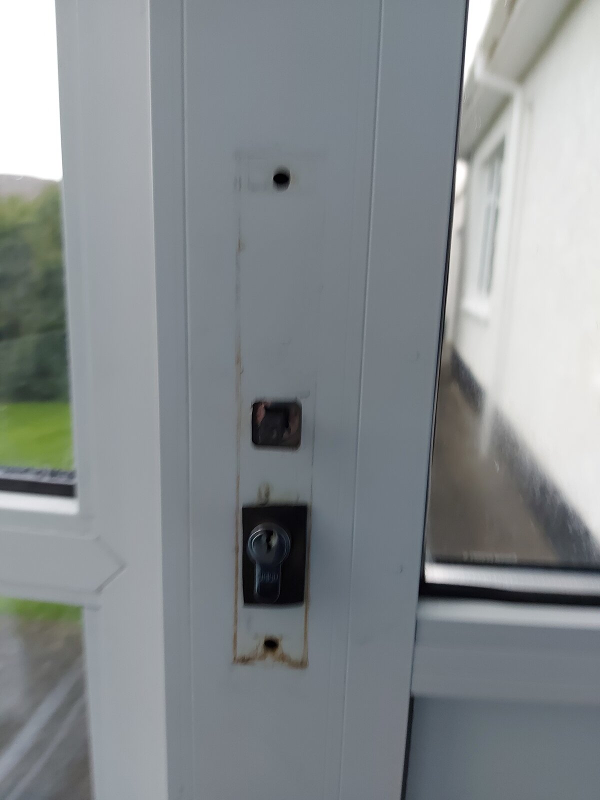

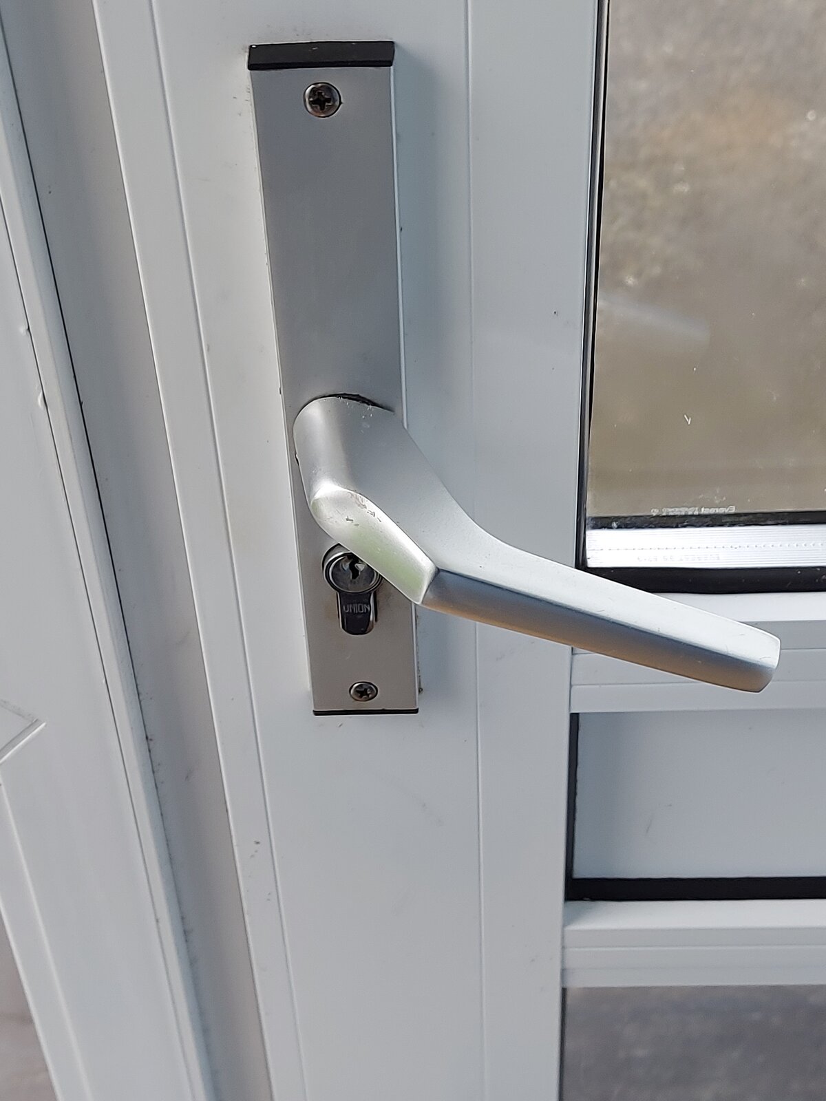

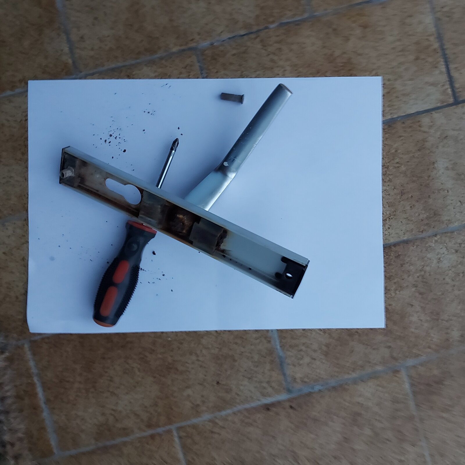

My front door handles need to be replaced, because the exterior handle and back plate has rusted inside. The lock is in good working order.
I contacted Union, but the handles are no longer made. The main measurements are:
PZ: approximately 2" or 5 cms.
Length of back plate: approximately 21.2 cms.
Width of back plate 3.3 cms.
Screw to screw: 19.2 cms.
I have not been able to find any exact alternatives. Please can you give me any suggestions, particularly if I can keep the existing lock?
I have attached 3 photos.
Thanks for any help.

the important measurement is from the centre of the bigger round bit of the Euro cylinder to the centre of the handle spindle
typically its 92mm or 72mm
then you need to check the handle through bolt positions -there are generally 2 man options
here is an example: its a Mila stainless handle with a backplate of 220mm x 32mm -there are the other dimensions shown so you can check
you wont be able to order from Mila but you can google the product name and find a stockist
Thanks.
The distance is only a short one. I have been told the PZ is 48mm if that helps.
The critical measurement is the PZ as that is fixed and can't be altered if keeping the same locking mech, fixing through holes can be drilled, this'll be at least a 30 year old door so don't expect handles to be easy to find so expect to retro fit a different style/make of handle
Two days ago I knew nothing about door handles. Thanks for your help, I now know what I'm looking for. Hoppe do three or four to choose from, including the Hoppe Everest Union lock match. Does it matter if the new holes are very close to the old ones, given that the backplates are screwed together?
Before I order one, I need to check that the bolt has not rusted inside the locking mechanism.
It's best to check that one or both screws don't pass directly through the lock body itself
