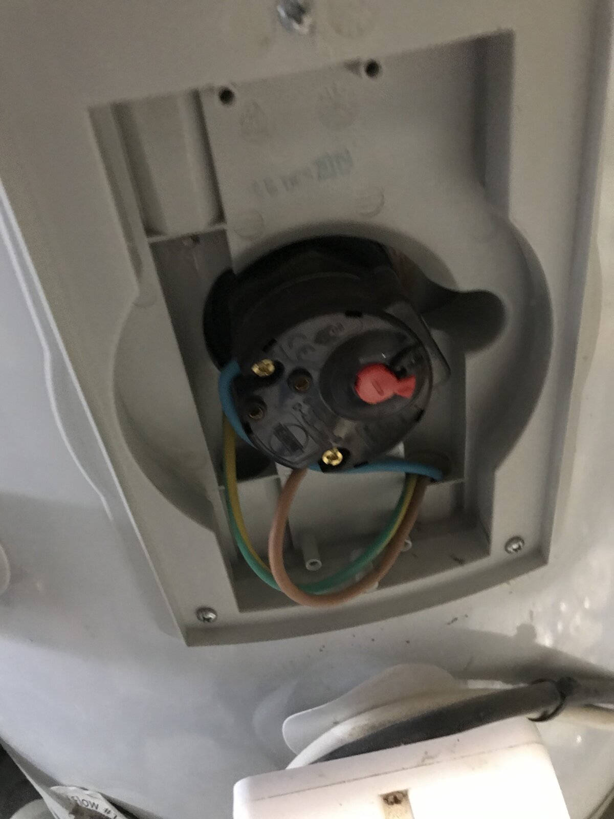

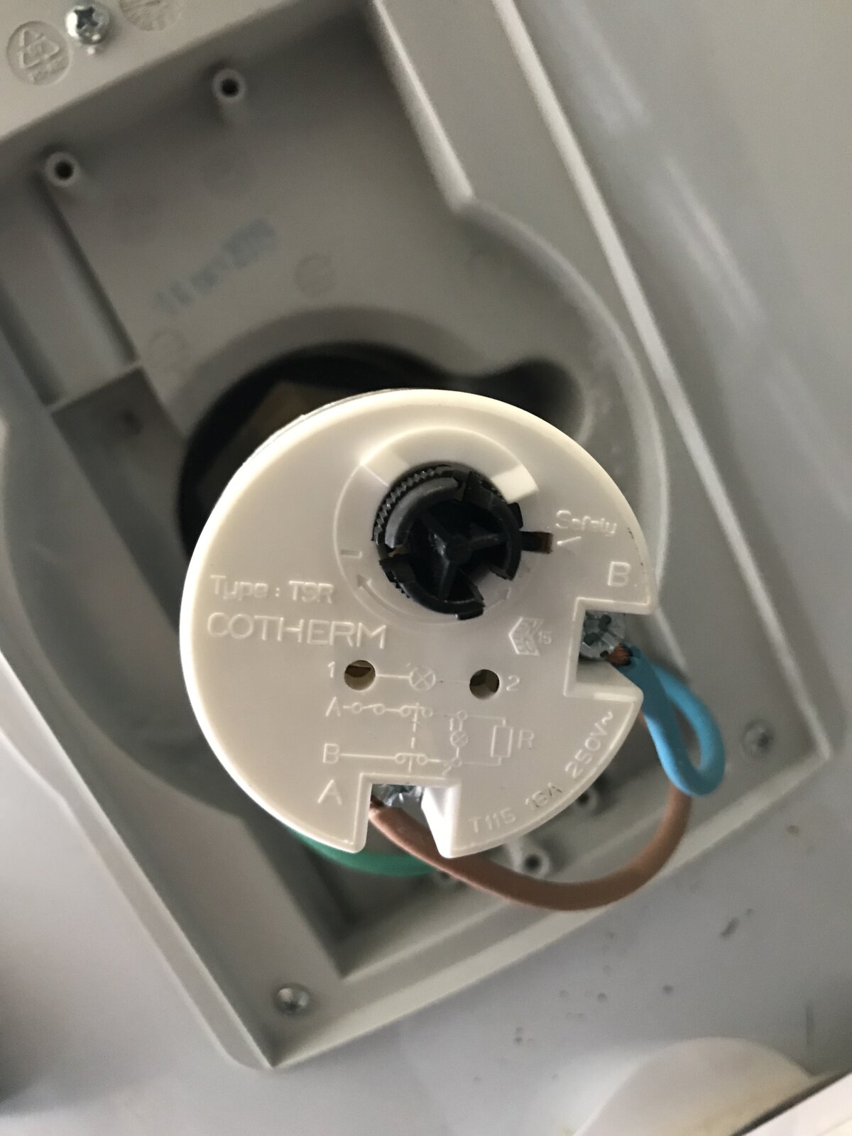

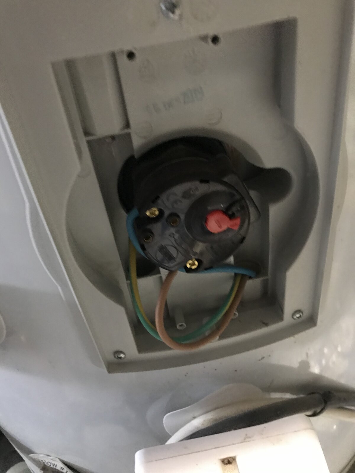

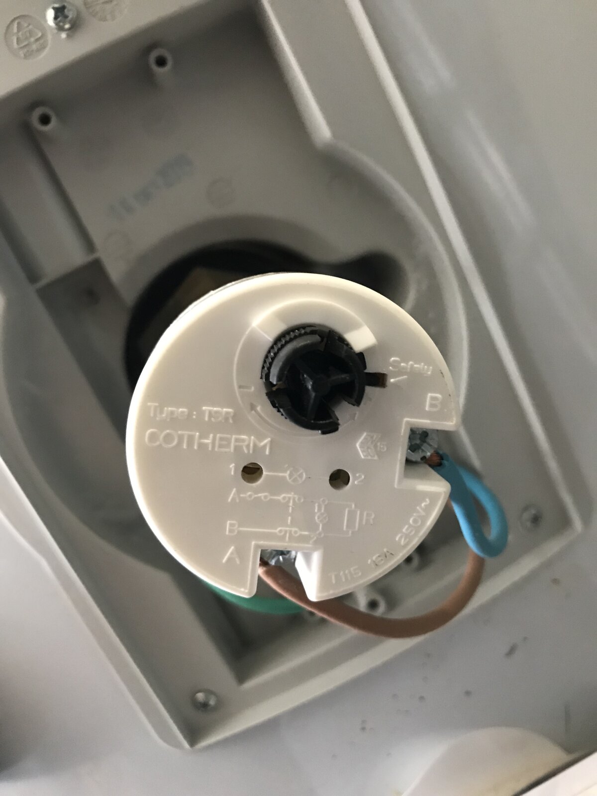

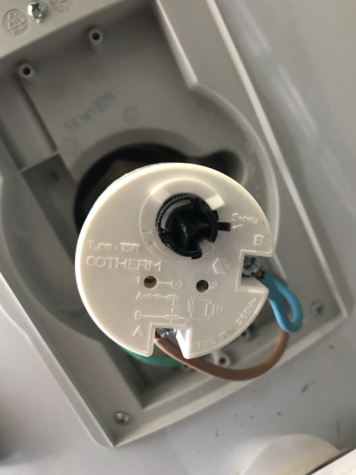

I’m looking for a replacement side immersion heater for an unvented cylinder. It’s the smaller threaded one (1 3/4 I believe) but the nut is around the same.
All the ones I have found with that thread size the same size nut size as a standard size
If I’m making any sense …..
Anyone have a link
Plenty out there but you should be aware that you need to be G3 qualified & registered to carry out this work
You need a G3 registered engineer to fit a factory replacement and test the cylinder.
I am G3 I’ve just never replaced one this size and can not find a replacement.
A normal 1 3/4 does not fit because the brass nut section hits the plastic housing on the cylinder that the immersion is in.

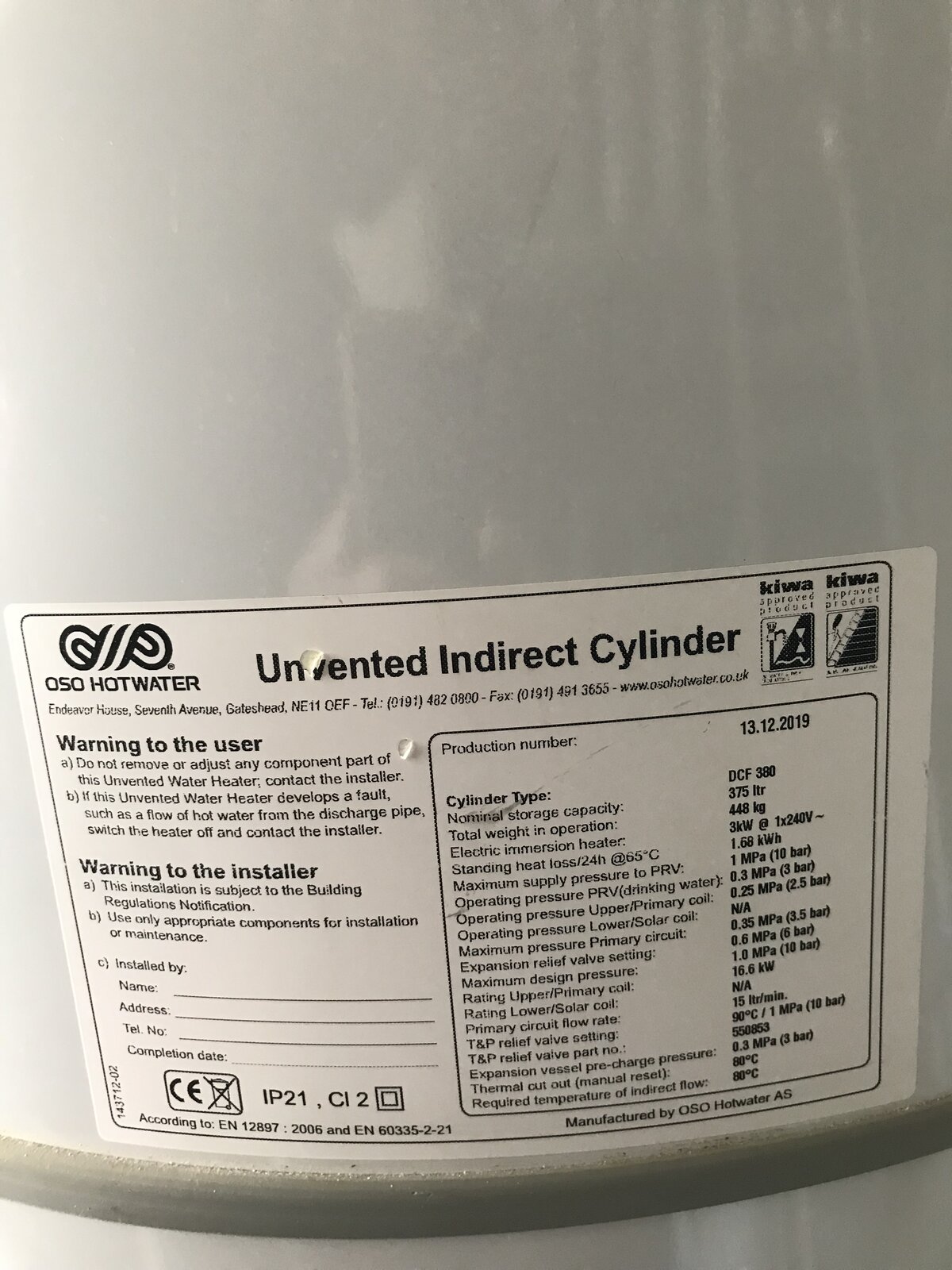

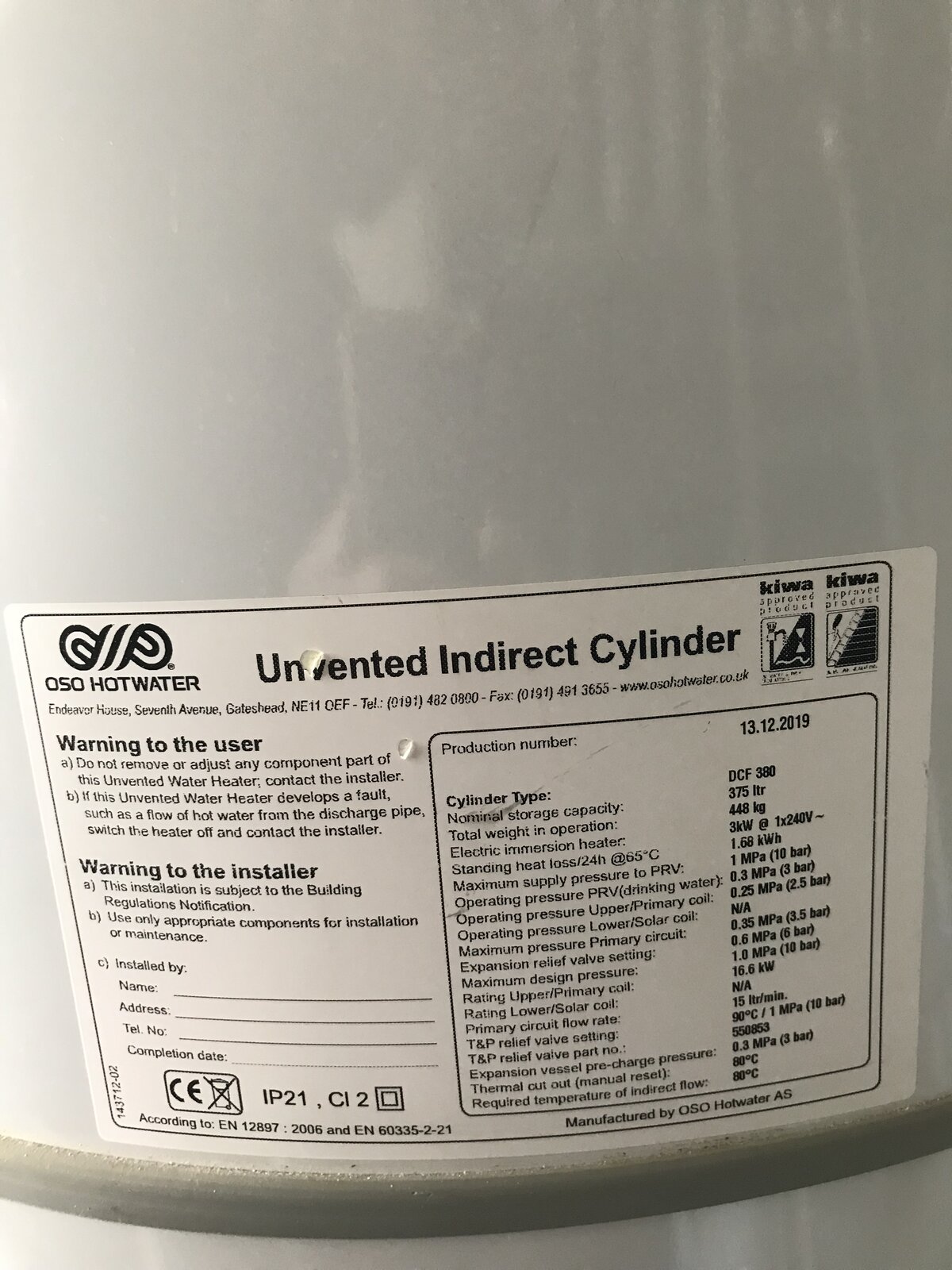

Big beast that - great cylinder - Just match the cylinder type to the element it needs, according to the MI, the Delta uses an Incaloy 3 - 71242, even then though and when all else fails and as suggested then always confirm with OSO, they usually have great cust service

They are a unique size and I can’t find it so I’ve asked here.

According to the data plate the cylinder is a Delta PowerC F1 - DCF380
As per the MI Pg3 - It states it uses the side entry smaller element - 71242, as suggested earlier
