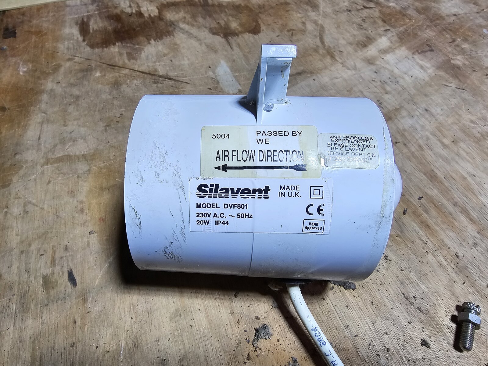

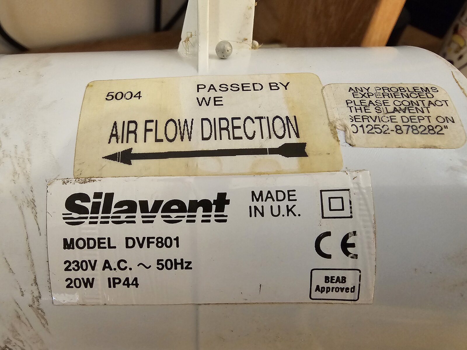

Hi all, the inline extractor fan in my shower recently gave up and I have now removed it and I strongly suspect it was installed when the house was built ~30yrs ago. Any thoughts on a suitable one-for-one replacement? Lablel picture attached and it is on the same switch as the shower light i.e. comes on and off with the light.

Does this fan run on after the light goes out (ie a timer fan?)
If it is not a timer fan then I recently installed one of these to replace my dead one
If you need a timer one then here's your option
Seems pretty good and not too noisy, also reasonably cheap. there are many more like this around.
Stand back and take a wider pic please.
There are some that are quieter and more powerful and use negligible electricity.
If you can convert it to timed wiring, you can probably set it to dry out the bathroom after a steamy shower, even with the light turned off.
Wider pic here. Converting to timer might be problematic as it didn't have a switched live connection and the junction box that supplied the fan and the light has live, neutral, earth (all connected to both light and fan) and an unconnected grey cable, which is a new one on me.....
