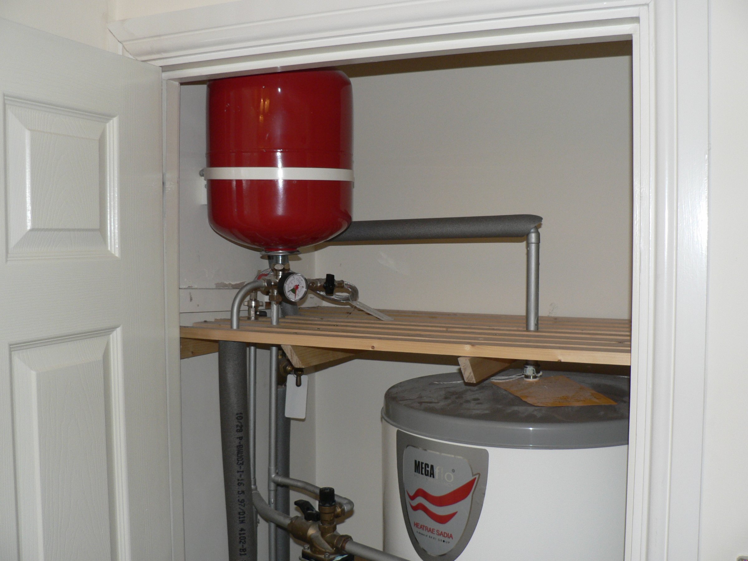

I have a sealed system. I noticed that the last time that I had to introduce fluid (Sentinel) into the system, there was a seepage from the spindle of the ball valve on the system side of the filling loop. This might well last for years before it becomes anything more than a seep.
But, planning ahead....I presume that I will need only to drain away a few cupfuls of the water from the system before I can unscrew the NRV and replace it. As it is at the highest point of the system, I presume that I need drop the water level 1cm and vent off the air pressure in the red tank.
Once I have replaced the valve, I connect up the filling loop and carefully fill the system until the pressure gauge reads about 1,5 bar
I do not want to have to introduce any more air into the system that I need to. We spend so much time chasing it down and bleeding it off.
Thanks in advance for any help.
Chris
:)...crack on..you don't mention replenishing the "air pressure" that you removed from "red tank"???
Call someone who knows what they are doing..
You have got the nrv and the fill valve on the wrong way round, the nrv should be on the cold water side and tap on the system side.
