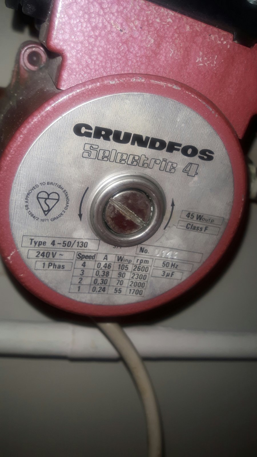

Hello all,

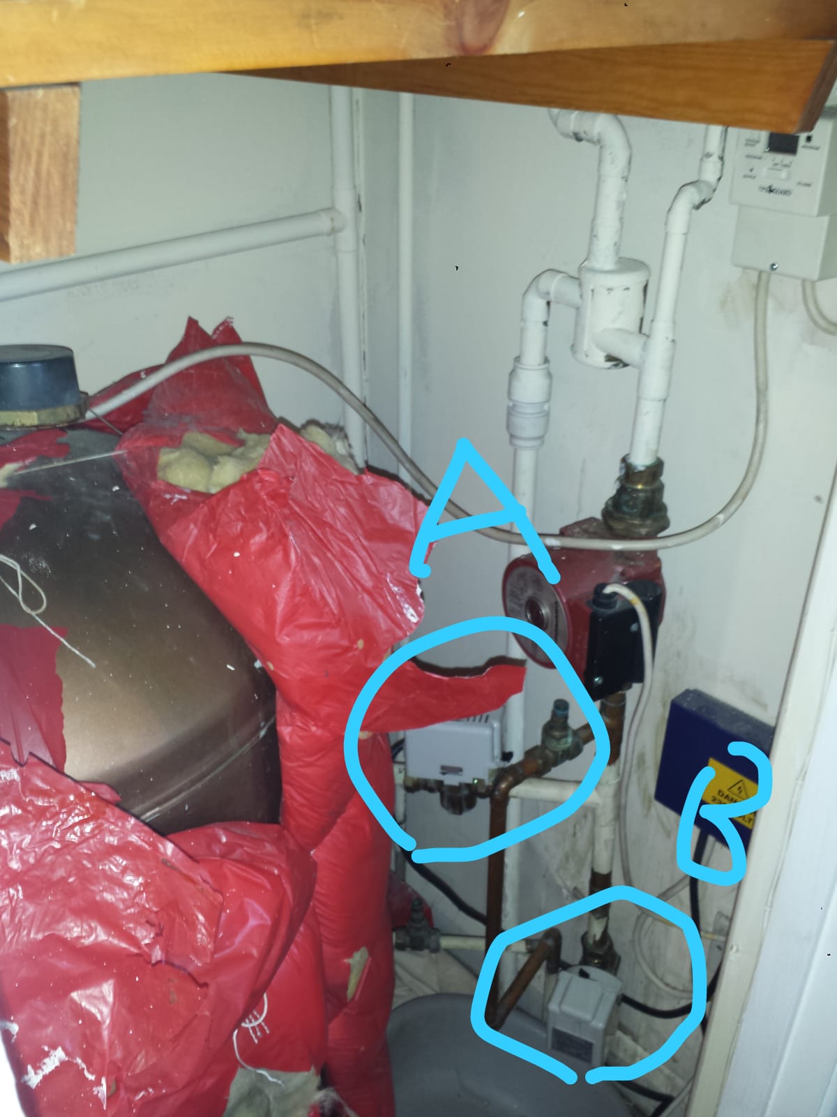

I may have to get my central heating pump changed as it is making an almighty rattle all the time* but I am not sure which one to get. The pump I have currently got is labelled 'Grundfos Selectric 4', Type 4 -50/130 (please see pictures attached) and has 4 speed settings. Is there an equivalent Grundfos pump please? Also, is it worth considering other brands as there seem to be a few cheaper ones available online?

The DAB Evosta will be a good replacement - this is the pump I keep in stock on the van and the ones I've fitted so far have all proved to be reliable. It will also draw about a third of the electrical power of your existing pump, so should pay for itself ;)
Be aware that those old pump valves will leak if you try to use them. No ifs, no buts, they will leak. You'll need to drain your system to replace them as well as the pump. I've started using butterfly handle valves with good success although I can't comment on their longevity yet!
Thanks for the quick reply; i'd already looked at those DAB ones and now i'm more re-assured about buying one. I noticed the link you provided says "Install with motor shaft horizontal". Apologies for the silly question but isn't my Grundfos one currently installed vertically?
Also just out of interest, what do the numbers mean on the pump please? The Dab one describes itself as 40-70/130, where as the original Grundfos has 50/130 written on it?
Also, my plan is to drain the system anyway, then unscrew the unions and then fit the pump, if I don't actually turn the screw on those valves, will they still leak? Obviously i'm trying to save a couple of quid here but i'll default to your judgement.

Just install the new pump the same as the old pump....behind the large screw on the Grundfos is the pump shaft which must be installed horizontal to prevent excessive wear etc.
The Grundfos numbers mean it's a 5m head ie. it can support a column of water 5m high (with no flow...a pump is never run like that though), the 130 refers to 130mm distance between valves (standard nowadays).
The Dab means it can provide a 4 to 7m head.
If you don't touch the valves you might be lucky but I would replace them with pump gate valves.
Clean out the debris in F&E cistern before you drain down...got a wet vac?
