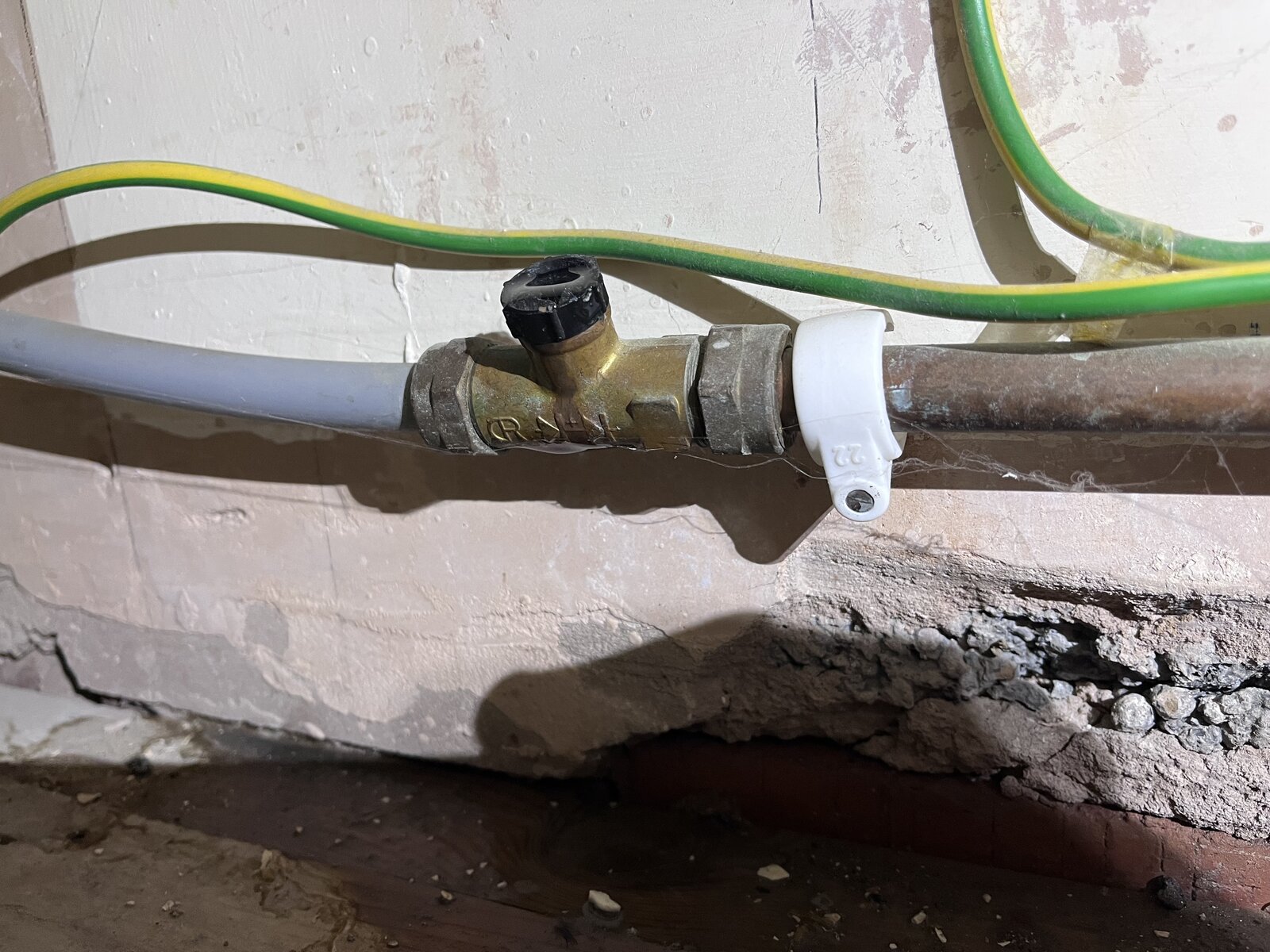

Replacement service value
That’s a verifiable double check valve, not a service valve, so needs to be a double check valve (not necessarily verifiable).
