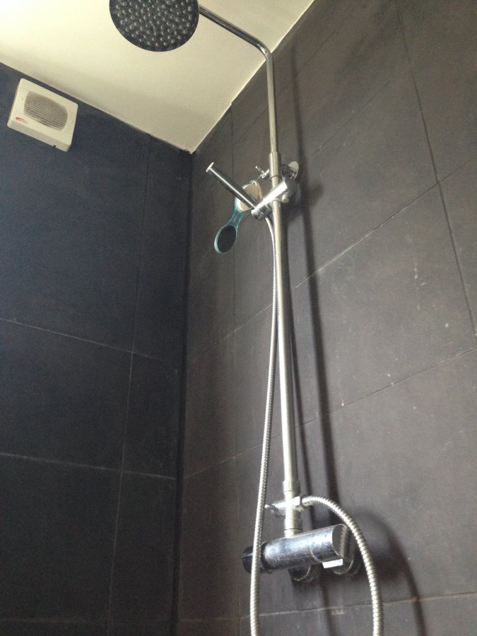

Hi there,
I have a thermostatic shower bar mixer on my shwoer which has gone bust due to limescale. So I went to replace it but found that the pipe inlets are 100mm which is completely unstandard. I've looked around and can't find any similar showers with a 100mm pipe centre (apart from a caravan one!)
I was wondering if anyone has come across a similar issue and knows where to get one? I'd quite like to avoid having to retile and re-plumb if possible!
Thanks a lot,
James
Some have Z connectors, they swivel to increase the distance however understand they can be fiddly and some people don`t like them.
Hi does this photo help?
A Mira Miniduo at 110mm centres could maybe be persuaded to fit if you've got a bit of slack in the pipes and could shift them apart a bit.
Other than that, have you tried showerdoc.com to see if they can provide a new cartridge?
