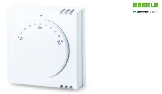

Is there a replacement for the Eberle ETS1 4wire Thermostat?

I've not heard of a Eberle ETS1. Do you mean an RTS1 like this?
If so, it's the same as a Drayton RTS 1
But it's doesn't have 4 wires....:confused: unless you are counting an earth.

The stat I have is a mechanical type not electronic I think.

Timer calls for heat, thermostat calls for heat, boiler comes on, when temperature reached heat does not switch off.
Checked the stat with a meter between L & N is 240v, between yellow switch wire and N is 240v which goes to zero when temperature reached, therefore the problem does not appear to be the thermostat, could it be the 3 way valve?
Only way to shut down heating is to set the timer to off.
if switching the timer to off turns the boiler off then it is likely to be the timer rather than the three way valve, your thermostat is working correctly
