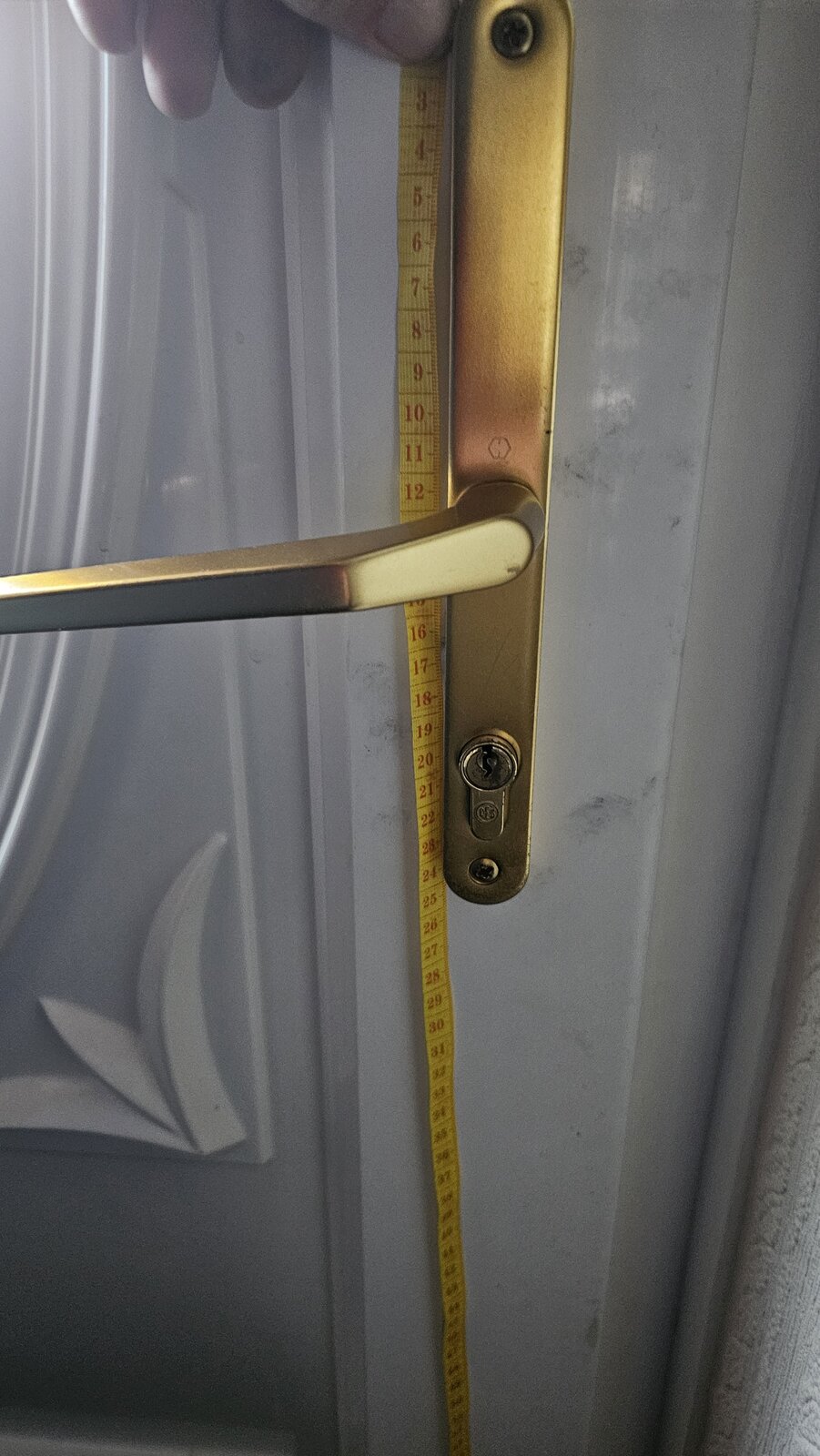

Can anyone identify this door handle, and ideally suggest where I can get a replacement.
I think the PZ is 85mm which seems pretty rare.
TIA.
They're Hoppe make of handles, think you'll be very lucky to find them as everything has been 92mm(pz) for the best part of 30 years, your best bet are the universal pz handles
Is the pz definetly 85? Centre of spindle to centre of the circular bit in the eurocylinder
