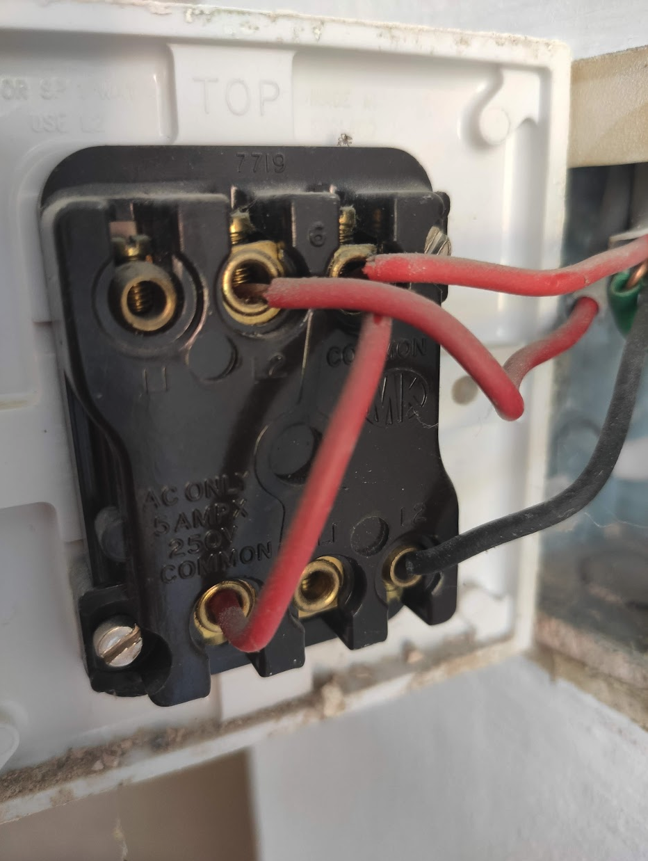

This is my current witch wiring:

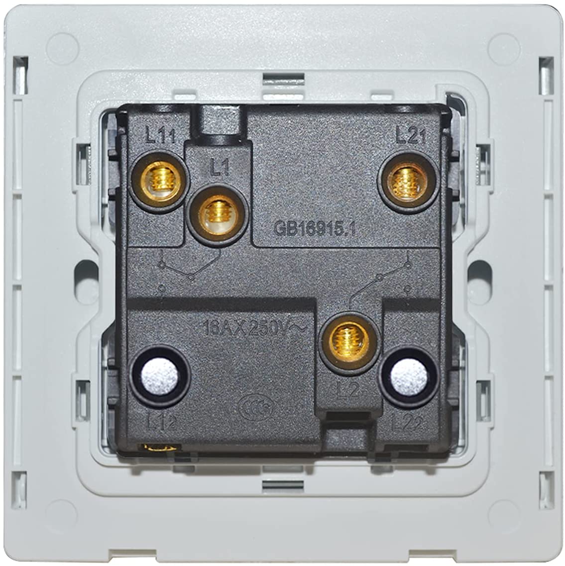

And this is the switch I will be replacing it with:

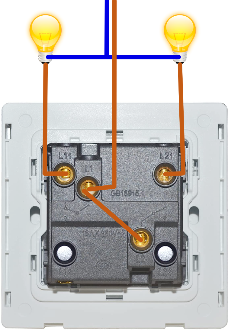

If I got this right the wiring should look like this?:
Thank you :)
It would appear so. Don't mix up the Red wires.
If you want to have both lights operated by one switch, then any old single switch would do.
Just put the output Red and Black in the same terminal.
