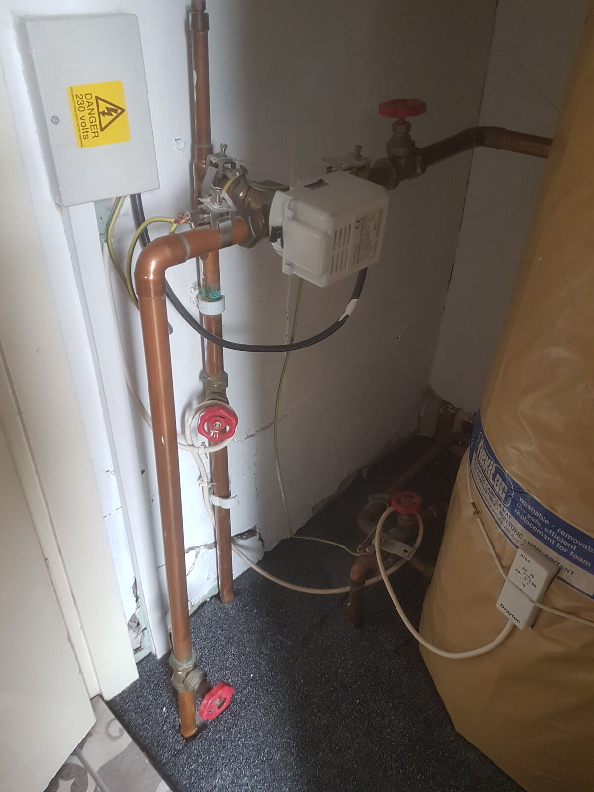

Hi everyone,
I have a 3 port valve which has seized in the mid position. I've checked the motorised head and that is working fine.
The 3 pipes to the valve each have an isolation tap on them. I'm just wondering if I can replace the valve without draining the system if I close these three taps?
Thanks in advance.

Gate valves are notorious for not fully closing ,and you have 3 of them to contend with !! Probably wiser to drain system.
1. I think its worth trying to turn off the gate valves. The ones fitted to vertical pipes will probably be OK. The one fitted to horizontal pipe more likely to let by.
2. Turn off the valves. If stiff, remove handles and use a spanner. If any won't turn with reasonable force, abandon and proceed to drain down.
3. Carefully loosen the compression nuts to each valve inlet and make sure each pipe is loose at its connection to the valve. This will allow remaining water in pipes to drain. Plenty of old towels, an oven dish handy. Wet vacuum ideal.
4. If water stops, or flows only at a manageable rate, fully undo nut and remove pipe from valve. One at a time, and be ready to push back together if water flow increases significantly.
5. If water flows too feely, retighten nuts and proceed to drain down.
Thanks for the advice. I will give it a go once the new valve arrives. Cheers
Quick Update: All the gate valves were working fine. Fitted replacement no probs. 15 minute job. Thanks again for the advice
