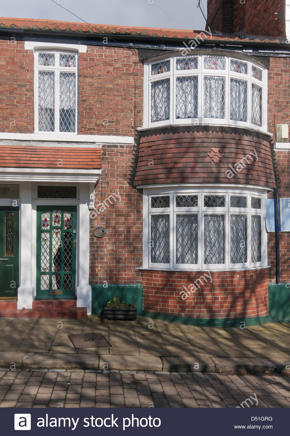

Not my bay, but pretty much identical:

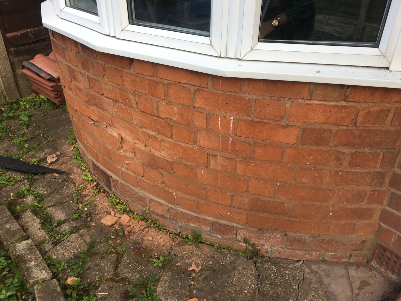

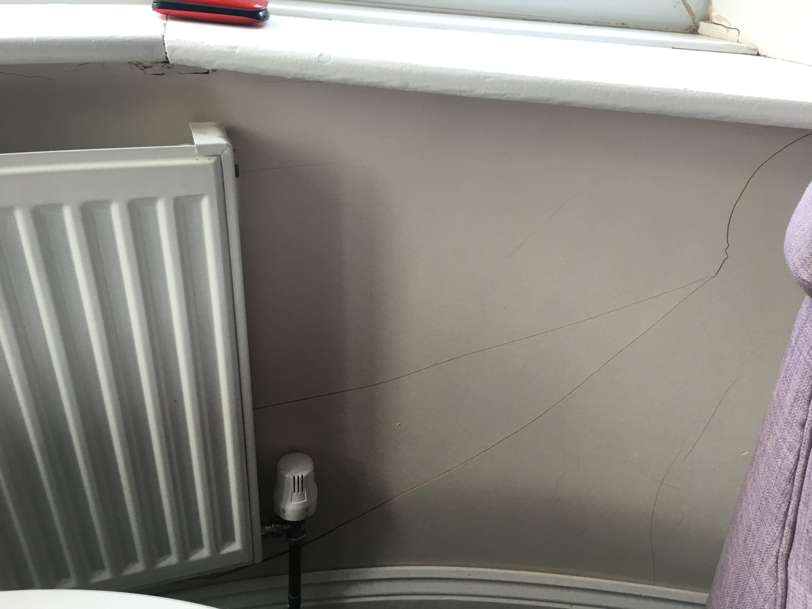

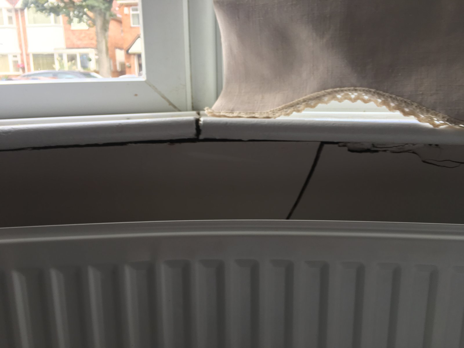

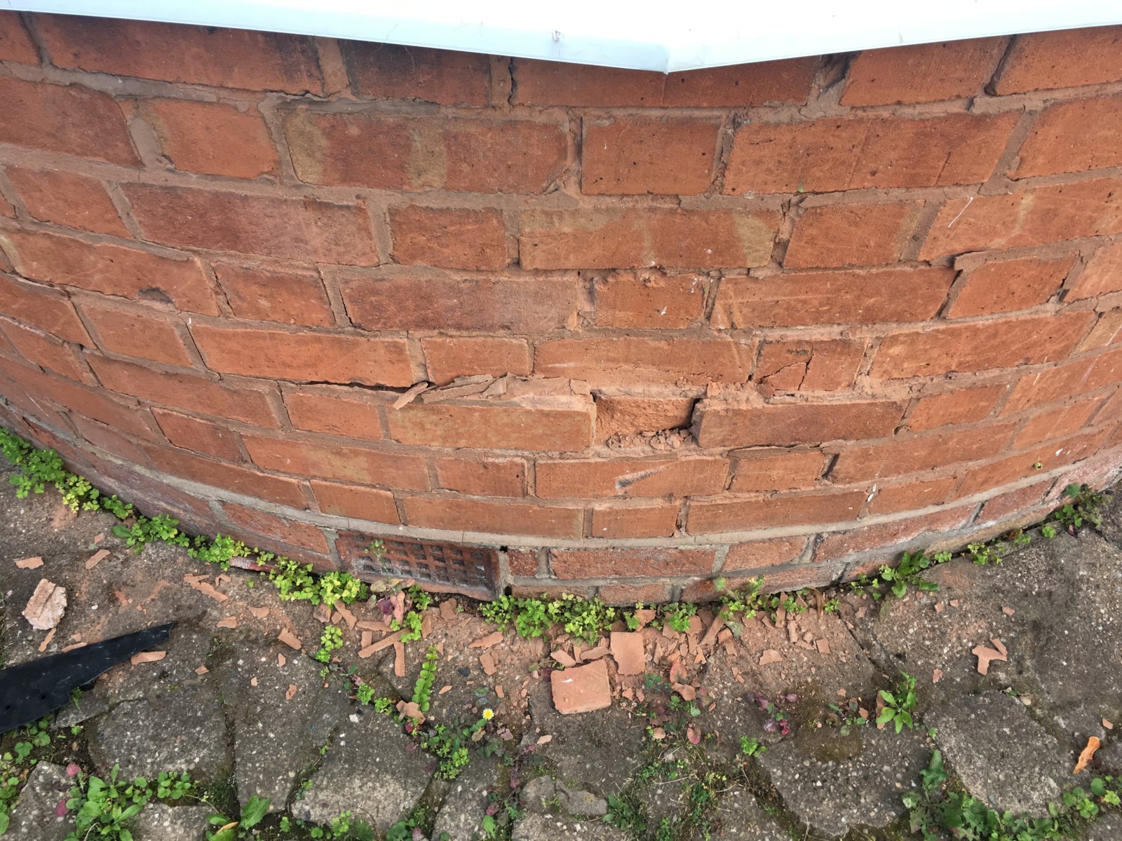

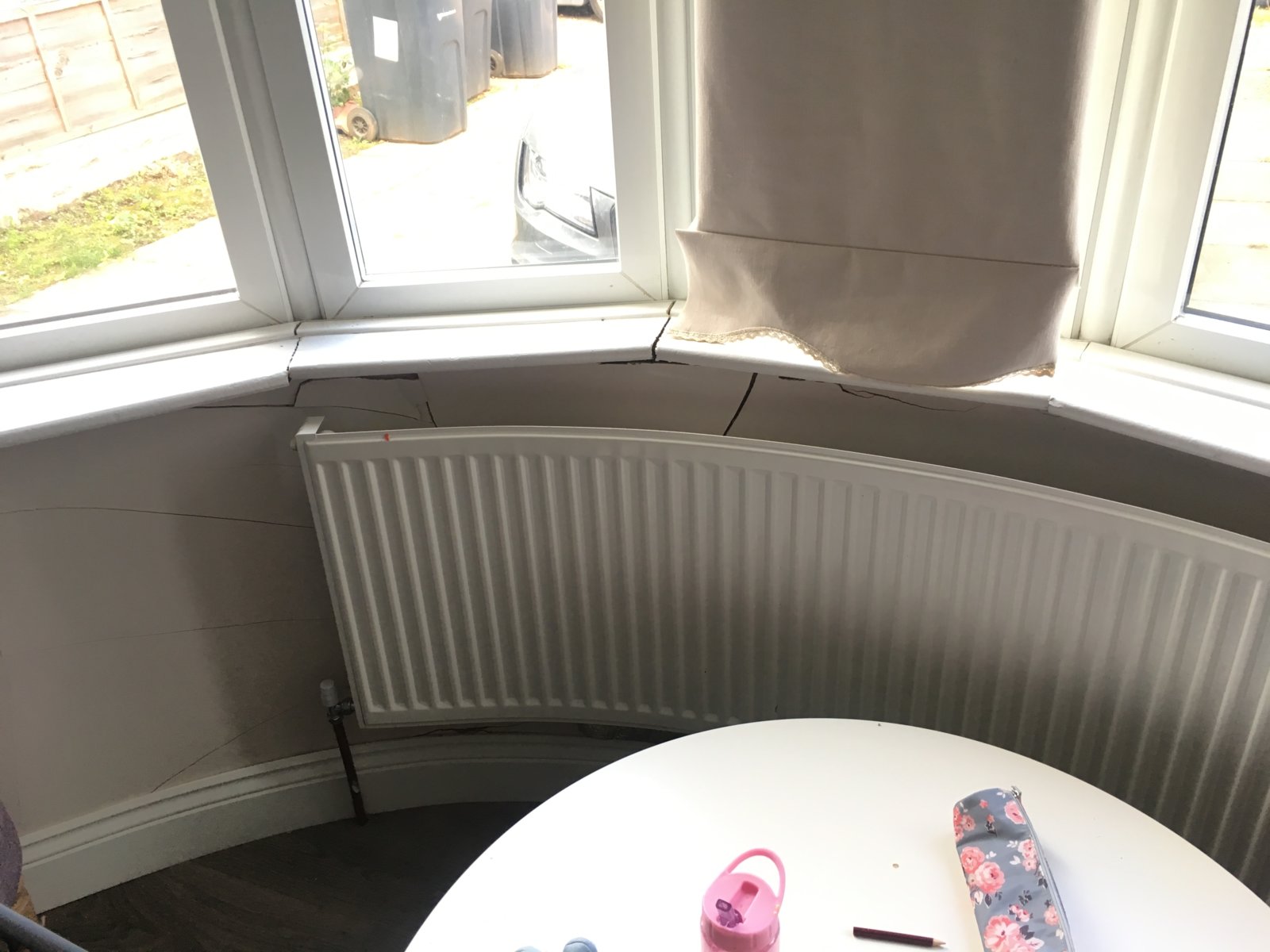

Thank you for your reply!
I am attaching some pictures here. The bricks that need reseating are predominantly in the middle, but some just under the window have moved slightly.
Also the window has moved away from the wall ever so slightly on one side.
The interior will defo need reskimming as a minimum.

you might need to slip needles through the brickwork to support the frame while re-setting the dislodged brickwork takes place.
its a simple job to remove the rad, and all the plaster back to brick on the inside skin. dont touch the skirting.
check for cavity insulation?
you'll probably need to lift off the window board sections - do it gently and prise each one up, and slowly pull them out.
now remove and re-bed any bricks that have moved out of plane - the top of the skirting is your benchmark for keeping bricks and new plaster in plane.
gently ease the frame back into its original position - you might have to cut any fixings and then re-fix through the jambs.
when the frame is settled then fix the window boards.
you dont show the head of the frame or the jambs so i cant comment much more about them.
the correct position for your DPC should be in the bed below the airbricks (perhaps the path has raised the ground level) - but maybe its in that thick bed just above the airbricks?
now might be a good time to check on the condition of the joists that could be sitting in the bay?
i say "you" but curved work and needles really needs a bricklayer.
