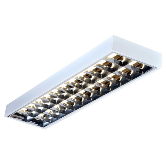

They are 6200lm tubes.
Bit of help, please.
I'm considering replacing them with Integral Lightspan fittings, as I have had a great experience with their LED slimline bulkheads.
My eyesight isn't the best anymore and I need a bright light most places I go.
The kitchen consists of two areas, each approximately 2.3m². Ceilings are white, 2.4m high and the walls are cream.
I don't have access anymore to a quality lighting calculator.
What size Integral Lightspan fittings would you choose?
Thanks.

So if you were swapping 2x 6ft (6200 lm each) HF flu fittings for LED, would you exceed 6200 to make up for the inherent differences in the LED fitting?
If I was swapping 2 x 6 ft I would be looking for maybe 4 LED fittings instead. I am at the moment looking at my kitchen, and I think lighting track is the way to go, so I can move from the single point where the light is, without access to ceiling, and not make it look like an after thought, which of course it is.

YOU are aware 6ft fittings come in single and twin versions, according to the Internet, the fittings you like are 7800lm for the twin
Two of them i would say is ample, maybe even too much.
Led is improving constantly, it has too with the demise of tubes
Yeah, think they are 65W, so will save 10W between them compared to the existing lamps.
Was hoping to save a bit more swapping to LEDs.
Initially I was thinking of 5 foot twins.
