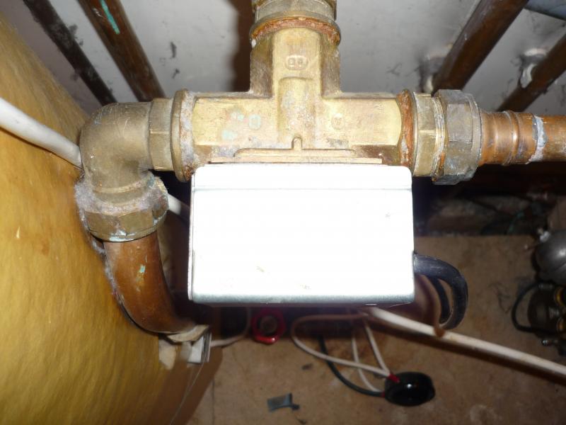

Apparently the input/output ports to the unit are 1 inch BSP female connections. The faulty unit that is currently installed to my system has brass female ports that then appear to have brass female to male adapters, which then connect to the copper pipework with what looks like a giant 'tap connector' fitting' (i.e. a brass nut on copper pipe, probably with a fibre washer).
I intend to take the unit out and reuse the other fittings (brass female to male adapters and brass to copper fittings), but what worries me is that I've not made any brass to brass connections before and there appears to be a brown jointing compound. Can I just clean off the old compound and reuse? If so, what compound would you use to make the joints? Is ptfe tape a bad idea here?

Any chance of a photo? All sounds quite odd to find 28mm on an ordinary domestic system and union adaptors too. Are you sure they are not 22mm female compression with the male nuts?
Brass to brass screwed connections are fine with ptfe but use lots it goes down to nothing when compressed.
I'm a bit confused the pipe on the right is smaller than the one on the left and has had an adaptor to a copper to iron compression union fitted is that 15mm or 22mm?
If it is 22mm that makes the one on the left 28mm quite possible but it would take a superman to put the bend in it that it has got so I'm a bit unsure if it is a 3/4 or 1" valve.

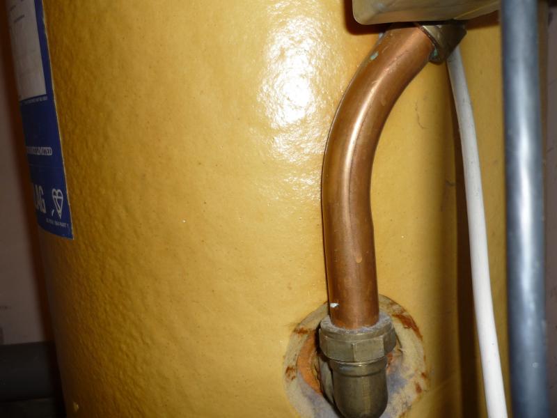

Yes, you're right, the copper pipe on the left is 28mm, whilst the copper pipe on the right is 22mm. I've added a picture of the bend on the 28mm pipe from a straight-on angle, just in case the top view is a bit misleading.
I've also added a picture from the top that includes the pipe to the inlet port. In summary, it's 28mm copper pipe in and then 28mm out to the immersion and 22mm out to the CH.
As you say, there aren't really any problems I can solve until I've got the new valve and start work.
However, thinking ahead and assuming that the brass casing of the valve has the same external dimensions as the old one, it should be a straight like-for-like swap with no significant changes to the pipework. I think that the right hand port and the inlet at the top of the photo can be tightened up so that the new valve is in exactly the same position as the old one, but I am concerned that the left hand joint (which I think I'll have to do first) may tighten up leaving the valve in a different position, which means I'll have to adapt the 28mm pipework.

Yes the other photo shows the set on the 28mm has been done with a bending machine, I wonder if it was an old gravity system that was converted, still no matter :D
As you say you will need to get the LH elbow connection on and correct first.
You may have to have several goes to get it tightening up in the right position just add more ptfe each time till you get it right.
The old hemp was good for that as it had more "body" but persevere with ptfe it should be fine, if all else fails get some Loctite 55 cord.
http://www.tooled-up.com/product/lo...oductlisting&gclid=CNqE--6YmboCFY7HtAodQF0ApQ
That has a bit more substance if needed.
The other joints look like they will have olives, rather than washers a bit of ptfe over the olive will help the seal on the old joint when you remake it, or you can push the boat out and get a tube of Fernox LSX sealant to smear on them brilliant stuff, I love it! Never let me down yet but pricy for just one joint or two.

Good luck, fingers crossed it looks pretty straightforward as long as the old joints come apart without too much effort, whatever you do don't pull the connection on the cylinder about too much that is the weakest part of the set up.
