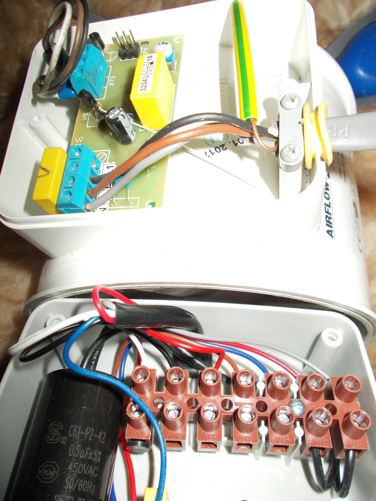

Below is a picture of the two units, with the old unit above and the newer one below. As you can see, my 'big grey cable' (sorry, I'm not good with correct terminology) has four smaller wires - grey, brown, black and something else, which currently just has a loose sleeve over it and it's connected to anything in the old unit.
The 'chocolate box' (I think that's the right terminology?!) in the new unit has four available 'slots', but I'm not sure what should go where. Also, the four available slots seem to be labelled '600v' and '450v', but I'm not sure how relevant that is.

The grey cable is 3 core and earth - which on the old one are Live, Neutra, switch live and earth/cpc (not connected to anything. Is there anything that resembles similar in the manual? Can you post a photo of the wiring from the manual or state which make and model you bought?
The labels on the old fan are N (grey), L, (brown) LT (black) and then the unused one is L1.

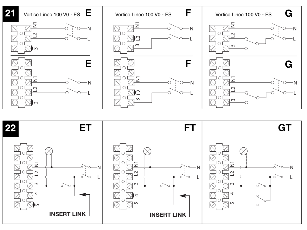

The diagrams in the manual are below -
You have a 7 strip, so it will be, imo one of the step 19 - just can’t work out which timer control you have.

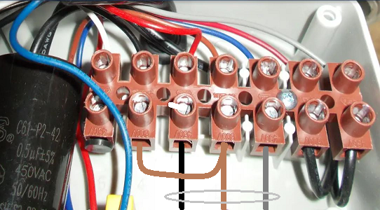

Edit: Thanks to @EFLImpudence - the timer appears to be your option.

EFL's photo above is spot on, just follow that. Just to explain the supply cable, the grey is the neutral, the brown is a permanent live (possibly via an isolator that is left on), the black is only live when the bathroom light is turned on. This then starts the fan and continues to run for a set time after the light has been turned off.
I assume you had that facility with the old fan?
The green and yellow wire is the CPC (earth). As there are no metal parts in the old fan, it has nowhere to connect to. It shows good workmanship the way it has been left in the terminal box, looks like a good spark wired it up.
