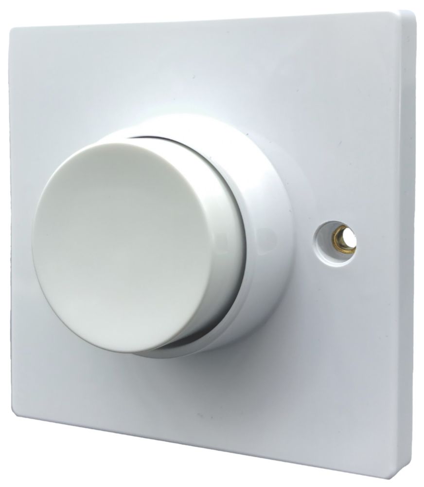

Don't think I can use one of the timer switches in the bathroom as the light is a pull cord one inside and I couldn't easily wire it up anywhere without moving wires - so chasing out or having surface wires...
However I'd forgotten they exist (brought back memories of rented flats and bedisits and being plunged into darkness as you were about to put your key in your door) Would be handy for possibly the stairs but definitely the under stair coat cupboard - both of which lights I spend my life switching off after children and nagging about...
