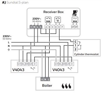

The T6R-HW receiver box....
....replaces the UP1 programmer
The existing wires are moved across from the UP1 to the T6R-HW receiver box terminals that have the same functions as identified from the two diagrams above. Terminals L, A & D should also be linked together.
If you do have a 3-Port motorised valve (instead of two, 2-Port valves) then you will have a wire in the 'hot water off' terminal of UP1 terminal (1) which should correspond to T6R-HW terminal (F) although it's not actually shown connected anywhere in their diagram. Maybe @Jajodu has installed one and can confirm this.
You won't have any OT (OpenTherm connections)
The existing RS1 thermostat should then be decommissioned. It can't just be disconnected otherwise the wiring will remain open circuit and the heating won't work. This is done by tracing the thermostat cable back to its origin, disconnecting the wires at source and then linking together the terminals where the thermostat live switching wires have just been removed from to complete the circuit. Alternatively the RS1 could simply be left in place and left set on its maximum setting. This will prevent it interfering with the operation of the T6R-HW.

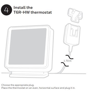

The TR6 thermostat plugs into the mains and communicates with the receiver wirelessly.
As mentioned I'm new to the subject and hadn't relied everything was wireless. Does the receiver go where the UP1 box is now mounted?
I've looked in the airing cupboard and there are 2 x 2-port motorized valves.
The existing wires from the UP1 need reconnecting to the new Honeywell receiver, so it's usually the easiest to mount it in the same place, but you can relocate the wires to a different position if you wish.
If you have 2 x 2-Port valves, that means there will be one less wire to relocate, as there won't be a wire in UP1 terminal (1), so the question about the Honeywell terminal (F) doesn't apply now.
So:
UP1 N = TR6-HW (N)
UP1 L = TR6-HW (L)
UP1 3 Hot water on = TR6-HW (E)
UP1 4 Heating on = TR6-HW (B)
Link TR6-HW (L) (A) & (D)
EDIT
Diagram added. The connections to the motorised valves and cylinder thermostat won't change from what you have now. the diagram shows the connections at the receiver that you are interested in.
