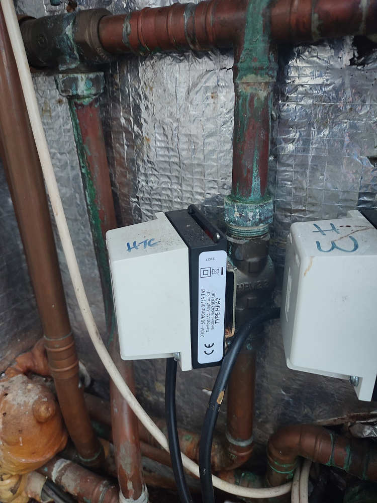

Hi,
Our heating got stuck "on" - the thermostat was off, even switching it to off at the controller stop the heating. Seems this can be one of the motorised valves being stuck open.
This seemed to be the case, I checked the valves and the CH valve was in the manual override position (the little lever all the way to the end and hooked over). Which is a bit odd, not sure how it got into that position. It was working fine until yesterday when I noticed it not turning off - and no one's gone taken the back off the boiler and fiddled with it.
But the valve is slow to return, and seems to be steadily leaking when in the open position, so I'd like to replace it.

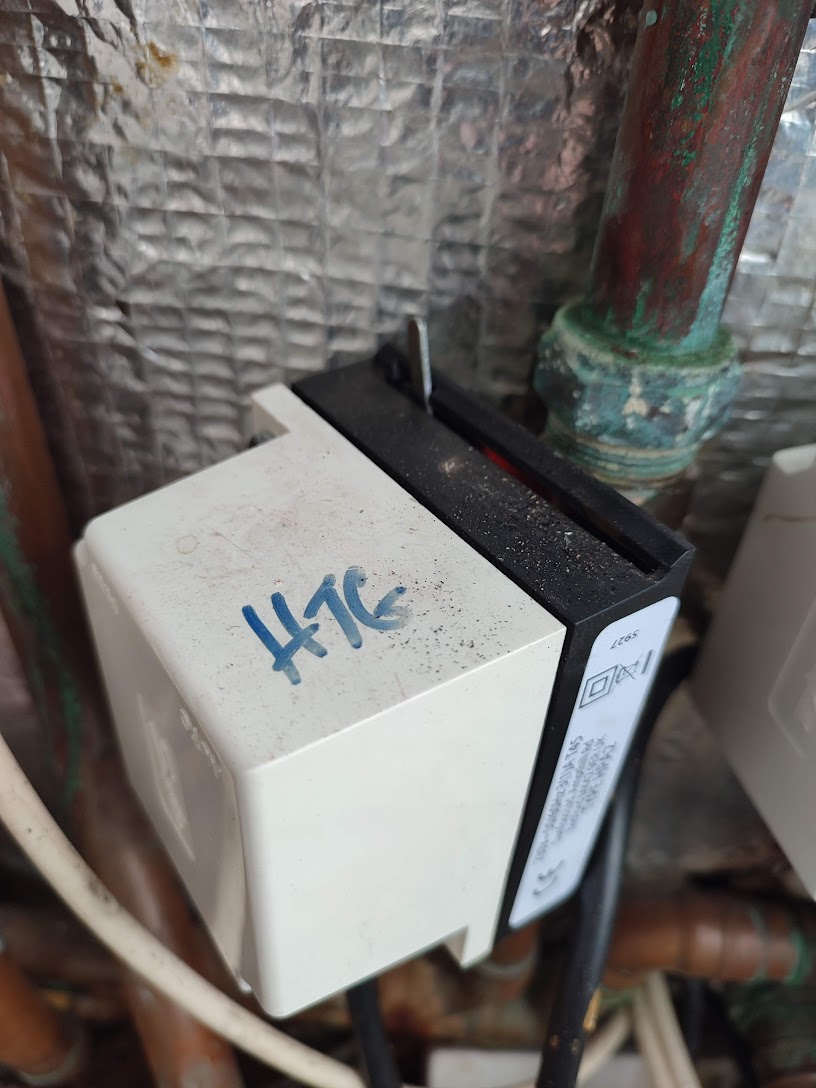

Happened again. The motor doesn't move the manual override lever, so no idea how it's getting stuck like this:

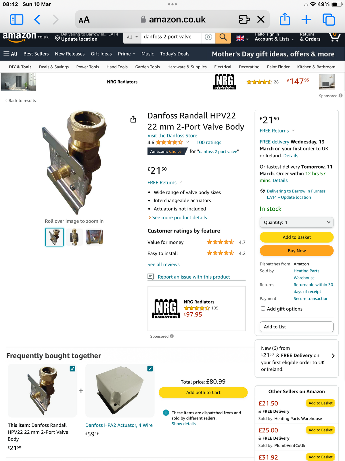

Base available as a separate item
I hadn't seen you could buy just the body (I knew you could buy just the head, as that seems a common repair!) - not sure it would be worth the cost saving for the peace of mind of just dropping in a whole replacement though. I think they're 10-15 years old, and the head might actually be part of the problem (maybe because it's been leaked on)

Honeywell is also 5 wires with a similar schematic showing an earth. Also nearly twice the price! I'm wondering whether it's worth the extra over the Drayton or a replacement Danfoss.

I've seen this before manual lever latches itself on for no apparent reason.
Though way outnumbered by honeywell valves we probably replace more danfoss than anything else long since stopping fitting them.
We currently fit E P H cheaper than honeywell and 5 year warranty they have a earth connection but you almost certainly have one in the junction box your valve is wired into.
