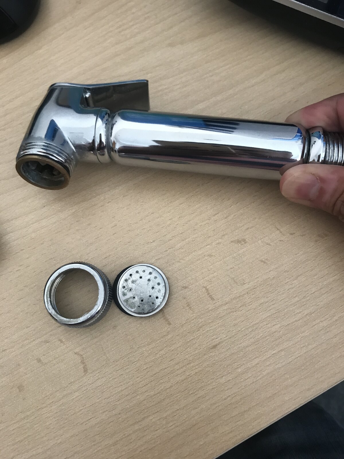

I’ve got a shower head / douche valve which I thought that the pressure was so high it was hurting my private bits when activating the trigger.
I’ve now realised that whilst the pressure is strong, it is not the issue. It’s the crappy bit where the water comes out as a fine spray.
I’ve replace the whole head connected to the hose and valve with some other £10 version from amazon and it’s perfect with water coming out in a aerated soft stream.
Rather than throwing away the old good quality shower head, is it possible to change just the bit with the holes? If so what the name given to this?
If it's made of brass/copper rather than plated steel you could drill out the holes slightly bigger. For a given flow rate that would reduce the fierceness of the jets.
It would just be called the spray head but if the douche is connected to the mains then the whole thing should be disconnected and thrown in the bin ASAP!!

The spray head is what I've already changed with another from Amazon which now works great but what I mean to ask, is rather than throw away the old brass shower head, the small round cap thing which I have unscrewed in the picture with the pin holes to allow the water to spray out, what is that called? I want to see if I can replace that part.
Thanks.

You can't legally fit these in the UK, unless they're supplied from a tank in the loft, as they contravene the terms of the Water Regulations on backflow protection for Fluid Category 5. In laymans' terms, there's a risk your botty batter will be sucked back into the drinking water if the system is drained down, causing a serious health issue, so they're banned.
More info here https://www.wras.co.uk/news/wras_news/categories/installer_news/dont_be_a_douche_about_hand_showers/
