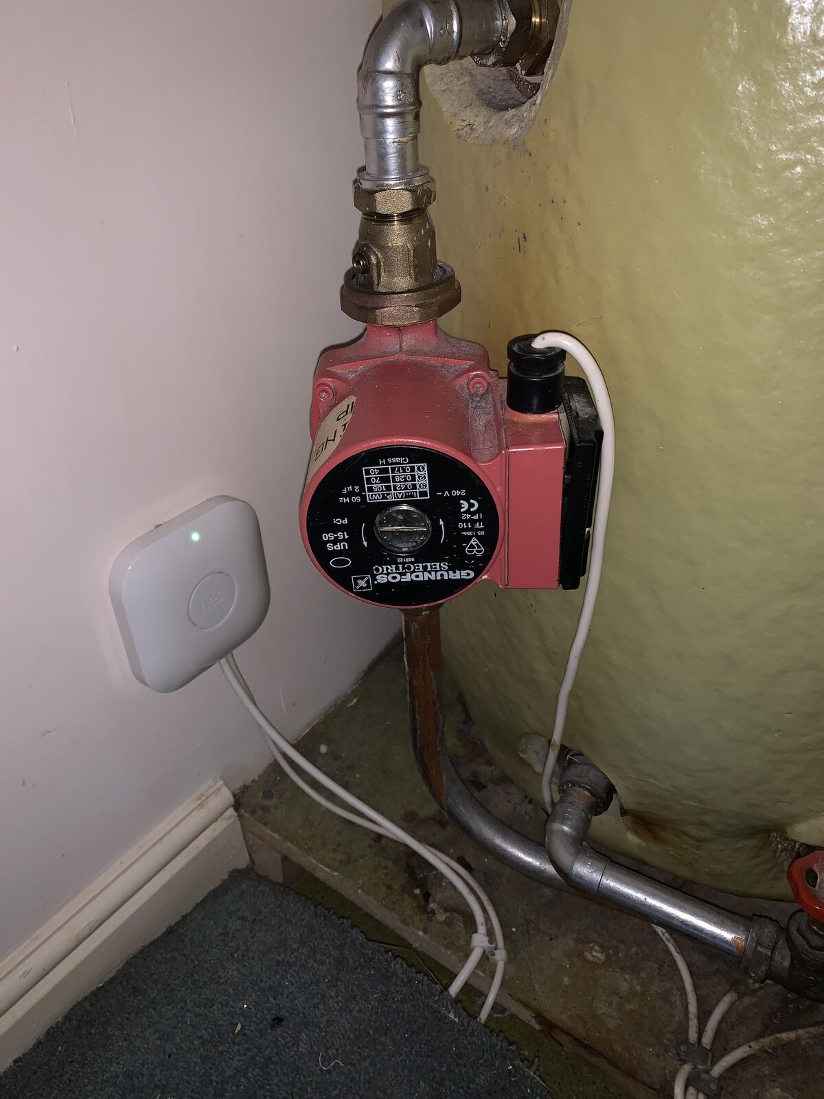

Hi, sorry for the delay in replying. Wasn't getting notified. Here's some pics of what we have.
IMG_0207.jpeg IMG_0208.jpeg IMG_0209.jpeg IMG_0210.jpeg IMG_0211.jpeg IMG_0207.jpeg
1. Combination cylinder at around £400, two pumps at around £100 = £600 for parts. With odds & ends, say £700.
2. £1300 for a days labour - nice!
3. You do have a blanking plate for an immersion heater. Third picture, bottom, just to right of red wheel handle to gate valve. If you could remove that you could probably clear out most of the limescale.
4. If you try it you will need a decent immersion heater spanner and possibly a wet & dry vacuum cleaner. Then:
4a. Just slightly slacken the blanking plate while the cylinder is full of water as its less likely to crumple.
4b. Turn off water inlet to cylinder.
4c. Drain the cylinder.
4d. Remove the blanking plate. There will probably be a good bit of residual water, so plenty of old towels, trays, buckets, possibly wet vacuum.
4e. Clear out the limescale. If you have one, hoover the base out with a wet vacuum cleaner.
4f. Replace plug with a new sealing washer.
4g. Reconnect water and allow to fill.
Without seeing the rest of it, then that system may be able to be updated reasonably easily, go to one pump (S or Y plan) etc by the looks of it. It looks to be in a bit of a mess at the moment.
What boiler do you have?
Do you have good cold mains water pressure and flow?
Do you live in a flat, is there an attic?
There may be some better options than you have there at the moment TBH.
Looks like a mains fed thermal store to me.
Cold main rises on rhs of cupboard, through scale reducer, nvr and strainer, mini exp vessel then t off to feed thermal store then through mixing valve to outlets
