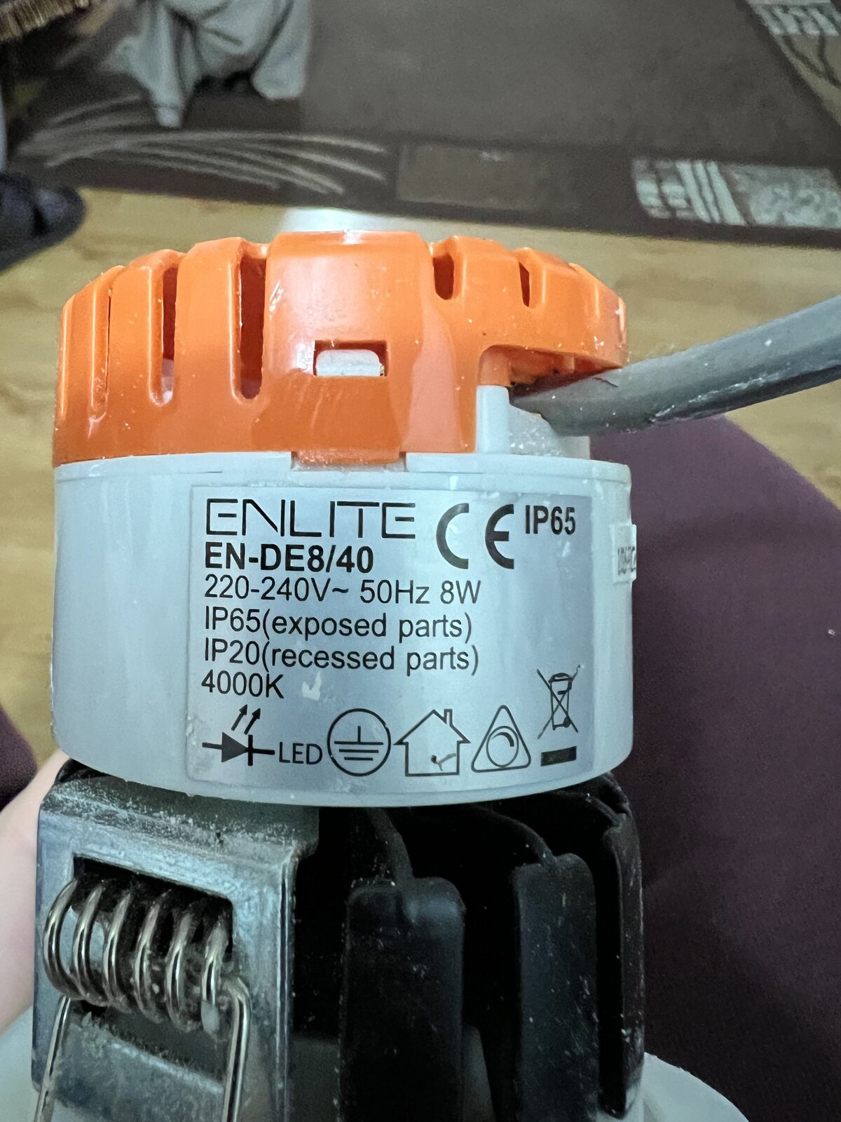

I’ve got a bunch of these in my house. I opted for these around 10 years ago but I suspect that there are better and more cost effective options now.
Do I have to replace this with the same make or can I use a different led? Will the trim work with another light and will the light emitted from this be the same as there are other enlight downlights in the same room?

Try replacing one unit and see if the light output differs.

Yep its the nonsense eco stuff forced on every one totally stupid idea. Its building regs and the idiocy of energy performance certificates. The idea being that the home owner cannot physically fit in to the unit a non LED GU10 halogen like you could a normal downlight.
So in answer to your question the key numbers you need are the wattage - 8 watts and the colour of the light which is 4000k = quite yellow. then there is also the degrees of coverage but that is not written on the can but will not have the same impact as the colour and wattage as to how it matches the others. The 8 watts is a guide to how bright it is but what you really need to go by for brightness is its lumens (LM) the can does not say its LM but the info online for the fitting should do.

4000k is NOT quite yellow
4000k is very white
2700k is about the same output colour as filament bulbs
Ignore the wattage with LEDs - concentrate on the lumens

I get that but it seems a shame to change the other 3 working lights. Perhaps I should bite the bullet and just buy the more expensive replacement but at least it's the same light.
Depends on money really.
The other 3 maybe about to fail.
On the other hand, lasting 10 years is not too bad. Modern replacements may not last that long!
Very difficult to choose the correct Option.
I guess replacing these 4 and keeping the old ones to service the rest of the house is the best long term answer.
