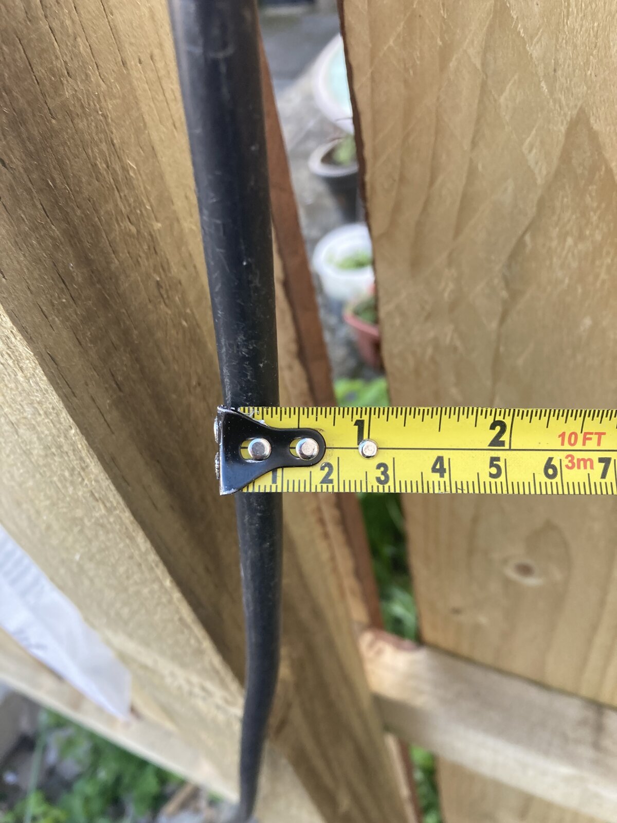

I knocked down an old shed from the previous house owner, which housed as small consumer unit connected to sockets and lights. Protected cable is partially buried in the ground and connected to a 32 amp breaker in the consumer unit in the house. Can I replace the old outdoor electrics with a single 16amp double socket? So in short, if the cable is big enough for the breaker, can I run a radial circuit with single double socket or do I need a smaller MCP? I don't want to replace the old cable. Many thanks!

Cable looks like a 3 core 10mm SWA to me (PVC sheathing). See picture.
You mean its a 3core cable with an approx 10mm overall diameter?

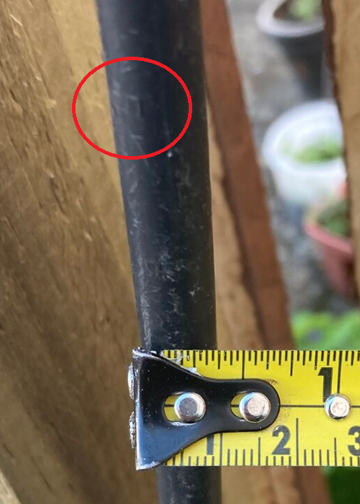

Have a look to see if the size is embosed on the side, or look at the cores (if you are able to visually guage them)

In fact, the first one I looked at says 12.17mm. Given that SWA less that 1.5mm² seems rare (does it exist at all?) I would guess that the cable (assuming that it IS SWA) must be 1.5mm² (and certainly no bigger) - and, if so, the house breaker protecting it would have to be reduced to less than 32A.
Indeed, even if it's not SWA, I doubt it is any bigger than 2.5mm², so the 32A breaker would still be too high a rating.
I reckon it looks more like NYY and with the parallax in the picture could potentially be 3C 1.5 or 2.5mm²
Is that a 5 I see or baSec?
If it was a 2.5 feeding one double socket it would be the equivalent of an unfused spur. Otherwise the MCB would have to be changed.
