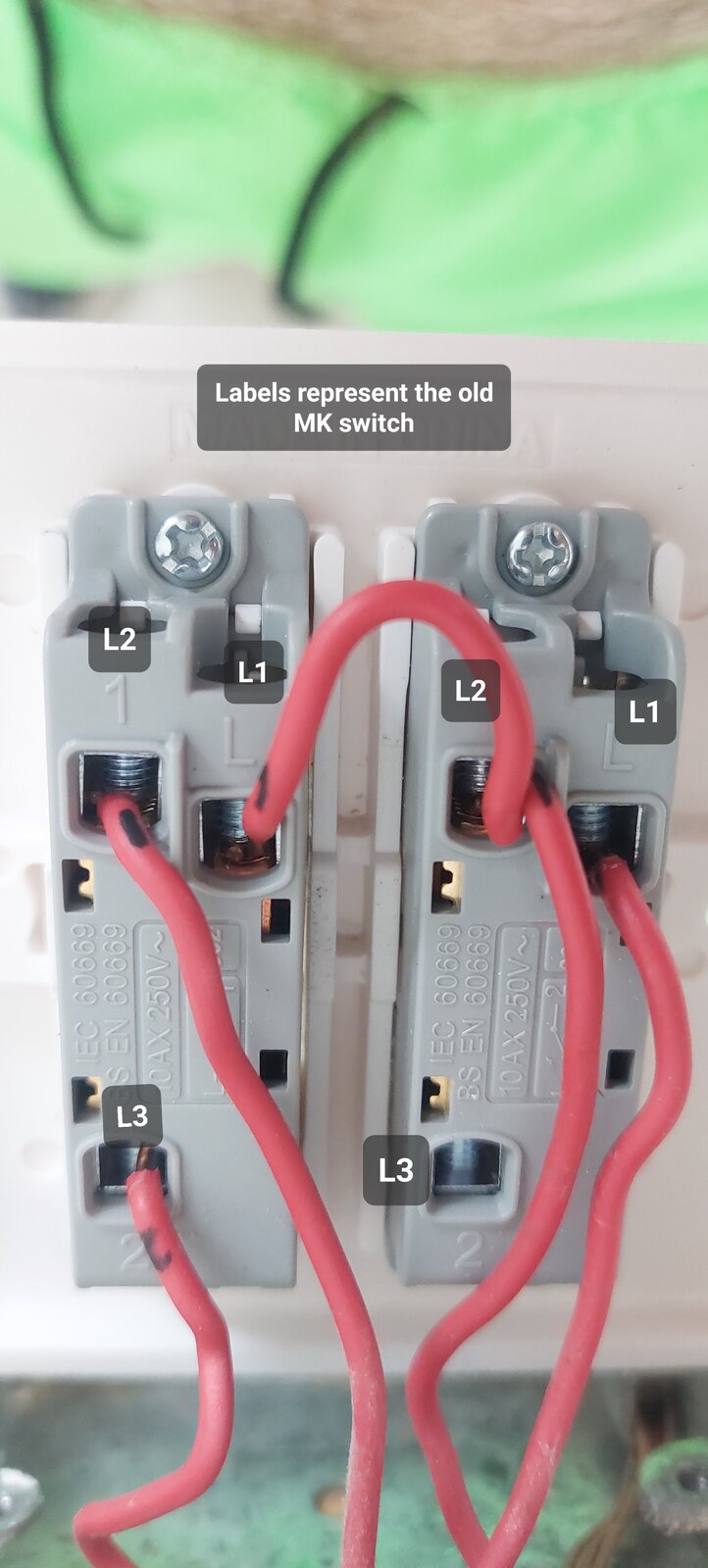

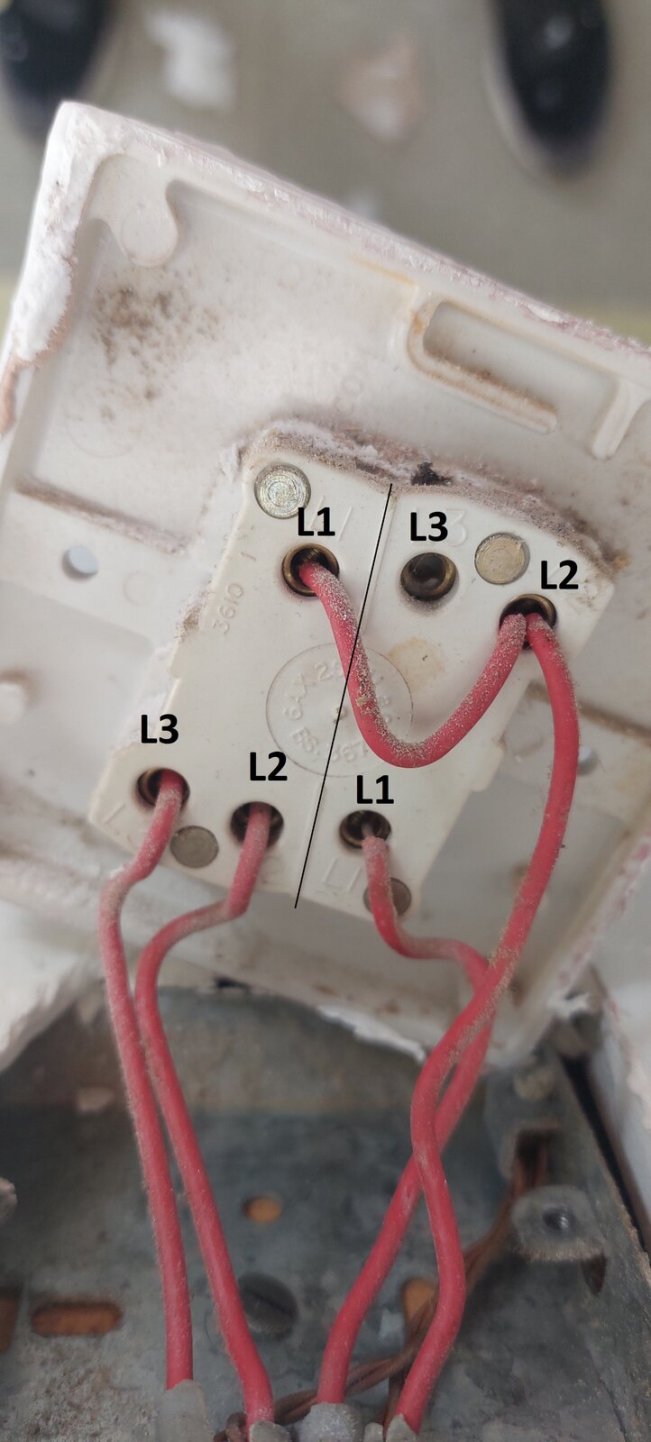

Hello All,
Can anyone help please?
I am trying to replace this old Crabtree double light switch.
The left hand side looking at the image controls the ceiling light. This light can also be turned on/off from a light switch at the other end of the room. The right hand side in the image controls a wall lamp.

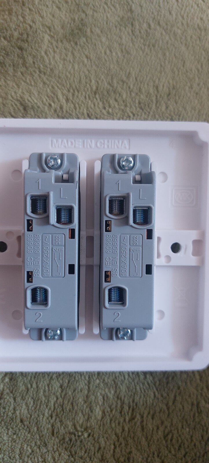

This is the new double 2 way switch I have bought (MK)
How should I wire this please?
Thank you in advance
L1 = L
L2 = 1
L3 = 2
You might think on the old right hand side switch that the wires in L1 & L2 are the wrong way round.
They sort of are but it makes no difference with the switch only being used as a one-way (off/on).
If you find a switch is working "upside down" then swap 1 & 2 (L2 & L3)

That new MK switch, it doesn't look like MK from the back and says made in China as far as I know MK made (final assembly( in the UK with some parts from mayalasia. Where did you buy it from?
Yes, it weird seeing MK stuff not made in England.
Could the Made In China MK stuff possibly be the new MK Base budget line?
Don't ask me, I don't use it.
(Incidentally, the old switch is NOT MK, it's Crabtree.)
shows a MK base switch next to a MK logic plus switch. The back OPs switch looks very much like the MK base switch.
Hello,
Thank you for all the help and comments. Fitted the switch. Working perfectly.
Switch was bought from Screwfix. It does say MK just to the right of the 'Made in China' bit and it is MK Base.

Hello again,
Sparkwright, you are correct! Crabtree.
It was my other socket that was MK.
Thank you

Hi,
Sorry, this may be an optical illusion and I could be completely wrong :), but the two wires in (L2) and the one in (L3), don't look as if they have been captured properly by the screw terminals (they may have slipped up the sides?).
Did you double check the connections after the photo was taken?
Hello,
Thank you. I did reseat those wires before I put the switch back in place. They were in tight, but down the side of the screw. Managed (wasn't easy) to get them under the screw.
Probably should have taken the picture after I'd done that.
