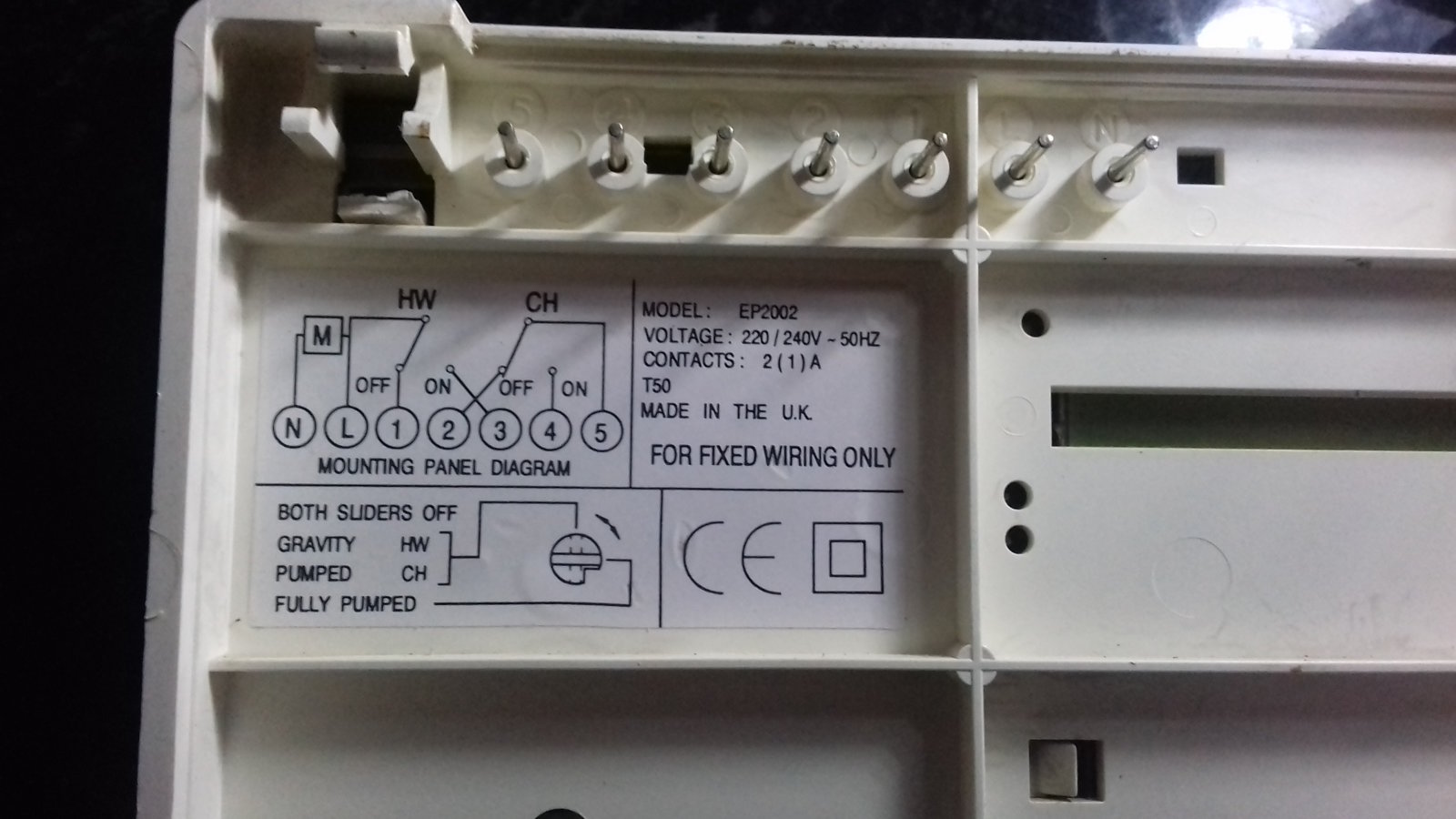

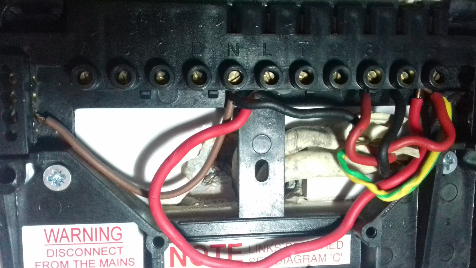

Ok - Posted a pic of the Potterton wiring diagram and a better pic of how the guy that installed it had wired it up.

OK, thanks for the photo's you have all the information you need from those diagrams. So, it's just a matter of determining the function of each wire from its connection at the EP2002, and moving it to the terminal at the Drayton that has the same function, as follows:
Remove the link between the EP2002 L and terminal 5. The remaining red wire in terminal 5 is the Live = L at the Drayton
Black wire in N EP2002 = N at the Drayton
Red wire in 3 EP2002 (Hot water on) = Drayton terminal 3 (Hot water on)
Black wire in 4 EP2002 (Heating on) = Drayton terminal 4 (Heating on)
Stem - many thanks for all your help on this. Changed it over last night and really easy to follow your instructions. For the first time since we bought the house, we woke up this morning with the heating on! Thanks again
