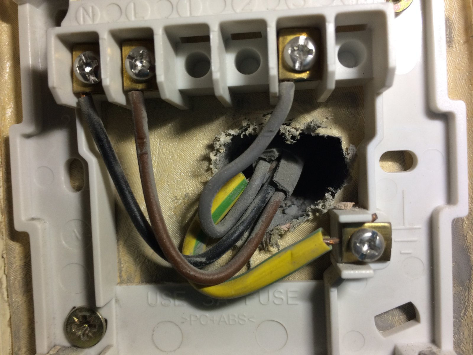

My existing stat looks like this. Can anyone tell me how I should replace it with a DT90E1012?
GetAttachmentThumbnail
