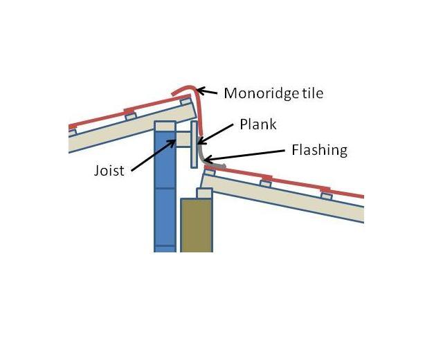

I need to replace the roof on my extension, at the same time raise it slightly to get a full size door and frame in, and get a better slope (currently tiles over felt on a 15deg slope).
The top of the roof forms an apex with a similar structure next door sharing a party wall. Although they have worse roof problems than me, unfortunately they are not in a position to fix it yet so I have to go it alone.
I can see a way of lifting the roof by building up the wall on my side, but this gives me a problem wrt joining with the neighbours roof. Although not to scale I hope the picture is clear. How can I waterproof the gap shown in green?
I wondered about putting a joist along the top of the new wall, fixing timber to it to make up the gap and then using lead flashing to seal to next door's roof (see second picture).
Any thoughts on this and/or alternative suggestions?
TIA
Mike
Looks like you already have it sussed out , thats how it should be done .
Just make sure your lead is covering 150mm down from the top of the tile and going up under the mono ridge 150mm too.
Dont forget to put a rubber washer behind your screw when you fix the monoridge.
Sounds about right,use code 4 lead and in sections no longer than 1.5m.Unless you want white stains on next doors roof tiles apply pattination oil to finished lead work immediatly after fitting.

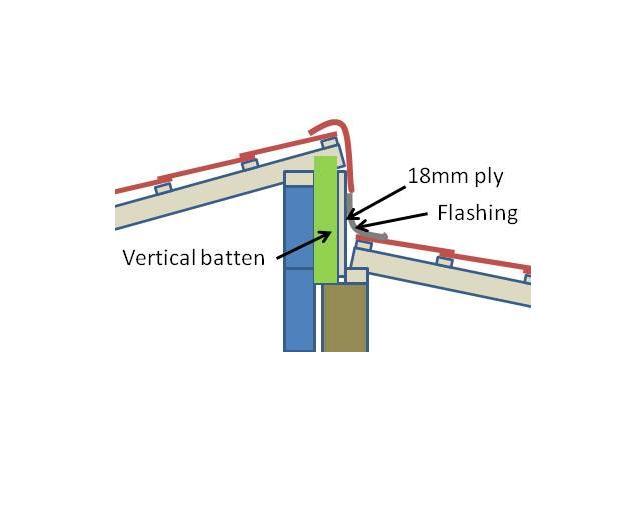

Your remedy looks ok but the position of the 'joist' as you call it (pole plate) looks suspect. You are showing it fixed to the uppermost point of the top course of blocks which may not be a good idea due to strength.
I would be inclined to fix vertical battens that fix lower down the blockwork and up into the rafter ends, or even into the wall plate. Also i would add insulation between the battens before fixing 18mm ply instead of a timber plank then fix your flashing to the ply.
The insulation suggestion may only be relevant if the internal space adjacent is habitable and not loft space, as to avoid cold bridging.
Do you mean like this?
The internal space is habitable (not a loft space) so the insulation and ply is a good idea, but I can't guarantee getting good access for fixing vertical battens to the outside of the wall. I have secured the wall plate to the wall with 1m straps and the joists to the wall plate with truss clips- is this not sufficient?
Please forgive the terminology used - I've not come across 'pole plate' before, but having looked up the definition, my 'joist' is only there to support the plank/ply and the flashing, not the roof structure itself. Does this change your thoughts ref need for vertical battens?

My reference to strength was regarding the weakness in the uppermost course of blocks and the likelihood that you may dislodge them and not in the pole plate itself. ;)
