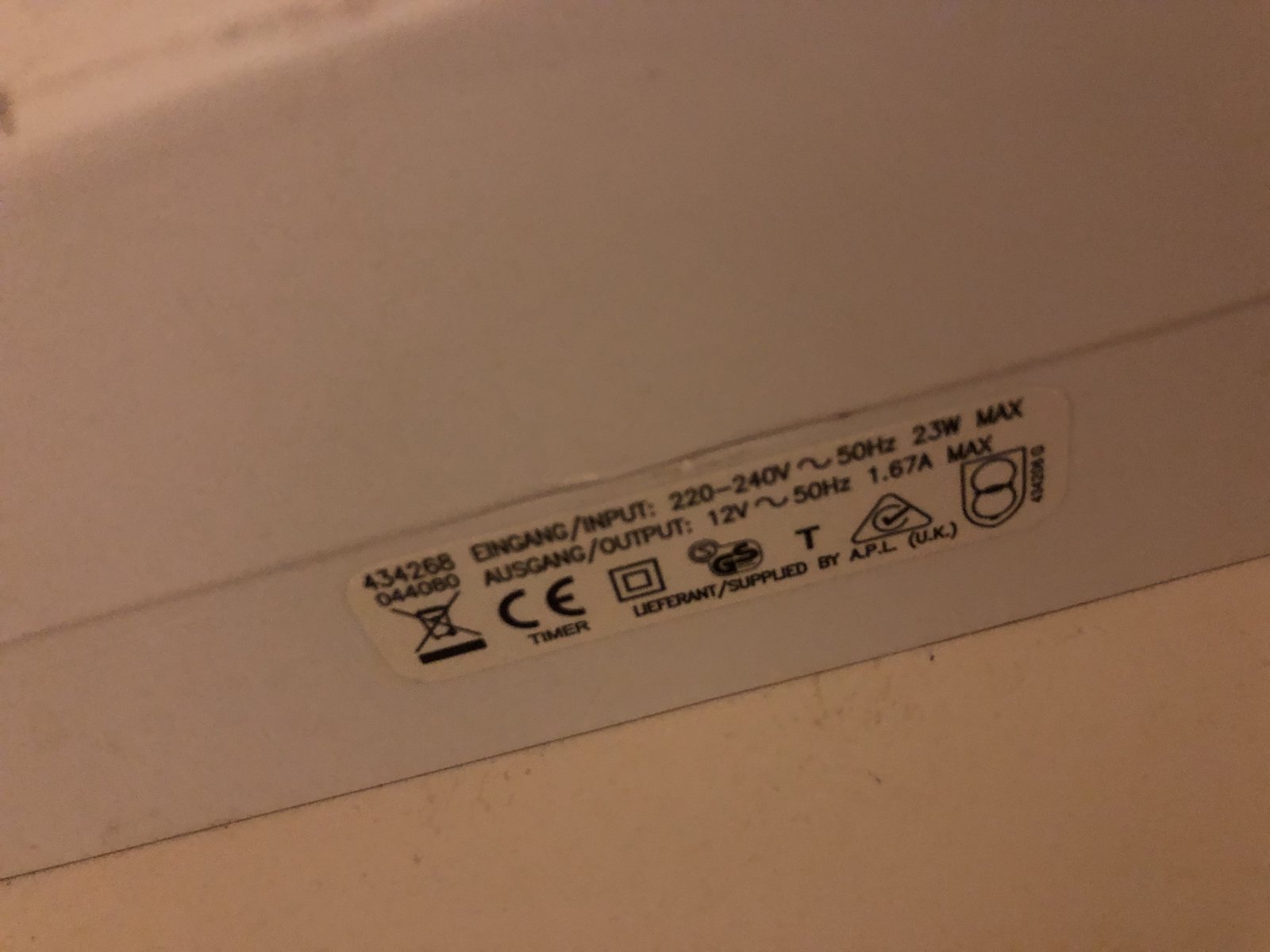

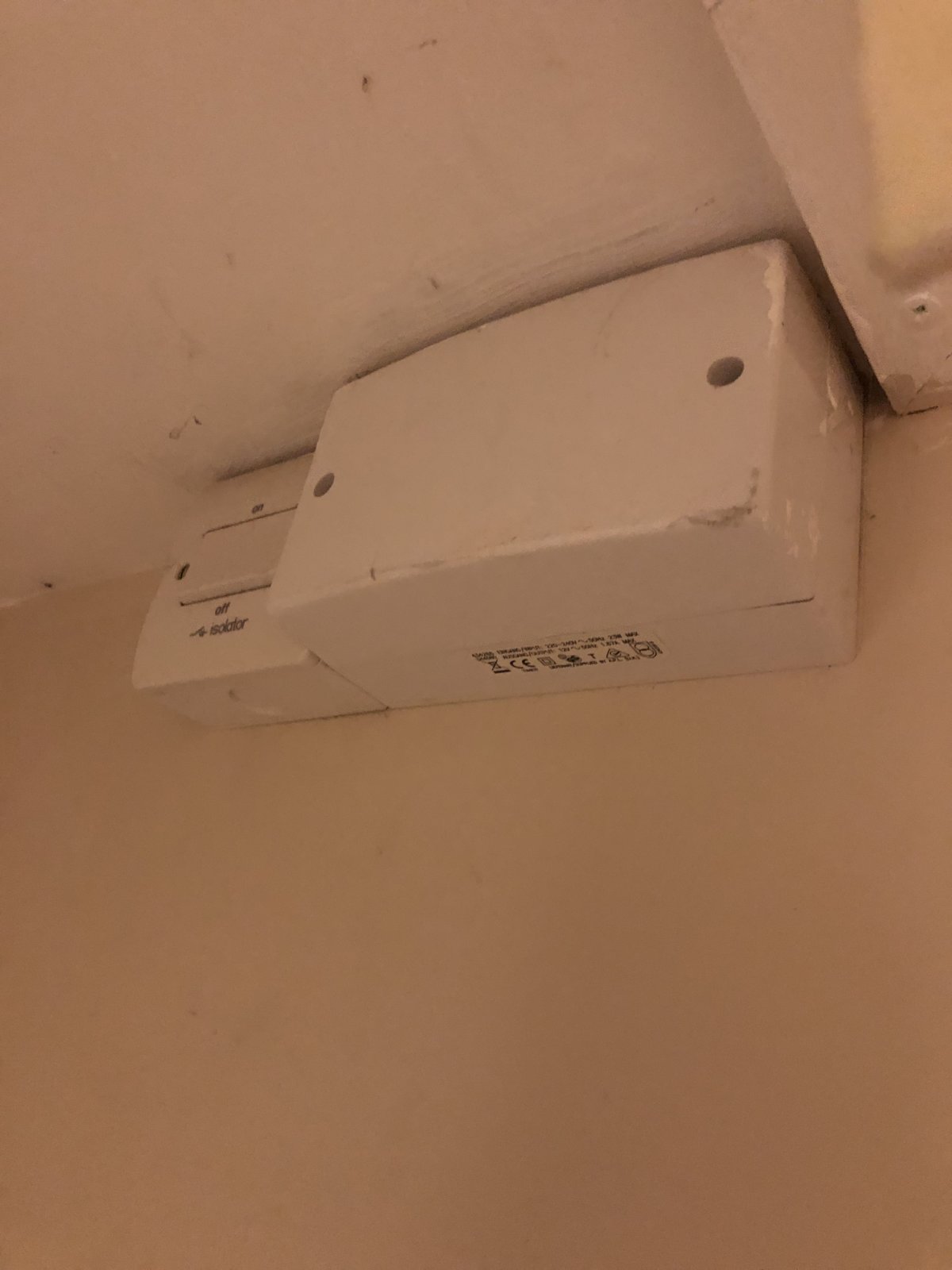

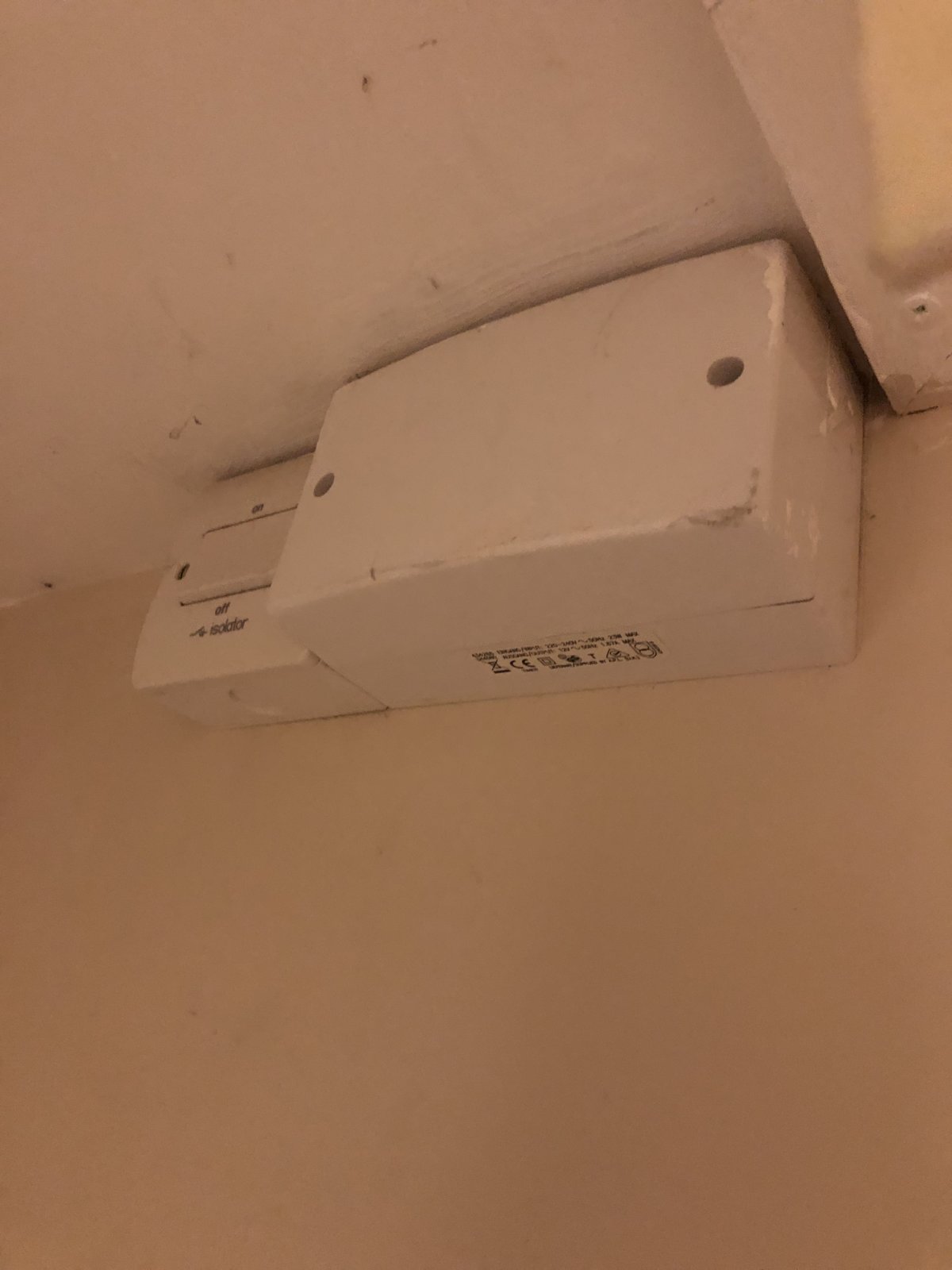

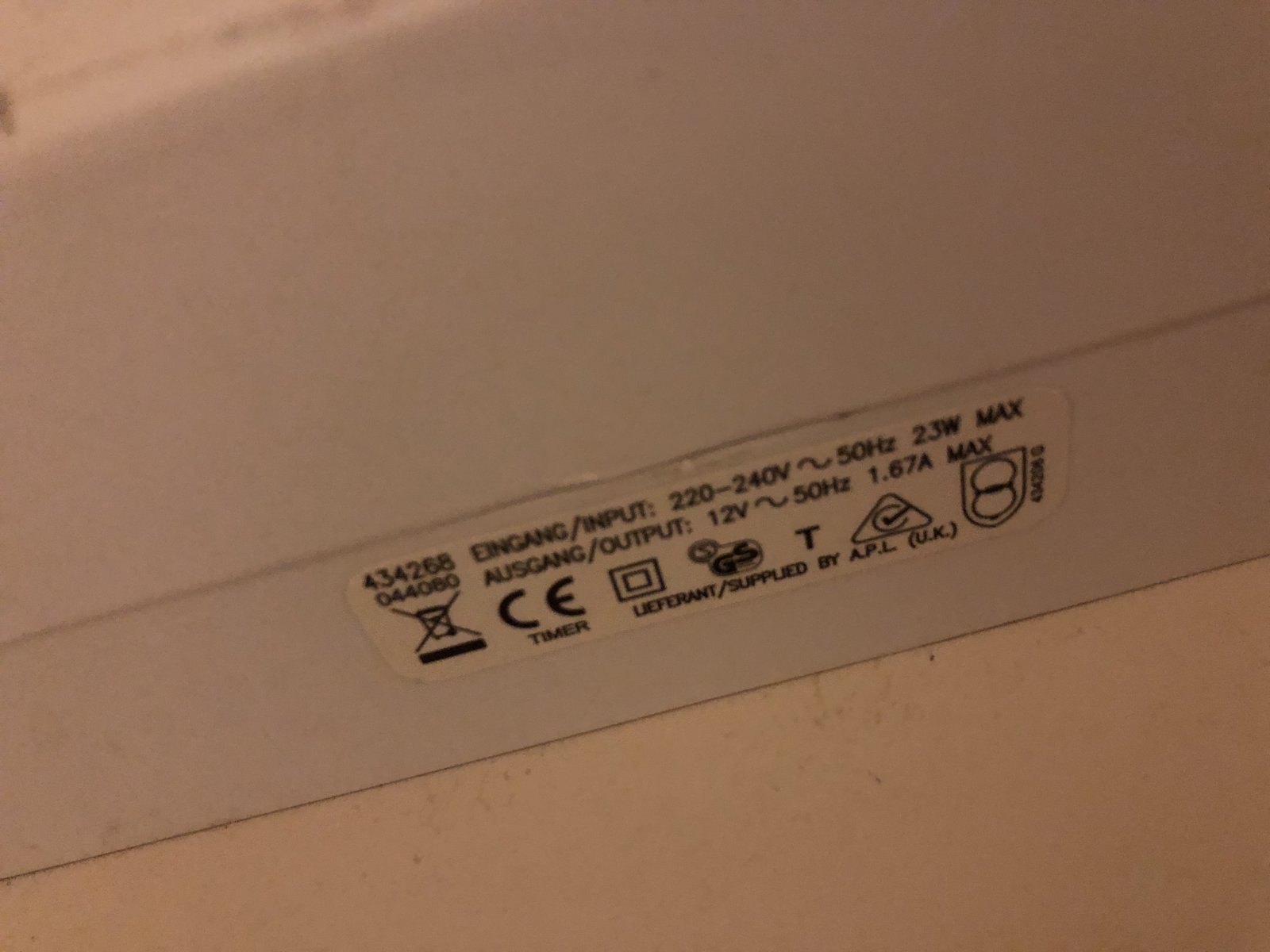

Hi thanks, for this the airflow fans look very nice but sadly outside my budget. I believe the fan is zone 1. There is a transformer outside the bathroom which the Electrician fitted when I moved in.
I may just get this https://www.blauberg.co.uk/en/100mm...xtractor-fan-bathroom-kitchen-wet-shower-room as it has a mesh.
Do these kinds of fans worth with any (my) transformer? ( I will have to try to work out what model it is but i guess that might not be easy).
