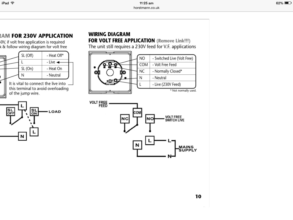

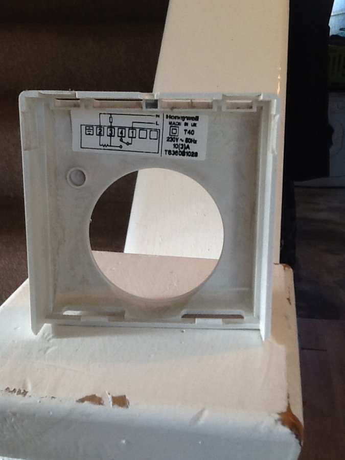

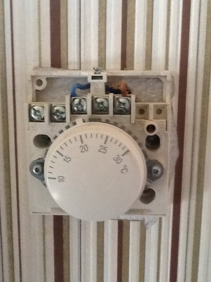

I would like to replace my old analogue thermostat with a wireless one. The new one will be a Horstmann HRFS1 Programmable Room Thermostat. Looking at the wiring instructions, I am unsure whether I need to wire it is a volt free thermostat or not. I have attached the pics of the old configuration and model. My boiler is a vaillant ecotek plus 832 R1 condensing combination boiler.

We cannot tell from the pictures.
How many volts at the brown wire?
Volt-free just means independent of (not connected to) the supply.
You can do either with the HRFS1 so just connect the relevant wires to the volt-free connections plus the supply and it will be alright.
Thank you for your reply, EFLImpudence. How would I be able to tell the voltage at the brown wire? I would assume it is the standard 230 volts?
Presumably then, the two wires visible are the neutral and live feed. Do I need another connection for the the volt free feed (as in the attached schematic)?

One more thing, on the inside of the Honeywell casing, it shows 230 V~50 Hz. Would this indicate the voltage in the live wire?
You would need at least a multimeter.
Probably but some boilers use 24V.
No. It is live and switched live - it is a switch.
No you need an additional mains supply to power the receiver.
No. That is the mains supply to make it work.
You cannot, nor would want to, fit the receiver at the present thermostat location.
It will have to go near the boiler or wiring centre (if one).
The existing wiring to the thermostat is then redundant.
If you don't want to do this then you can buy battery operated programmer/thermostats which would just replace the present thermostat (if the system is suitable).
