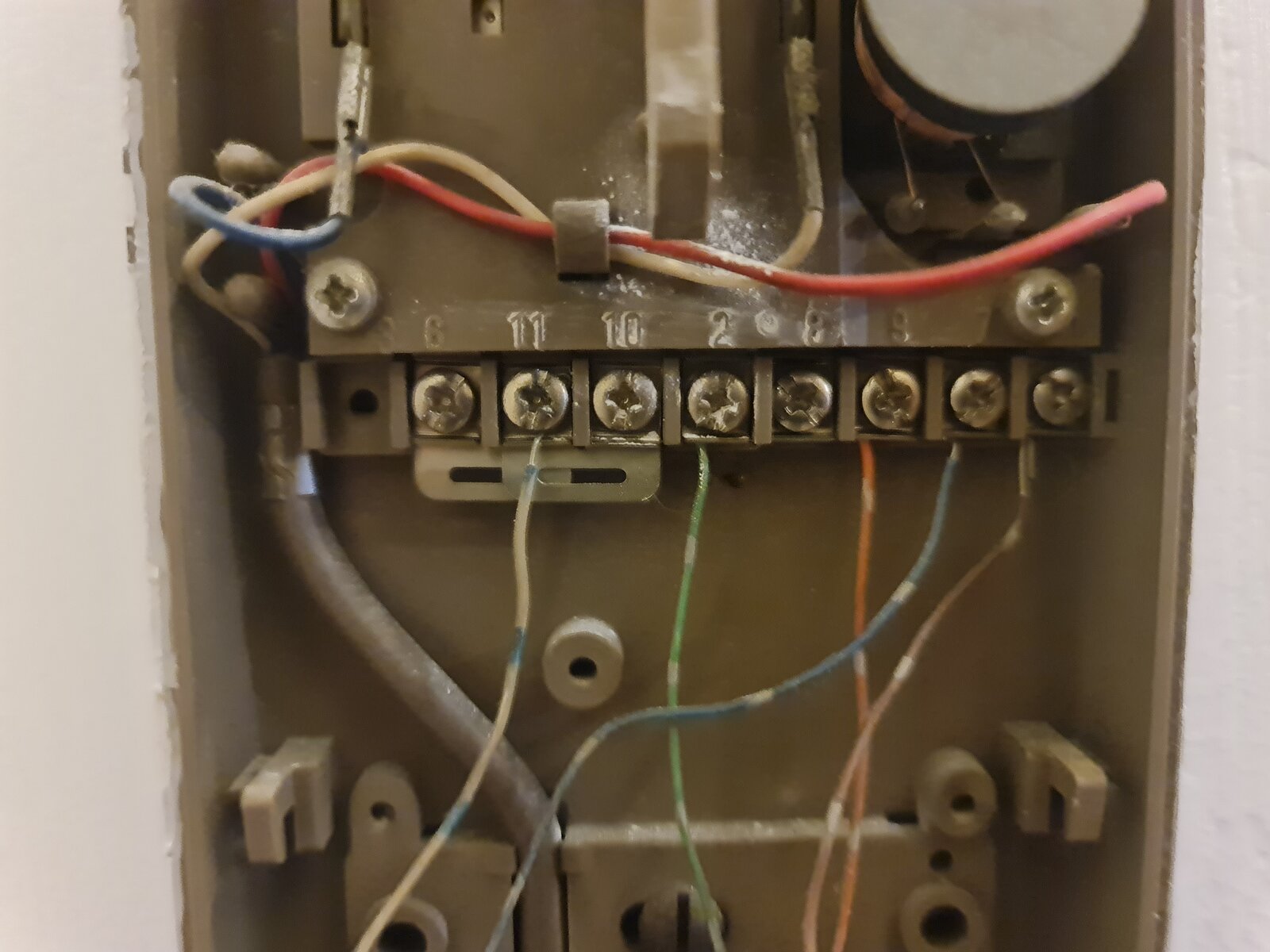

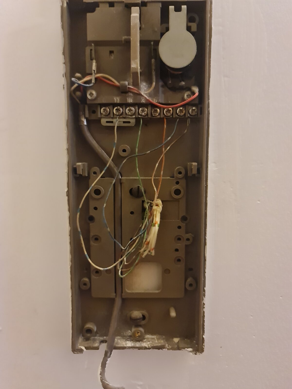

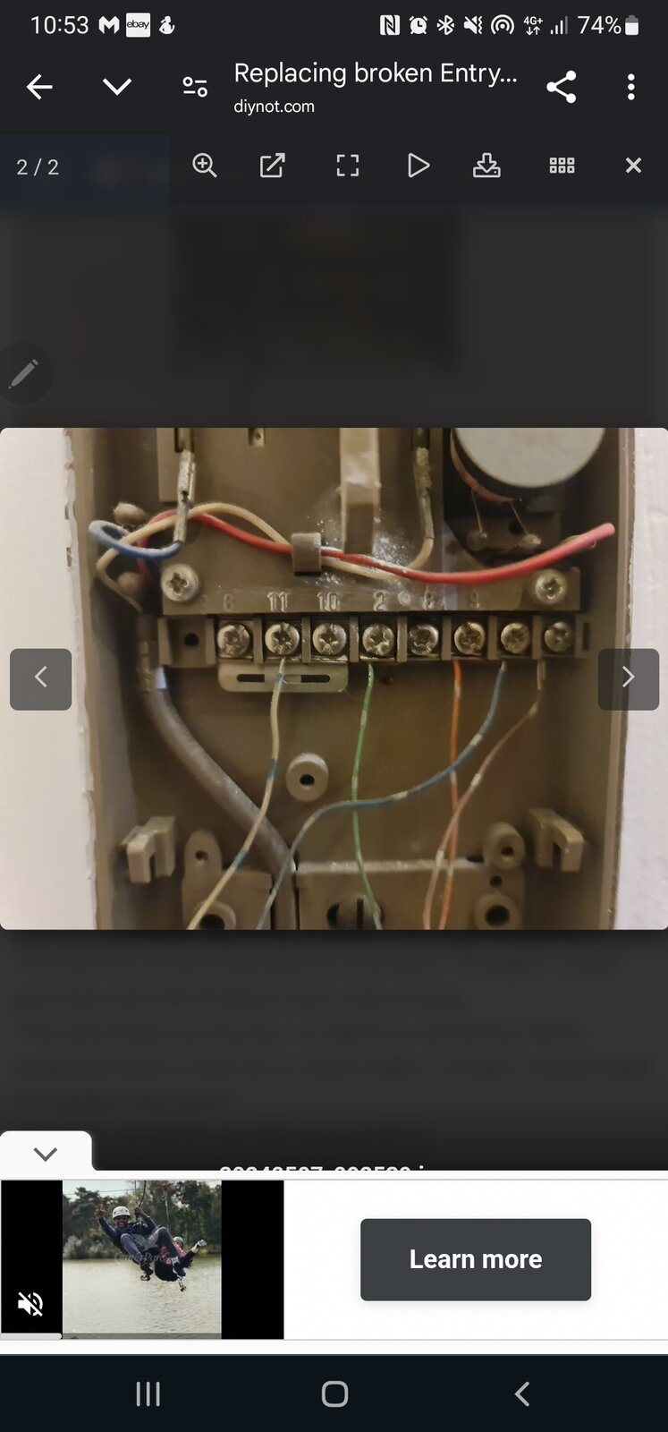

The buzzer in my entry phone is broken. Thought I could just buy one off Amazon, but I was wrong.
The old phone us anciist, no labels or branding. Does anybody have a clue as to what make / model I would need to replace this with?
Any help would be greatly appreciated.

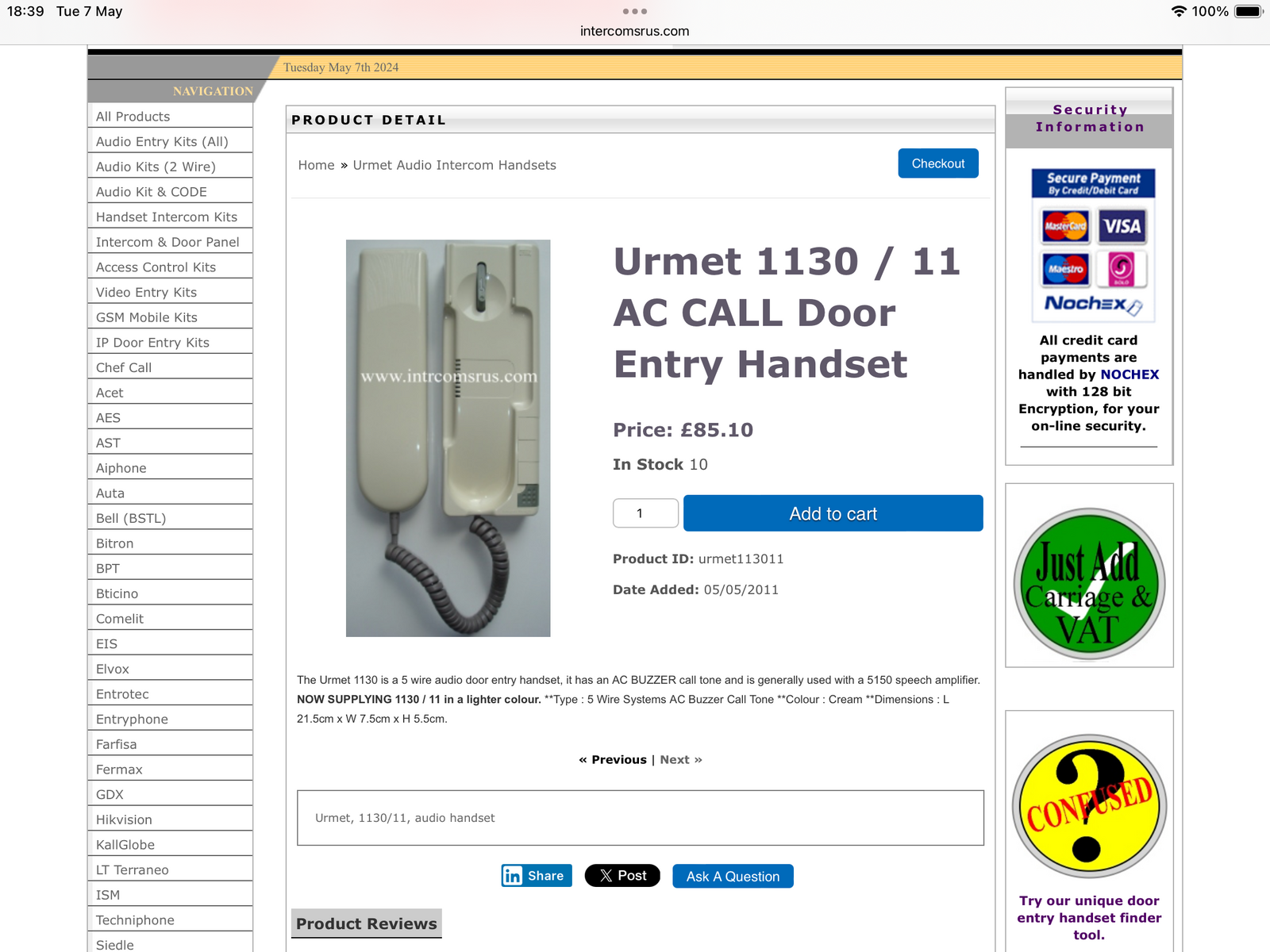

This is the replacement ….look on intercomsrus….really good site to find out what handset you have and if or what is the replacement …

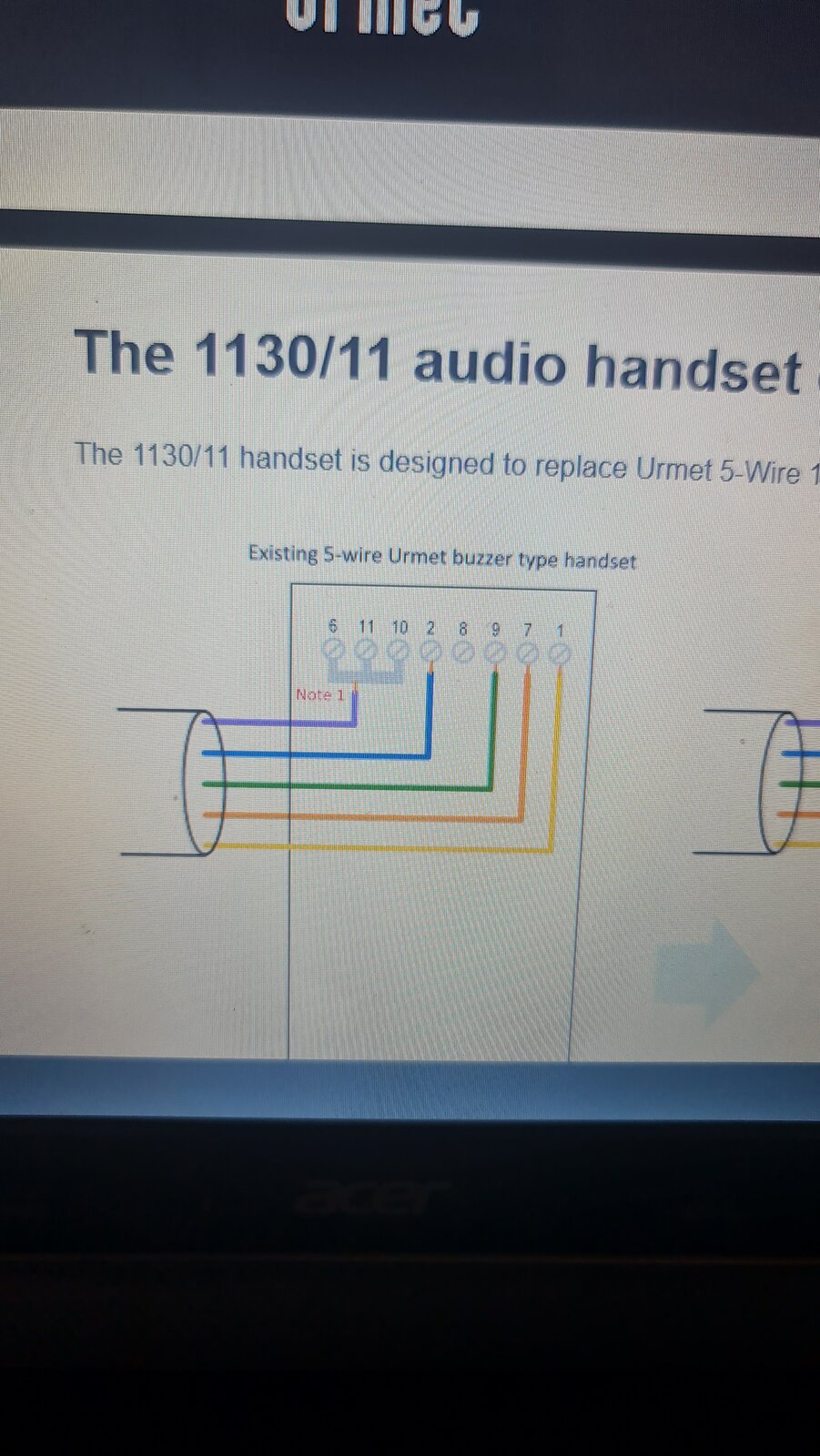

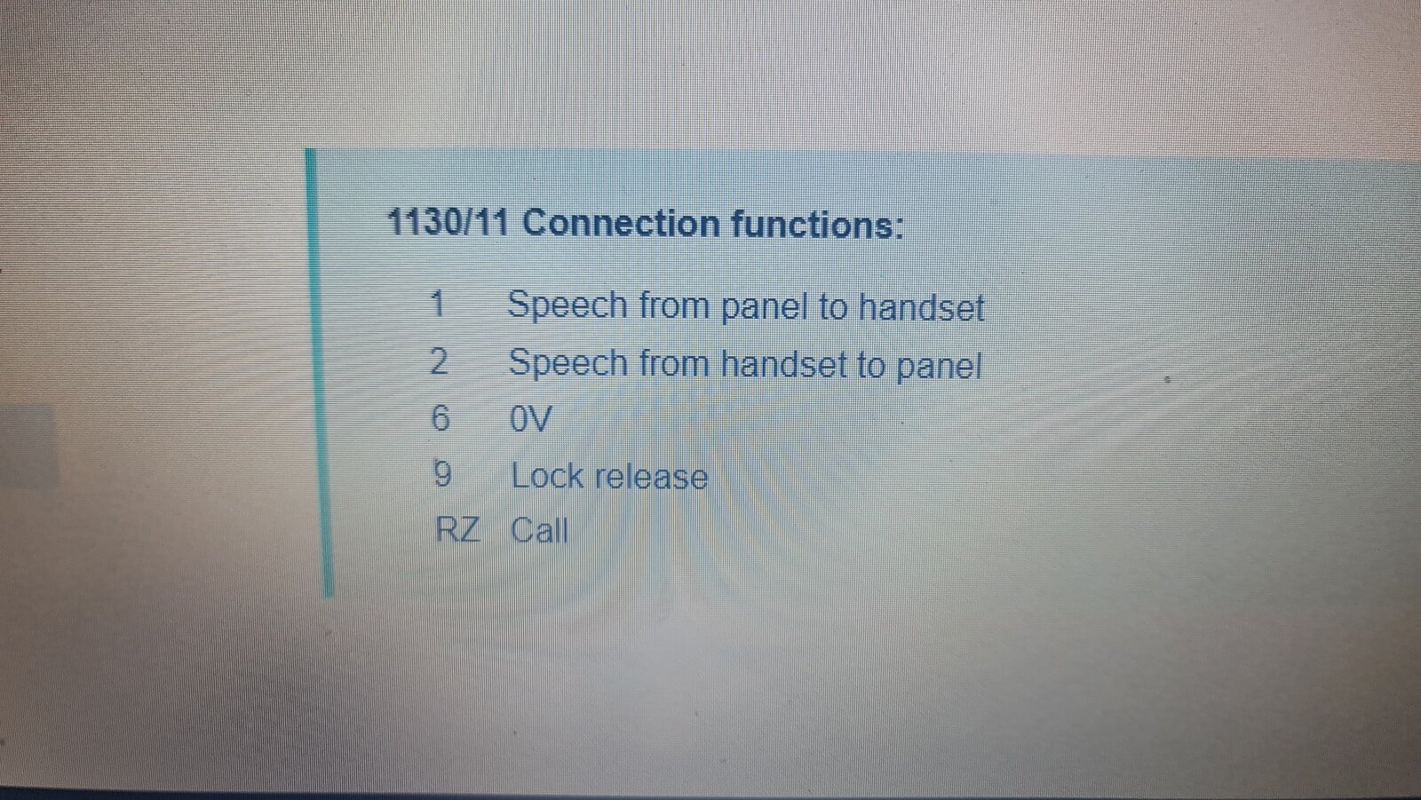

sparkymarka:
At a guess, it’s an Urmet 730/1030/1130 handset ….
Yes, it looks like that might be the one. Do you know if there is an affordable modern unit can i easily replace it with? (Small wires to same numbered connectors preferably)
Appreciate the link you sent, but £85 and a horrible beige colour is not appealing

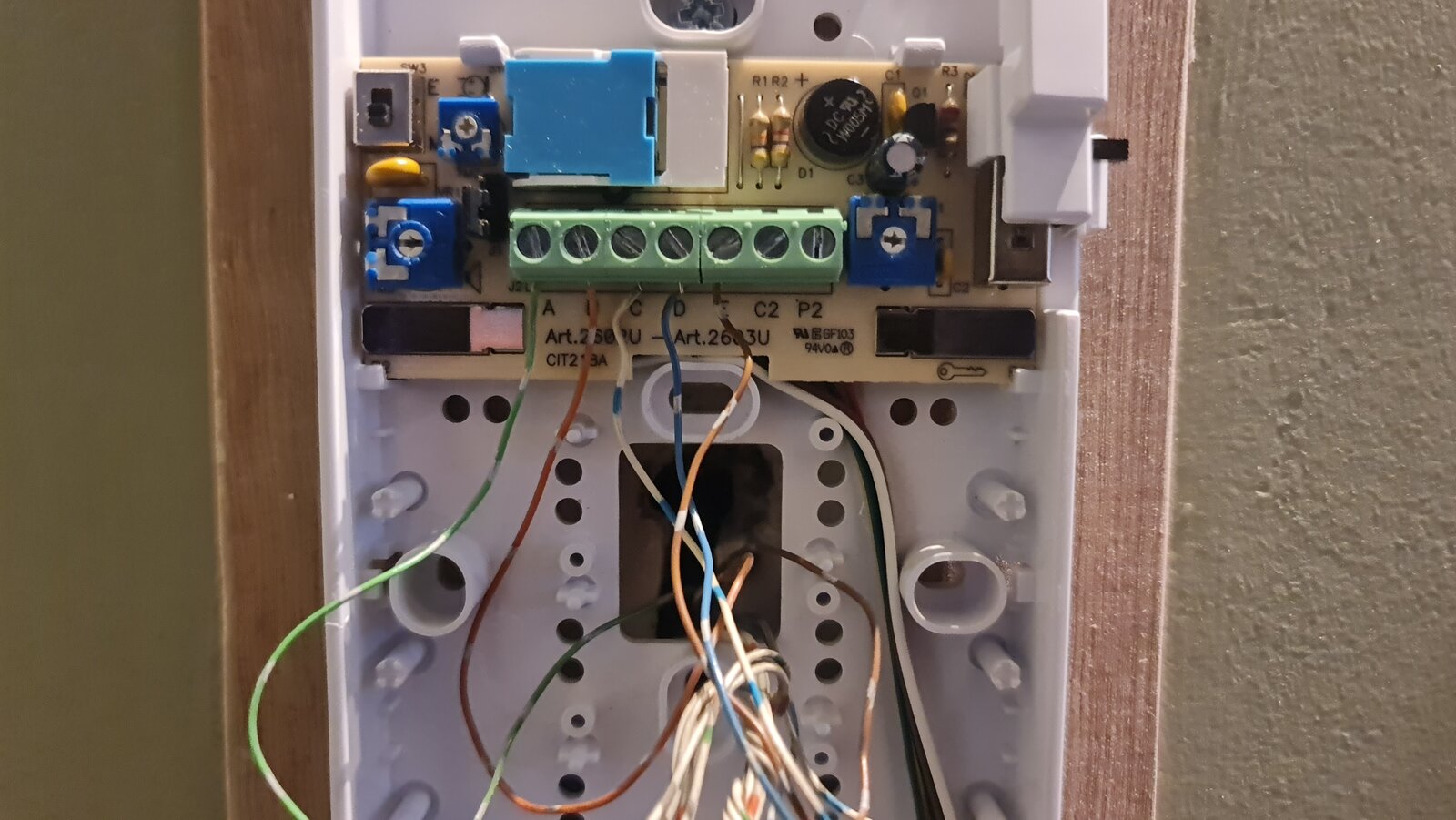

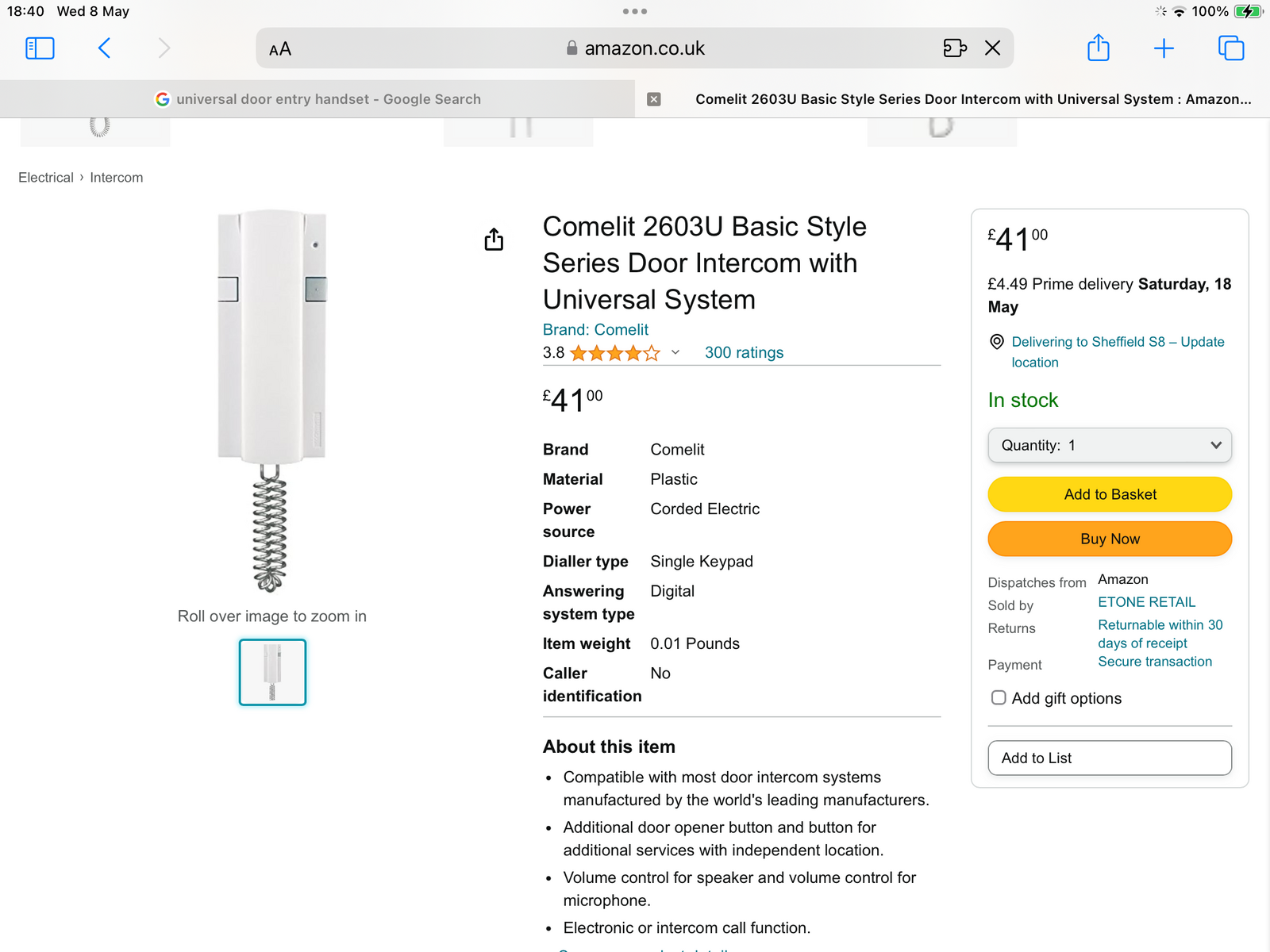

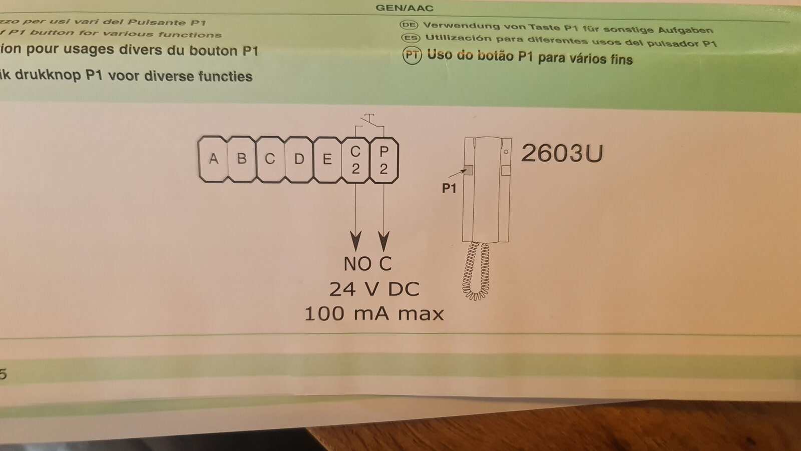

Personally I would go for a universal handset as they have separate mic and speaker adjusters inside the handset ….i have used the comelit one before ….see below anything else is a trial and error
sparkymarka:
Personally I would go for a universal handset as they have separate mic and speaker adjusters inside the handset ….i have used the Comelit one before … see below anything else is a trial and error
Youre a hero, thanks for your help, very much appreciated
