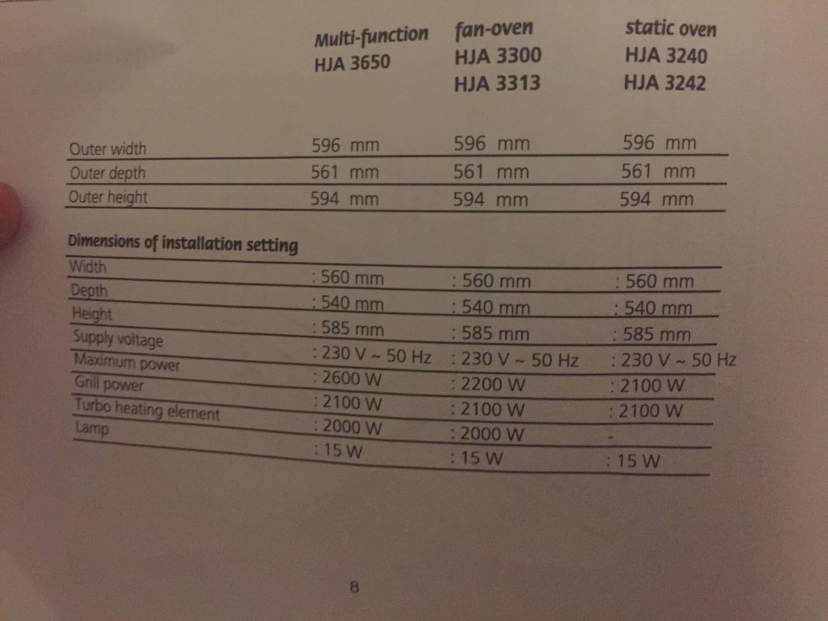

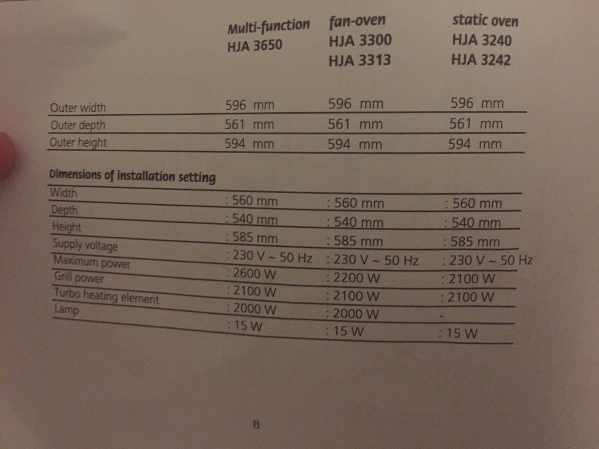

I am having trouble replacing my electric oven that has finally gone and needs replacing, I think I am right in saying its a built in oven as it fits under my worktop where the gas hob is and between my kitchen units slightly off the ground. I'm looking to purchase at John Lewis as I have vouchers but as its just a maisonette I live and will be moving soon I do not want to spend too much. the specifications to the oven needed replacing is:
Howdens/Lamona Electric signle fan oven HJA 3300
outer width - 560mm
outer depth - 561mm
outer height - 594mm
Dimensions of installation settings
Width 560mm
Depth 540mm
Height 585mm
Out of both measurements from the manual am not sure which one I should be looking at when shopping for a replacement. Also are all standard electric single fan ovens the same size? cant find an oven the exact size as this or does this matter? would it still fit in to where I need it?
Can anyone recommend a replacement in the £150-£200 mark from John Lewis or answer any other questions I will be forever grateful.

The vast majority of single ovens are the same size, typically 600x600 give or take a few mm.
The only possible problem is the depth, some are deeper than others. A very deep oven may be a problem depending on exactly where the gas pipe for the hob is located.
At under £200 you are looking at the very bottom end of the market, it really won't matter which one you get.
The existing Lamona thing is similar, typically given 'free' when buying a Howdens kitchen.
We just want a basic single electric oven that cooks/bakes well for the next 2-3 years that's why we are not wanting to break the bank, so looking at ovens I can buy any single fan electric oven? or best to try match the depth? I have found lamonas ovens really bad! it was fitting in when we purchased the place last year.
