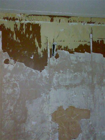

Hi all,
I had a lovely surprise yesterday afternoon when I was steaming some paint off a wall in our lounge. When I moved the steamer across a hole drilled by the previous owners it started to spark and cackle so I immediately knew what was wrong and turned the mains off.
Basically the previous owners left me a nice present to find which was that had drilled through an existing electricity cable running down to sockets. Even though I turned the mains off it still banged and sh!t the life out of me.
I chiselled away at the wall to reveal the exposed (and now burnt) cable, stripped it back and put a couple of choc blocks on to terminate it just so I could get the power back on. (I understand that it's effectively no longer a "ring" but I'm making sure I'm only drawing the minimal amount of power possible - this is okay isn't it?)
My dilemma is how to repair it with the minimal amount of fuss and mess. I have uploaded a couple of photos to show the current state of affairs. The options as I see it are as follows but please bear in mind that it was running in plastic conduit with the other cable from the ring mains and the conduit is located directly next to more conduit so it's pretty tight around there!
1) Take up the floorboards in the room above and replace the whole length of cable. The problem with this is that we have just recently done the room above and don't particularly want to go ripping up the carpeat, etc. The missus will kill me! :(
2) Get a sparky to crimp a new section of wire from the hole in the wall down to the socket. I do not mind paying for this at all as long as the crimped wire will fit back in the conduit? It seems pretty tight.

If you can draw in a new bit of cable from the socket to the hole then your have 2 x ends that could be easily tterminated via crimping and sleeve.
Failing that your end up with a strap of cabel betwen the two points which again should be terminated via crimps.
ideally it would be best to replace the full length of cable, but thta is unlikely to be practical.

You could get it crimped and sleeved with heat shrink and then you wouldn't need conduit, just be carefull with the filler knife and turn the circuit off when you do it!
Your pictures don't show if there is a socket at the bottom of the cable drop - there needs to be one in order that the cable is running in a safe zone and hence you'd know not to drill there (like the previous owner - NOT!)

It's definately conduit, not capping. I've had to break this open to actually get at the cable.
Round PVC? or oval?
Should be able to pull up and down in the conduit, best ide is to replace the cable fully, next best option is to pull it back into the floor void above, and crimp it and put it in a 'choc box' enclosure
I've terminated them for the time being, and worked out that as long as we only use one heavy appliance at any one time then we will come in under 20 amps total. This is safe for now isn't it?
If you do as you say, then the cable cannot be overloaded, but as it realies on people bearing in mind that things are not as they should be and acting accordingly, then its not foolproof and for what it would take to bang 6' of 2.5 cable in there....
I have noticed that the previous owners may have drilled into it further down
I'd just chip the plaster away where you suspect the damage to be, if it isn't, then I'd leave the plaster on the rest of it and just draw through new cable
