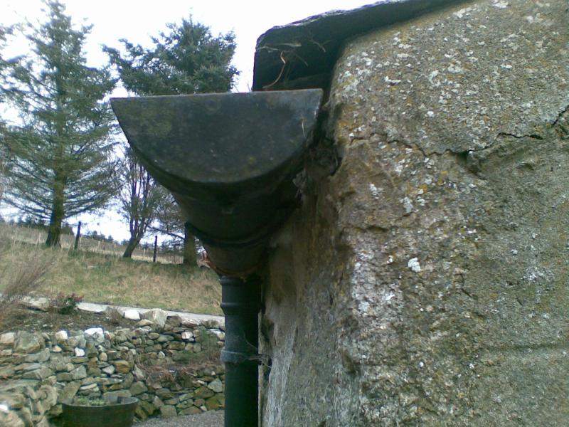

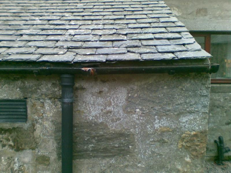

Hi,
Just moved into a property that has Cast Iron Guttering. The brackets holding the gutters seem to disappear into the wall - at the point where the wall ends and the roof (slate tiles) begins. I'm trying to work out how I can get access to these brackets to remove them - since access to the roof space is not possible.
I want to get these old brackets off so that I can fit new brackets and guttering.
Any advice appreciated.

Thanks for the information. This is most helpful.
I have slate tiles - I've never lifted them or moved them before.
I'm not sure about the best way to remove these to get access to the gutter brackets (and of course put the tiles back again)
I'll see if I can upload a picture in a moment.

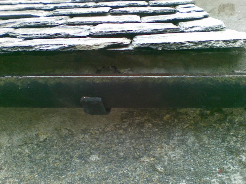

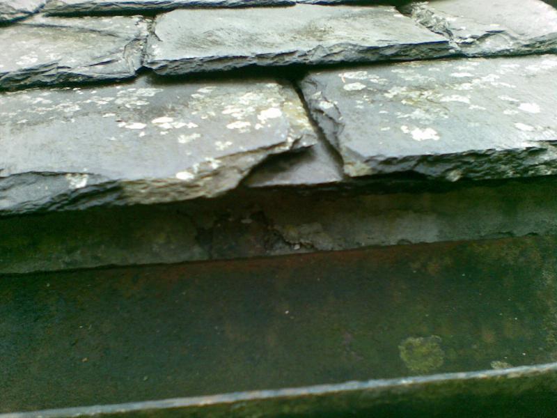

yes rhone hooks.4.5"
slide the slates above the hook 2nd course apart, then remove the slate below and possibly the undereave slate to gain access to the rhone hook.
remove the hook and replace.
replace the slates in the same positions they came from.
have some spare slates on standby in case of breakages.
try and refrain from stressing the gutter as this will break the putty joints.
