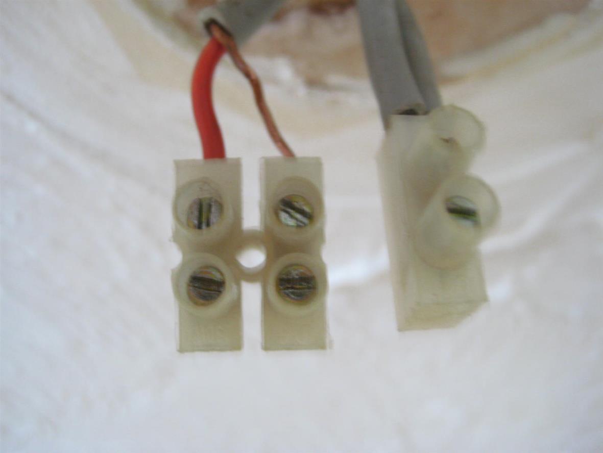

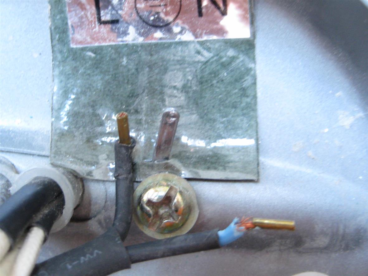

Hi I'm puzzled by this.
I am replacing a spotlight fitting with a standard ceiling pendant.
The connections on the old light fitting are like this.
The wires from the ceiling are like this.
The Red wire was connected to the wire marked live, the uninsulated wire to the neutral and the third blue wire shown at the bottom was connected to the two wires attached together in the choc block.
How should I wire this to the new ceiling rose?
I have never seen a light fitting with 3 wires!

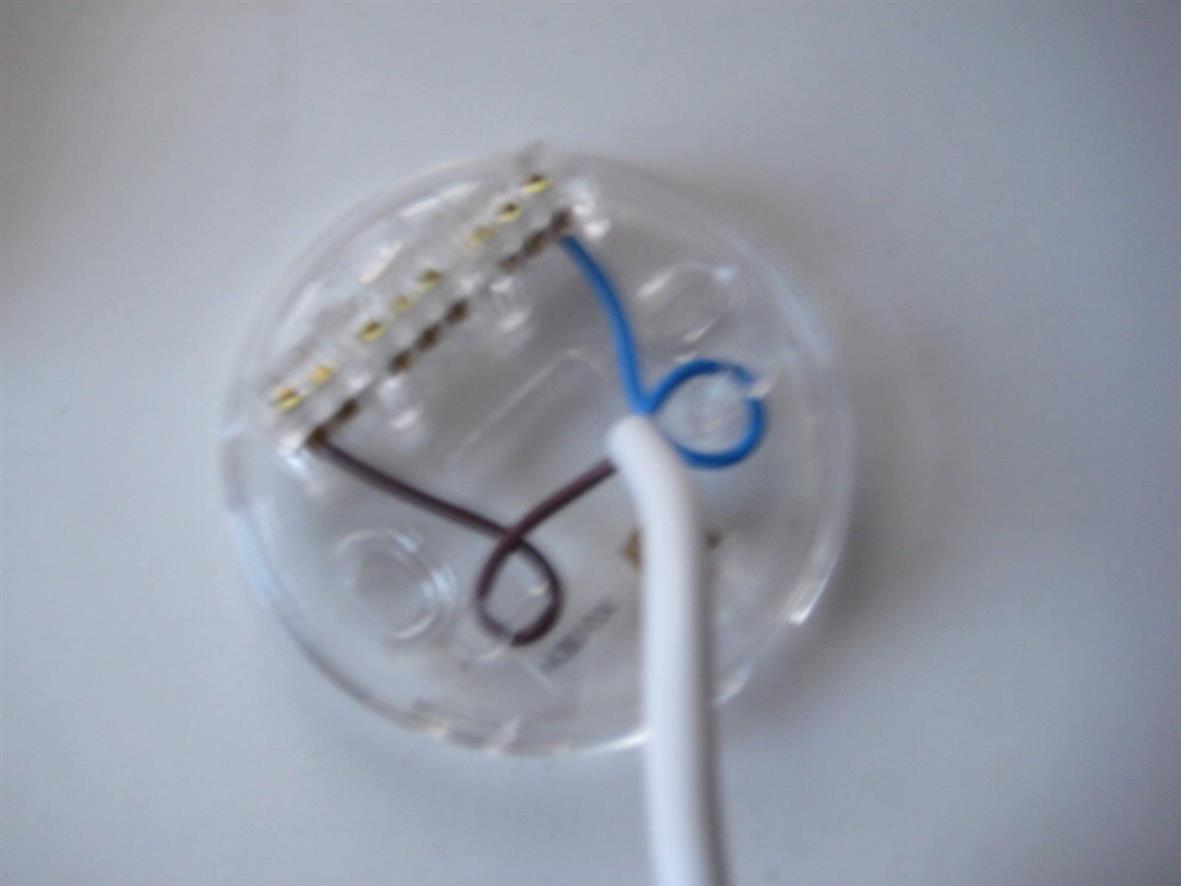

The 'official way'
I show the earth wire in bright green as it should be sleeved with green or green/yellow striped.
In your situation probably be easier to do this as the earth is not likely to be used and will reach better without stripping it back further
Hi Sunray thanks a lot.
Just to be sure, do you mean the uninsulated wire is the Earth? 'cos that was connected to the neutral terminal on the light fitting, so it was wired up incorrectly?
The live red wire from the ceiling hole goes to the brown positive block, the two connected together in the chock block go in the blue neutral block?
And the ininsulated wire goes in the common?
Yes, the bare wire, SHOULD be the earth. The puzzle is, why it might have been used instead/in place of the neutral.....
If that your final comment above, was correct, then either someone made a mistake, or there is a more serious issue needing investigation. Your questions suggest you would not be able to carry out that investigation.
You might, as a way to avoid that, first try connecting the ceiling rose as suggested by Sunray, and if it works, it should be fine, with no need for further investigation.

So ignoring all of this deviation, my advice is to follow whichever sketch in post #2 is easiest to execute.
I confirm the bare wire should be the earth wire, it should be insulated with sleeving, it should not have anything connected to it other than one of the connector in the sketches.
