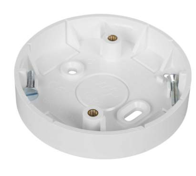

I'm wondering if it might be an option to fit something like this where the old ceiling rose used to be. To keep the new fitting flush (more or less) it could be sunk into the plasterboard and attached to the wooden batten. That way the connections don't have to be hidden in the ceiling void.
I think there will be room it. Although I suspect will need to be cut very carefully to avoid the cables that will be just above where it needs to go.
