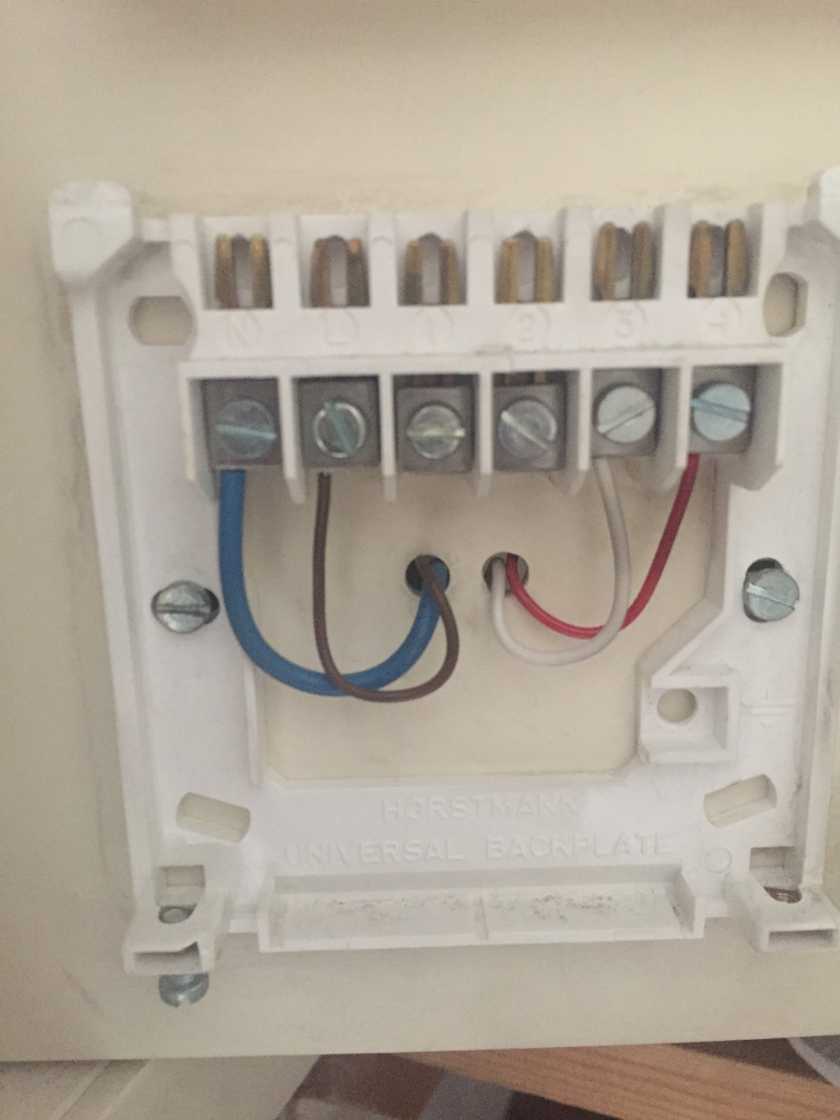

First, the regular backplate of the C21 programmer seemed simple, but I was puzzled by the fact it was thin (12v like) wires and not thick, 220V ones :

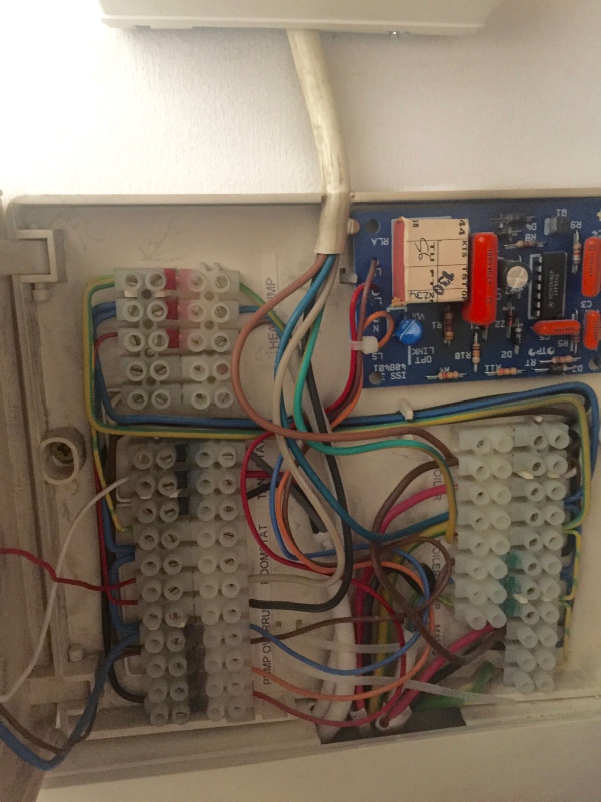

Then I opened the plate behind this backplate, and found this :
Which lost me a bit.
The white cable above the rest links to the Drayton SCR thermostat receiver, but I don't get what is the PCB circuit board doing inside?
Basically, I thought I would just link the two small red wires together on the left hand side to get rid of the thermostat, and use the backplate wiring to connect to the nest? Am I right or am I missing something?
Does this system talks to anyone?
Thanks a lot for your help, if anyone can shine a light on what does this spaghetti of internal wiring?
Will
That sounds fine, the PCB appears to be an overrun timer for a pump, but it looks as if it may not be in use.
The white cable will carry 240vac to the SCR receiver, this can be used to power the Nest receiver. The Nest receiver will replace the SCR.
The heating output of the Nest will go to the terminal that the SCR output previously went to, and it's HW output to the terminal that the old timer's HW went to.
Thus the SCR and old programmer are discarded.
If you can, run a SEPARATE 2 core cable fron the Nest (T1 & T2) terminals to the Nest thermostat, then you won't need to use that unsightly USB lead to power it.
PS The main drawback IMO of the Nest are the fiddly and small terminals. You'll be glad of those 0.5mm2 cores when you try to get 2 cores into one terminal!
PPS Mains cable does not have to be larger than 12v cable, eg the battery cables on a car are 12v, n'est pas? It's the current carried that mostly determines cable size, so check (and replace as necessary) there's a 3A fuse in the mains supply to the heating system.
MM

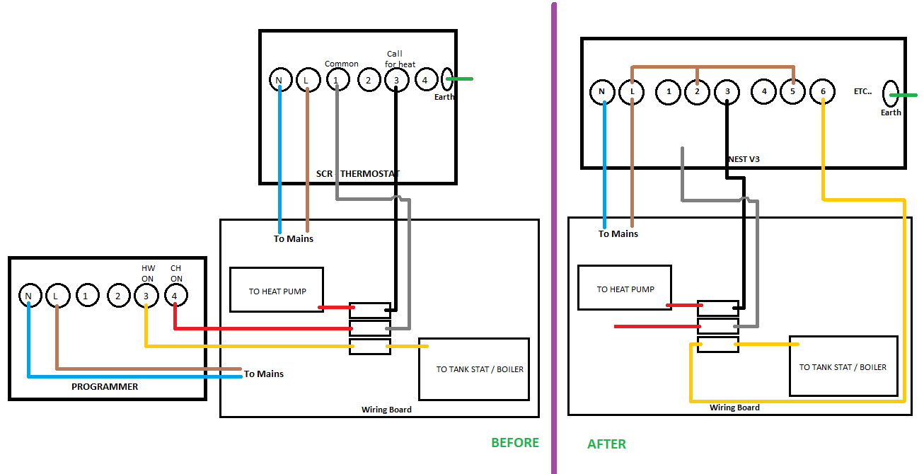

I've made a drawing of what it would look like if I was replacing the current system like for like. Does it looks right to you?
Thanks a lot for your pieces of advice!
Also, it looks like people with a similar setup to mine are using Hive, which supports gravity fed systems. Is it preferable, or only due to the fact that Nest didn't support HW until the v3 earlier this year?
Nest can support gravity hot water but the connections need to be wired a bit arse about face with extra links and so on. One of the problems with nest is that it is an American product and doesn't fully take into account how heating systems are wired here. Hive is more UK based, hence using the 'universal' backplate.
mmm... so I have the choice between Hive that is almost guaranteed to work with my system, but not as widely used and recognised as Nest, that will be more complicated to fit on my gravity system... what to do, what to do...
I couldn’t find any wiring plan or details about installing a nest on a gravity/semi pumped. Would you have any docs on this by any chance?
