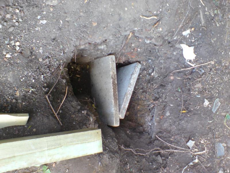

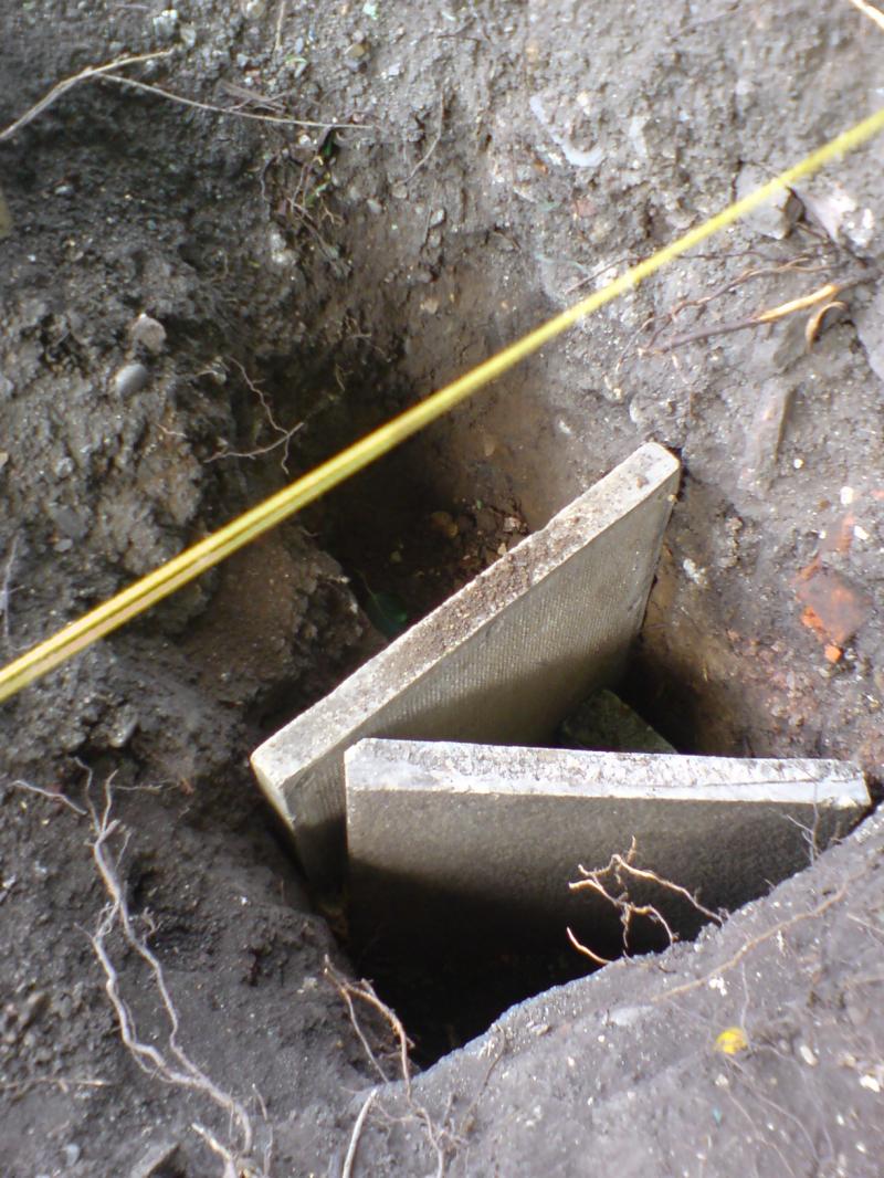

i will be using postcrete for the rest of the fencing (posts are 4"x4") , the posts hole will be just over 2ft deep . the instructions on postcrete(Hansons) says to place rubble/broken bricks around the base of post. how much of the hole do i need to fill with rubble so that the concrete sets at around ground level or can i add some at the same time as the mix as required.
this is all quite new to me and instructions are important! thanks

wabbitpoo, if i were to increase the depth of hole by 12" (from 2ft 6 to 3ft 6 and length of post by 12"(to 10ft), would that mean i could leave the concrete 12" below ground level so that less concrete is used and seen, i would still slope away from post but backfill with soil.
How do you dig the hole deeper yet use less concreat?

less concrete would be used as the diameter of the hole at ground level is around 3ft, go down 12" and the diameter is halved. But i agree i have received good advice but just trying to make the best of a bad situation.
i think my solution is o.k as i have just taken ground level down 1ft, but not sure if i want to take backand replace my 2.7m post with 3.m
its peanuts, are you really worried about the amount of concrete, its a few bags of ballast and some cement. not even a barrow load
No not worried about the cost of the extra concrete but the post stability . someone suggested digging deeper...might just be a better/tidier solution.

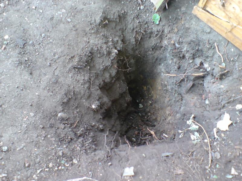

Decided to go for 3m post and deeper hole.
Due to the amount of concrete required- took best part of a day( even with a mixer, but must admit did chuck in a few bits of large rubble towards the end to save time!). Not sure yet how to backfill,
this newbie DIYer hopes it lasts a long time. (BTW thanks all for your contributions. very much appreciated!)
