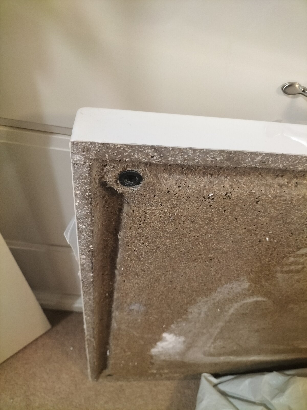

I was going to use a riser kit but I wouldn't work with the waste so I have built a platform on 4x2 and plywood
Will this kind of tray be ok on sand and cement
Sand and cement, flexi tile adhesive, silicone adhesive etc, lots of ways to set a tray. Primarily though it usually follows on the MI, if the warranty is to be maintained.
Is the main centre section of that stone resin tray level with the outside edge?
