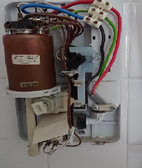

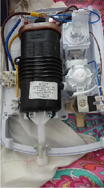

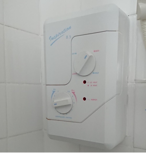

I have to replace a shower but the water inlet on old shower is bottom right and is connected with a 90 degree connector.
The new shower water inlet is bottom but point down, can anyone kind person advise best way to connect this up? Would a flexible hose suit this? what size would it need to be?

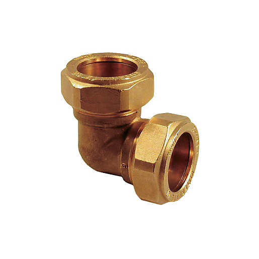

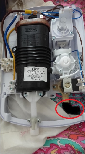

I would fit a 90 degree compression elbow to the inlet and then position it to the right, left, or behind as required. See my appalling sketch below:
Edit:
If all else fails, you could always refer to the instructions that came with it! :rolleyes:
there is a similar one on the old shower but I just thought the water pipe is running down wall behind rather than out of wall which would have made connecting a lot easier!!
