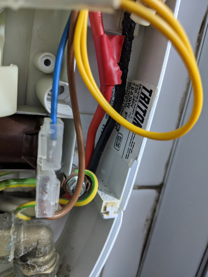

Hi all,
I have a Triton electric shower which was installed by someone else around a decade ago. It stopped working the other day so I opened the front cover to see if there is an obvious cause (I don't have much experience in this area).
Upon opening, it appears the main problem is the connection between the mains electric cable and the shower has burned/melted (see second pic). I know this is a serious safety issue and a fire risk. As you can see in the first pic, the shower power rating is 7.8-8.5kW.
I have a few questions to help me decide on what to do next:
  • I'm trying to understand how the burnout/melting happened, is it because a thicker electric cable is required?
  • How can I check what power my electricity supply can hold for the shower? I'd like to upgrade to a higher power shower if my current wiring/fuse can hold it.
Appreciate any guidance
The overheating was caused by a loose connection.
You will need to cut off the damaged cable and renew the connector block.
Whether a larger shower can be fitted depends on the cable size and fuse/MCB rating.

Dependant on Cable length from Consumer Unit , wether run surface or in Insulation etc etc , Circuit Breaker size
your existing Cable looks like 6.0mm T&E ( solid cpc) , you could stretch to maybe a 9.5kw Shower , but that would need a 40amp Breaker, though a 9.5kw shower pulls just over 41amps @ 230v / 39.5 Amps @ 240v
Not so.
At 230V it would be 8.7kW and 37.8A
The resistance of the element is the constant.
