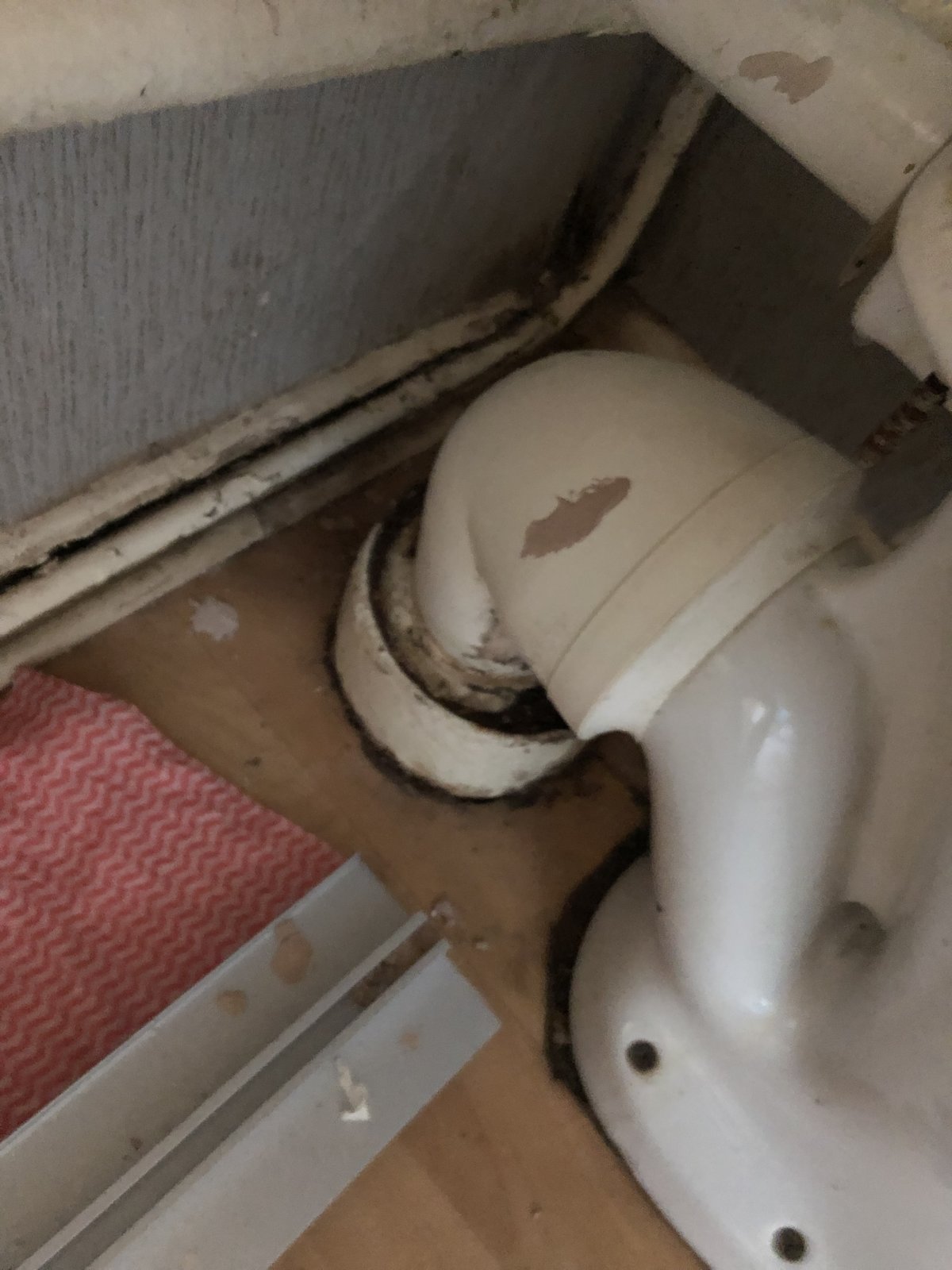

I’ve recently moved into my new house and currently renovating the bathroom, previously there was a wall separating the bathroom and WC. I’m only looking for a quick solution so could I remove the current toilet and replace with a close coupled toilet connector with a flexi pan connector, then box in behind so it fits to the wall. As the waste is in the floor im thinking this will be the best method. Would this be do’able? Or should I use a swan neck connector? By no means am I a plumber but I think I could do this as I’ve replaced and moved the radiator to another location and fitted a new basin and shower downstairs.
measure the distance from the centre of the soil pipe in the floor to the wall. You can actually still get a small number of bottom-outlet pans that will fit without needing an adaptor.
Mine was about ten inches and I found a Twyford E100 to fit, it's good quality with an effective flush. Many modern foreign imports with a low water volume flush are ineffective at clearing the pan.
Mine came from
https://www.qssupplies.co.uk/bathroom-furniture-shower-taps/13180.htm
and they now have the Alcona (version in top right diagram) for eight-inch spacing.
but there are a few others
You have to be careful to specify the bottom-outlet pan as the horizontal outlet is more usual and often cheaper
if the soil pipe rises out of a solid concrete floor it is a lot of work to move it. If a wooden floor that you can take up, much easier. Modern practice is to have a horizontal pipe so most pans have a horizontal outlet.
