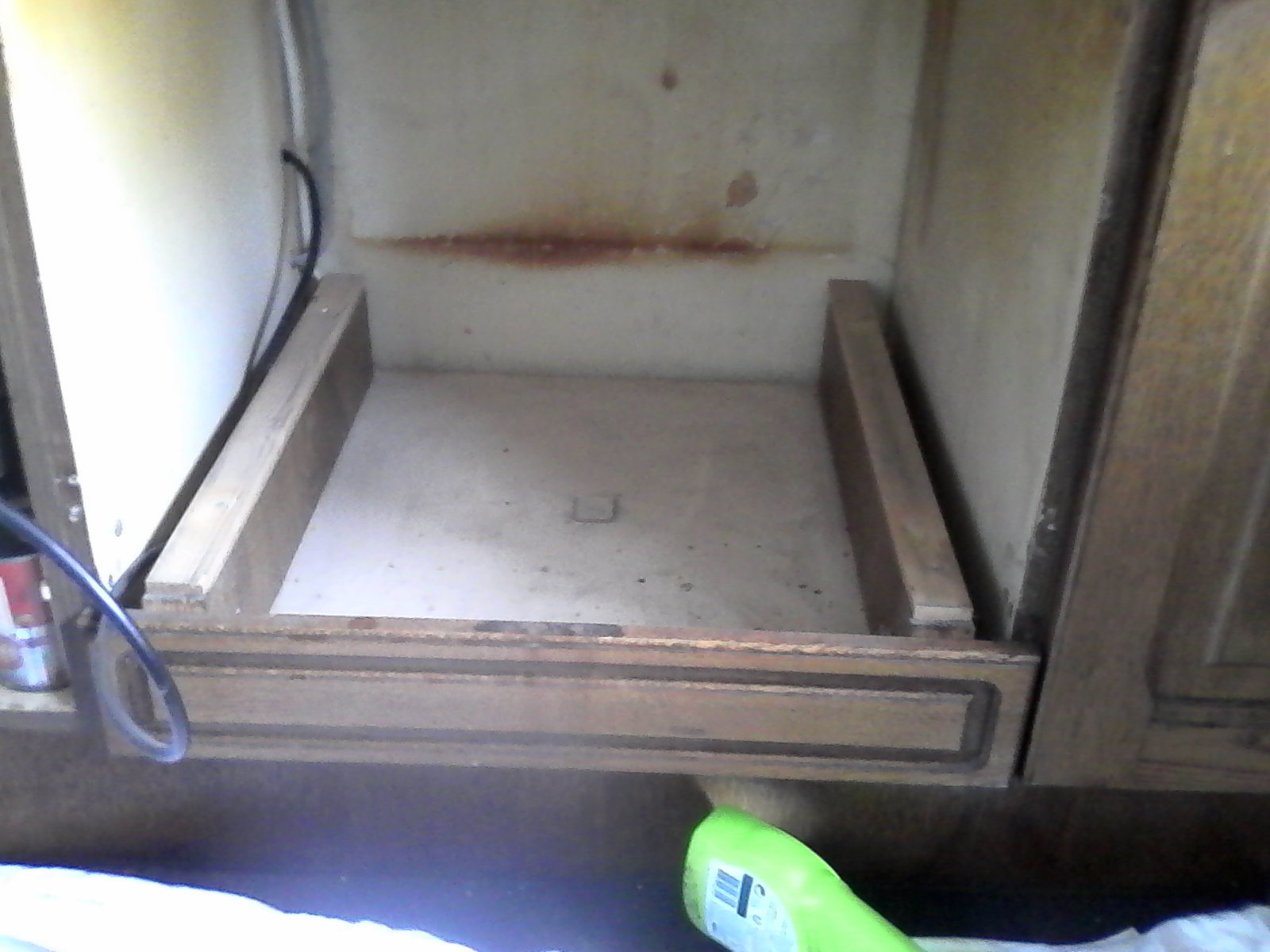

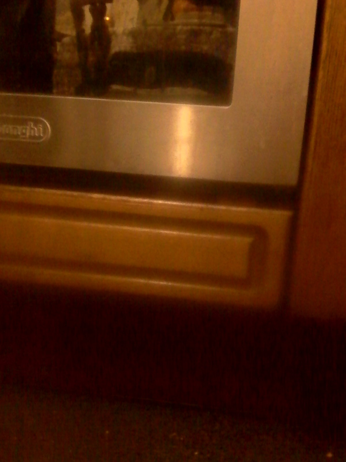

Ju st uploaded a pic. The small wooden panel under the oven covers two wood length of wood to support the oven, the ends are just visible in pic, in the gap between panel and bottom edge of oven door at each side.

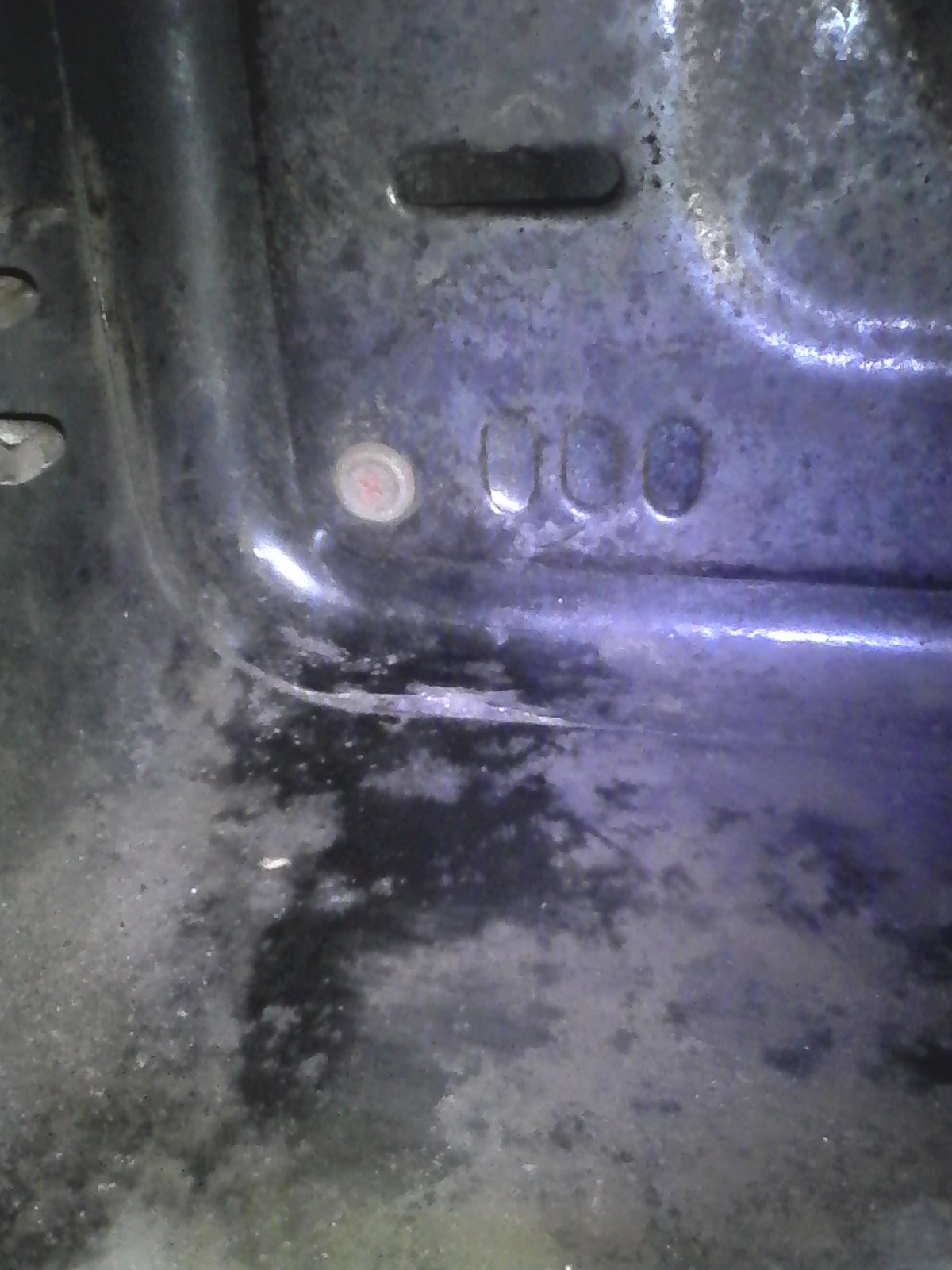

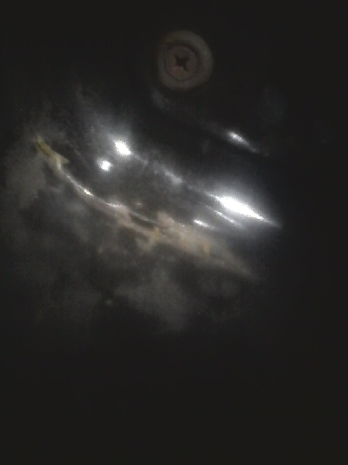

Second pic is corrosion inside oven on a seam at the bottom. Not sure if it is safe to use. I have poured a small amount of water on it and doesn't leak through

I can't make out what is happening in your pics. Stand back and take some wider shots. More light, or a flash, will help.
Looks like an oven in a housing ,plinth on the floor, and a panel above. Pretty standard set up for an under worktop set up .
Can't tell anything from second pic of inside oven.

Checked clearance for new oven and looks ok, cant find info on how the new oven rests on base though

The " cabinet" is a standard base unit ,not an oven housing. An oven housing would have a shelf for the oven to sit on. Yours has two pieces of wood, added to a standard base unit for the oven to sit on.
