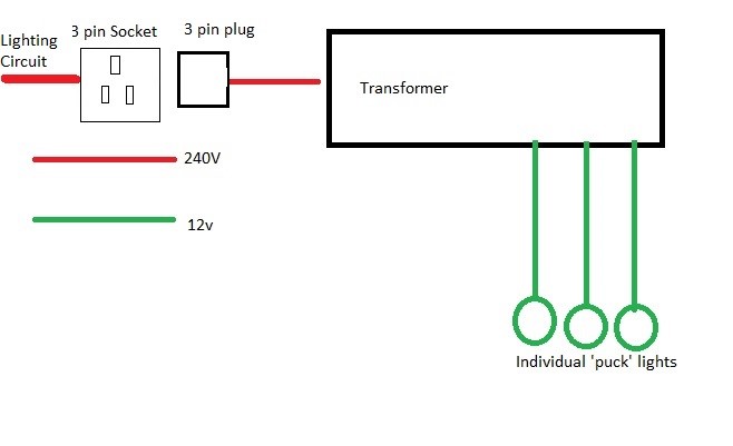

The transformer has a 3 pin plug - it isn't wired in (DIYer friendly I guess) - so the electricians put 3 pin sockets above the cupboards to plug them into. So I would cut the transformer off the lead with the 3 pin plug and connect the new driver to that lead...
Rubbish diagram to show the layout of one set of lights.

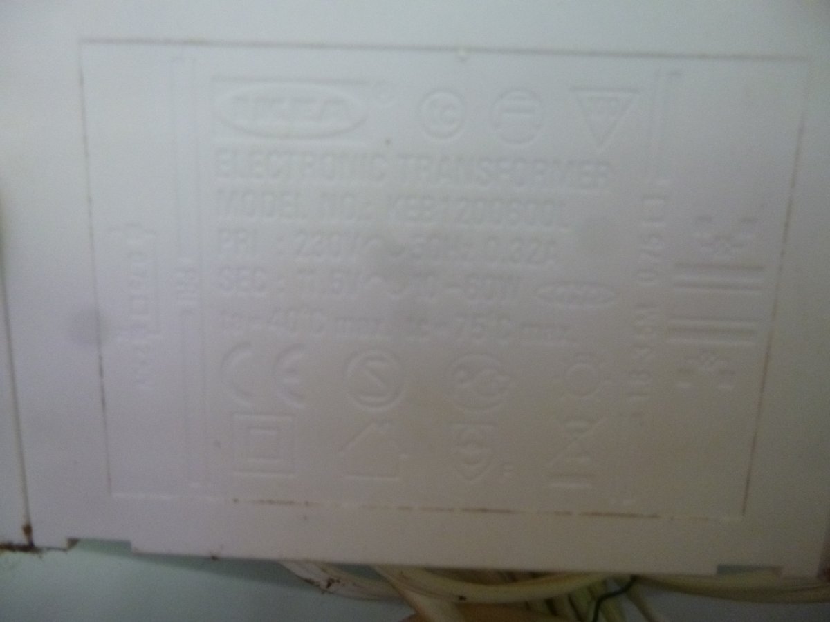

This is the info from back of transformer - it has a minimum of 10W so 3 x 1W LEDs is going to be below that (even 6 would be! -and yes I did clean the ccd sensor on the camera after taking that photo o_O)
No - they aren't plugs, you can't use them.
I think the problem is that with the reduced wattage the current transformer will run higher than 12v and burn the LEDs out?
No - some power supplies have a minimum load, and will be unreliable or will switch off if under-loaded.
